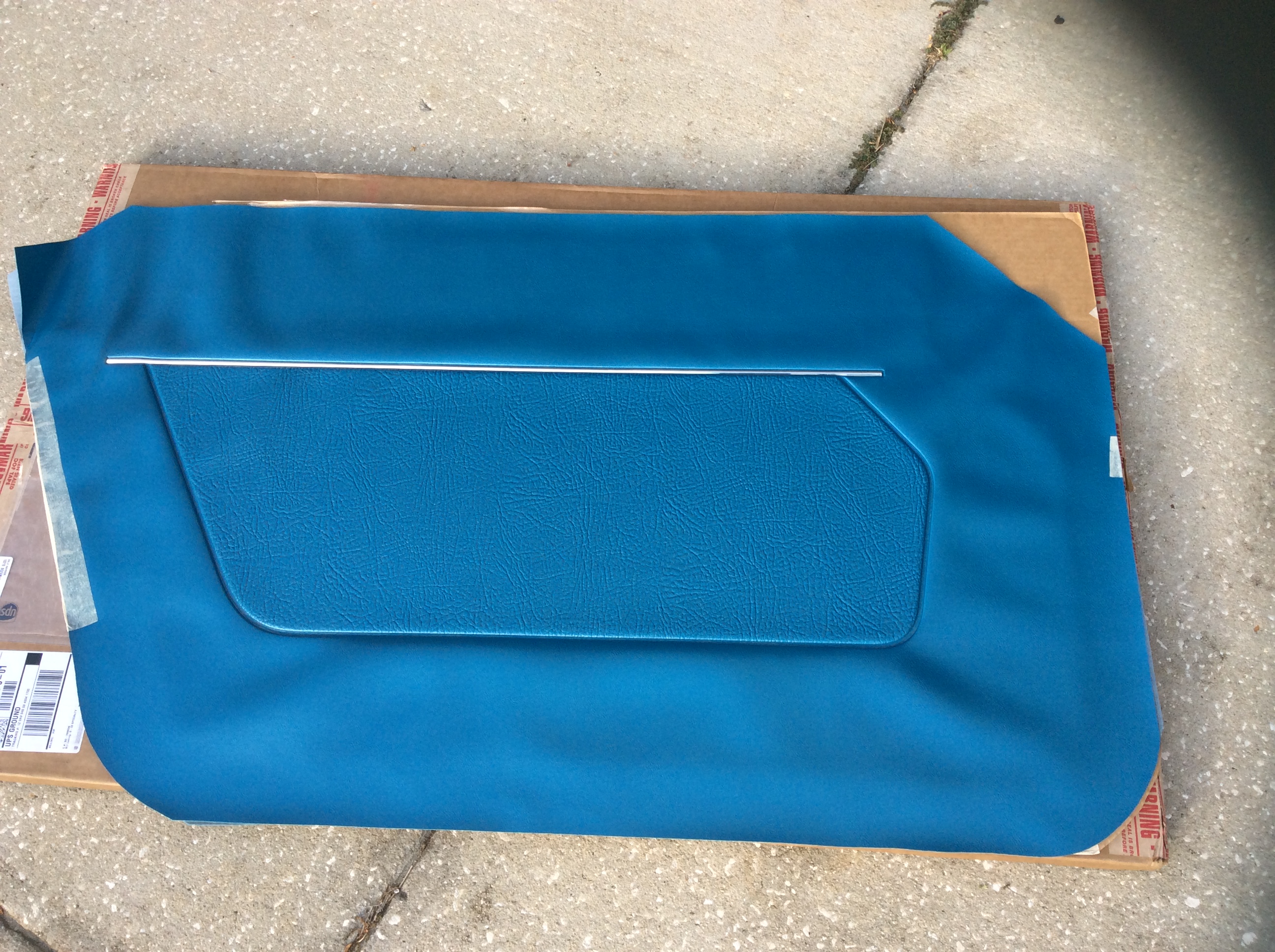

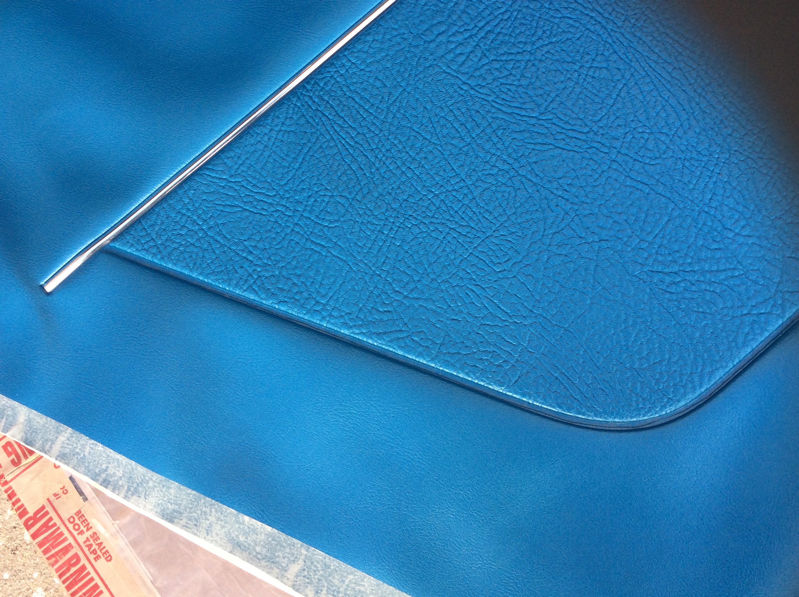

Just got a set of blue reproduction 240z door skins from www.roadsterwerx.com. Got them for a great price. According to their site, they were made by the same company that made them for the Nissan remanufacture program.
As you can see in the photos the color, textures, chrome strip, and heat sealed seams are identical to the OEM skins.
I can' wait to get them installed.
