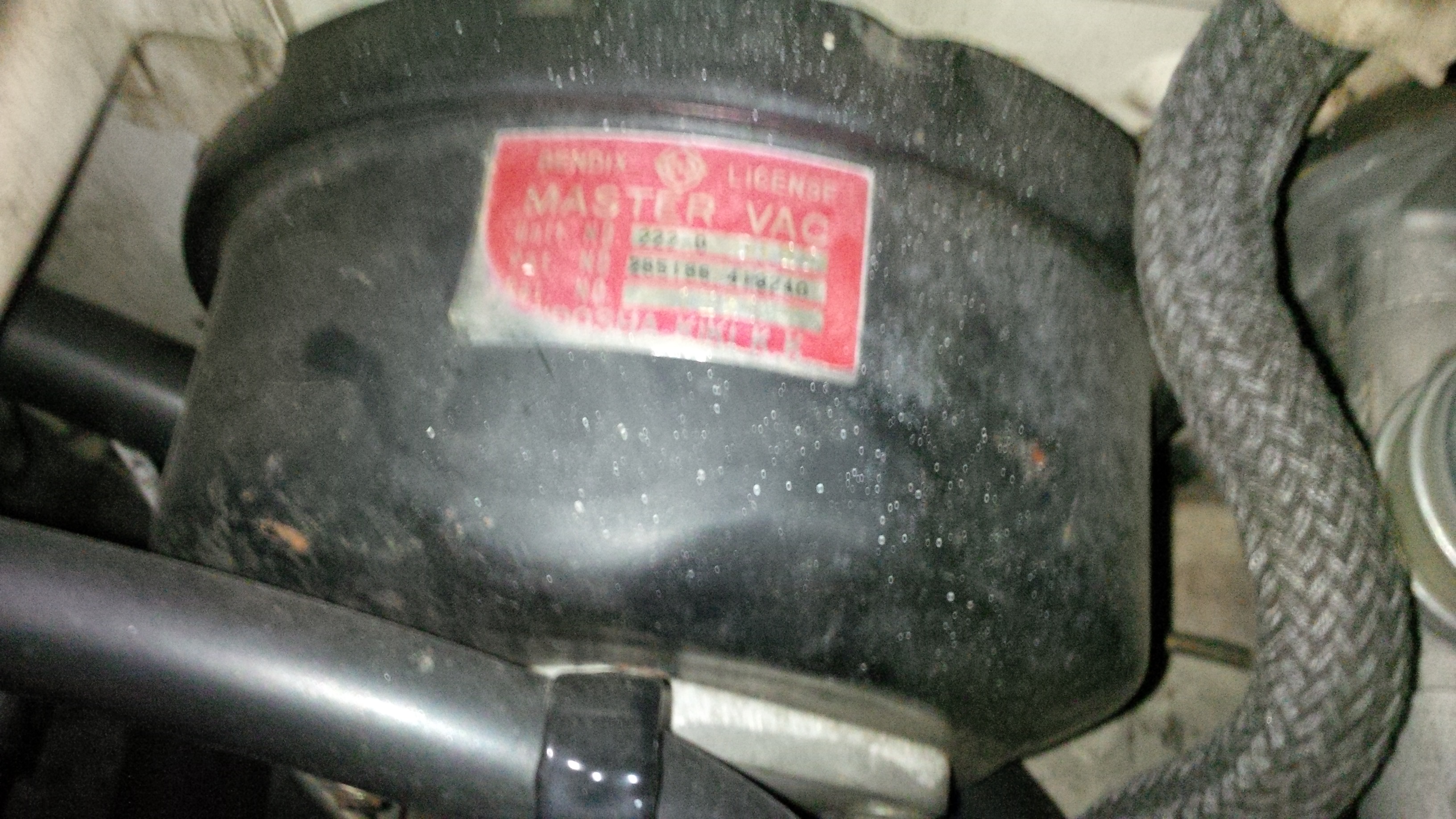

1. THe brake booster has some scratches on the paint. Do i need to sand all the paint and primer it back with semi gloss black paint with primer or Should i just sanded with 600 sandpaper where it is scratch and paint it only Which is the exact black color for this Master Vac?

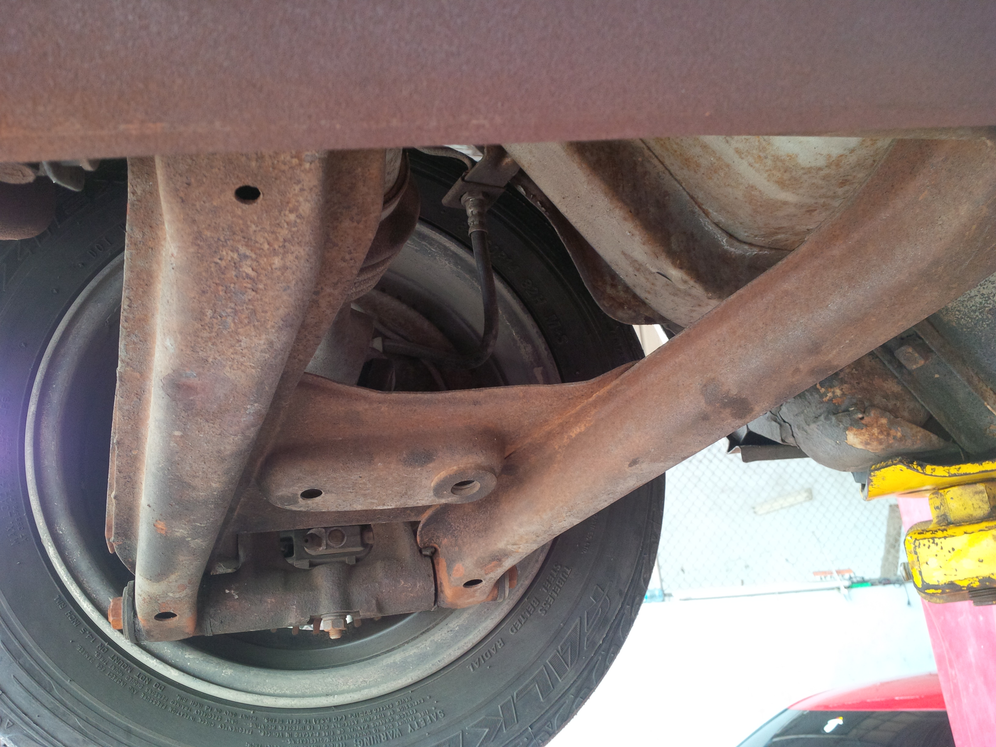

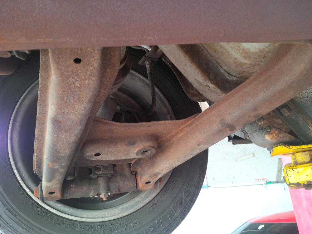

Am about to start the swap and will need your opinión if these parts or others should be replaced. I dont see any leaking anyway.
Anyone??
Nobody can give you good advice on how to paint your new booster unit.  They'd have to know what type of paint is on it now.
If it were mine, I'd just buy some black spray paint and spray away.  The booster doesn't get much abuse at all.  It will last a long time.  Black is black.
Anyone??

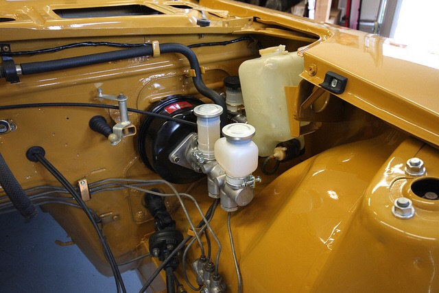

If it were me, I would sand it smooth with 400 grit sand paper......just to clean it up and break the surface. Go ahead and sand off or remove the red sticker. Mask it off and shoot it with a quality gloss or semi gloss black enamel.....light coats till fully covered. Then, order a brand new red sticker from Mike at Banzai Motors......it'll look like brand new!
when you mean break it up do you mean sanding it until you peel all the black paint leaving it on bare metal or to even the scratches on the paint?
No, just smooth the surface until the paint is dull......if the paint is still on, there's no need to use any primer......just spray over the old paint....simple as that.
