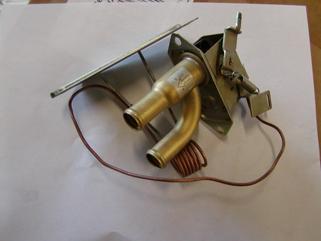

I can't remember for sure, but I think that if you remove the front panel/face plate over the heater controls you can easily see the levers and cables that move the various parts.  Might be easier than a mirror, although I do recommend the mirror also, I use one often.  Pull the rubber knobs off of the levers, remove the screws and pull the face plate off.  It's not super-difficult.
If you try the mirror, make sure you have a bright light.  Sit in the passenger seat and position the mirror and light and you might able to see if it's moving the watercock lever or not.  My car had a bent cable which wouldn't push, and pushing is what shuts the watercock.
You'll probably use the mirror and find that the lever isn't moving, then take the face plate off and find a bent cable.
But Captain Obvious wrote up a whole thing on using Honda watercock valves in place of the expensive Nissan valves, if you find that the lever is moving but the water flow isn't controlled.
Here's what you'll be looking at.  The end of the lever where the cable attaches is at the upper right.
Thank you for giving me more information to use. Especially the photo. I have my next 2 days full, so probably will not be able to look at the heater and the connections until Saturday. But I will indeed do as you, and the others suggest, just as soon as I can.
