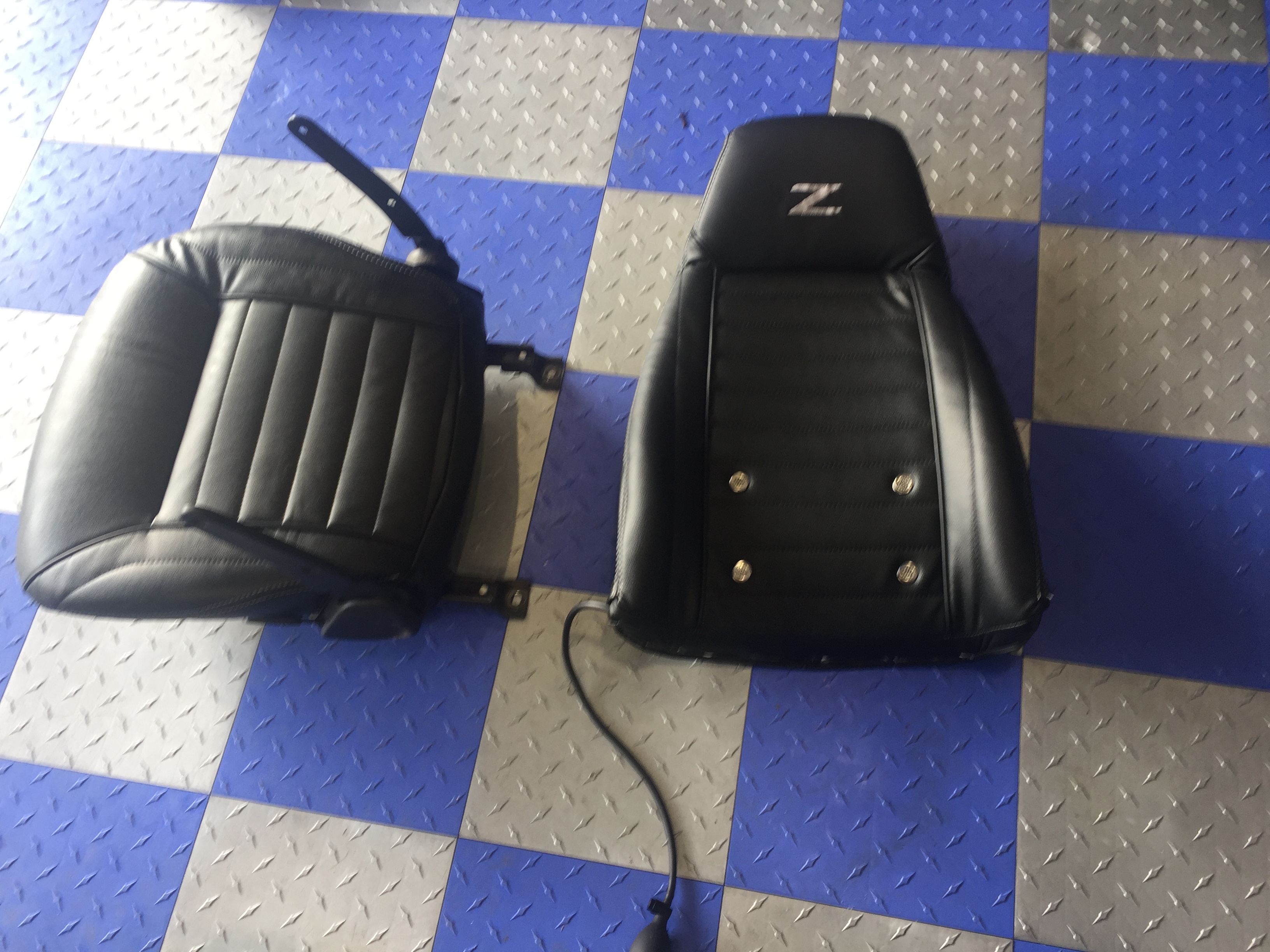

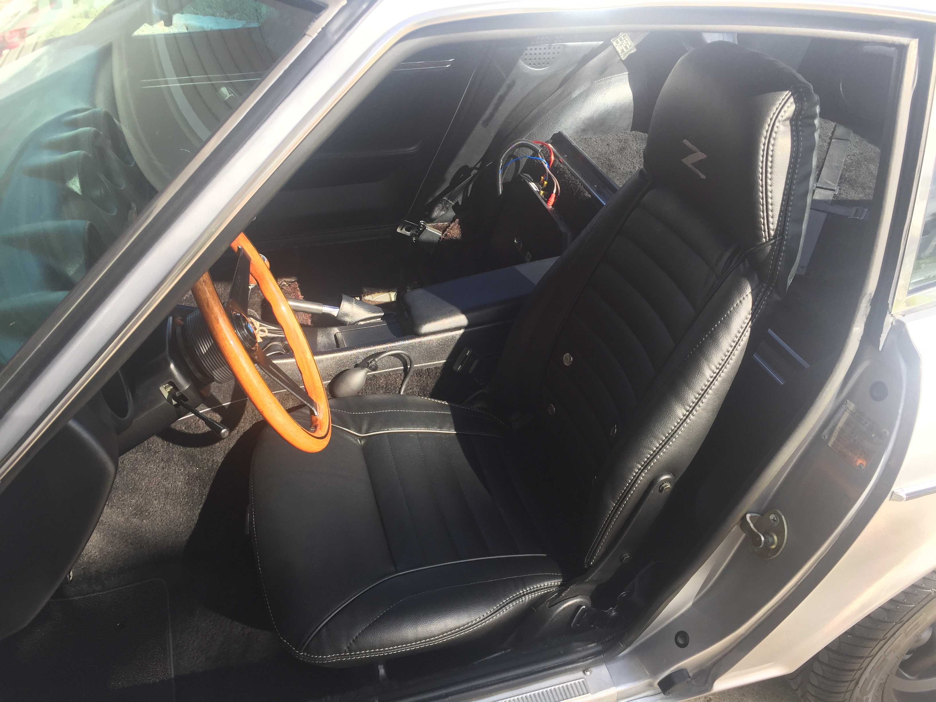

ordered these seat covers from interior innovations last sunday. showed up today. my first impression is very good, but i will follow up when i get them installed. it is amazing to me that i can order a part, it gets delivered to my door from halfway around the world, nice quality, but it takes twice as long to get something from somewhere i can drive to in a day.
I also ordered some seat covers and they came from Pakistan.  I was amazed when they showed up in like 4-5 days.  The ad on EBay said they would do different color stitching, the picture in the advertisement had gold.  In the comment section I asked if I could get silver.  I got no response so my expectations that they would come in w/silver stitching was very low but they did.  I'm very happy with them!  I also stitched in an inflatable lumbar "bag" that I purchased through MSA, I'm glad I did it!
