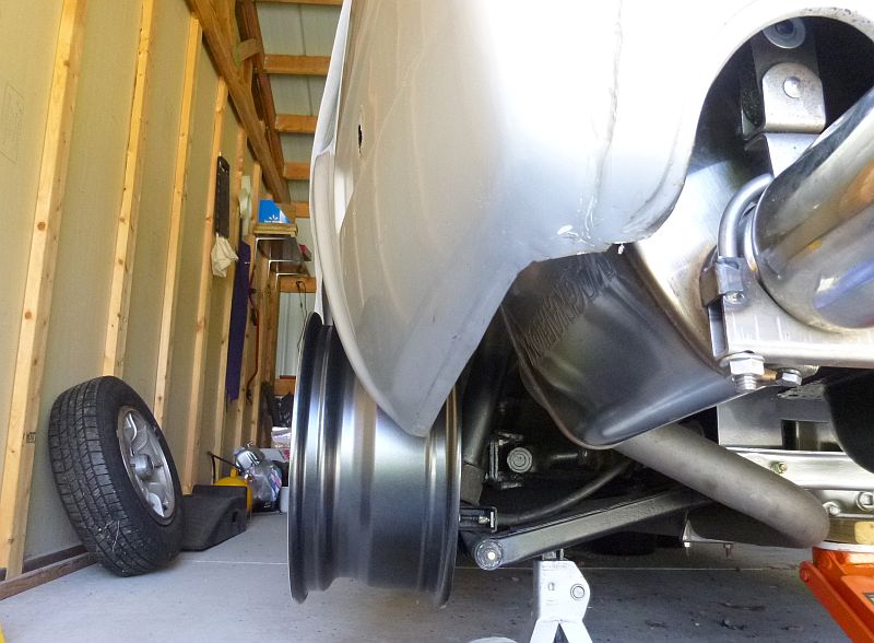

I put the oval stainless Magnaflow on mine last year. Tight fit but I
really like the sound. No pre muffler needed. I need to do some
work to get it tucked up inside more.
