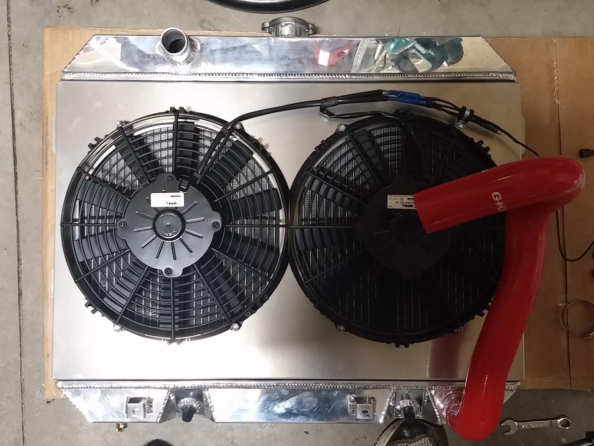

Did some wiring
post-30354-0-93266000-1443798374_thumb.j
Fits nicely now. Still quite a bit room left

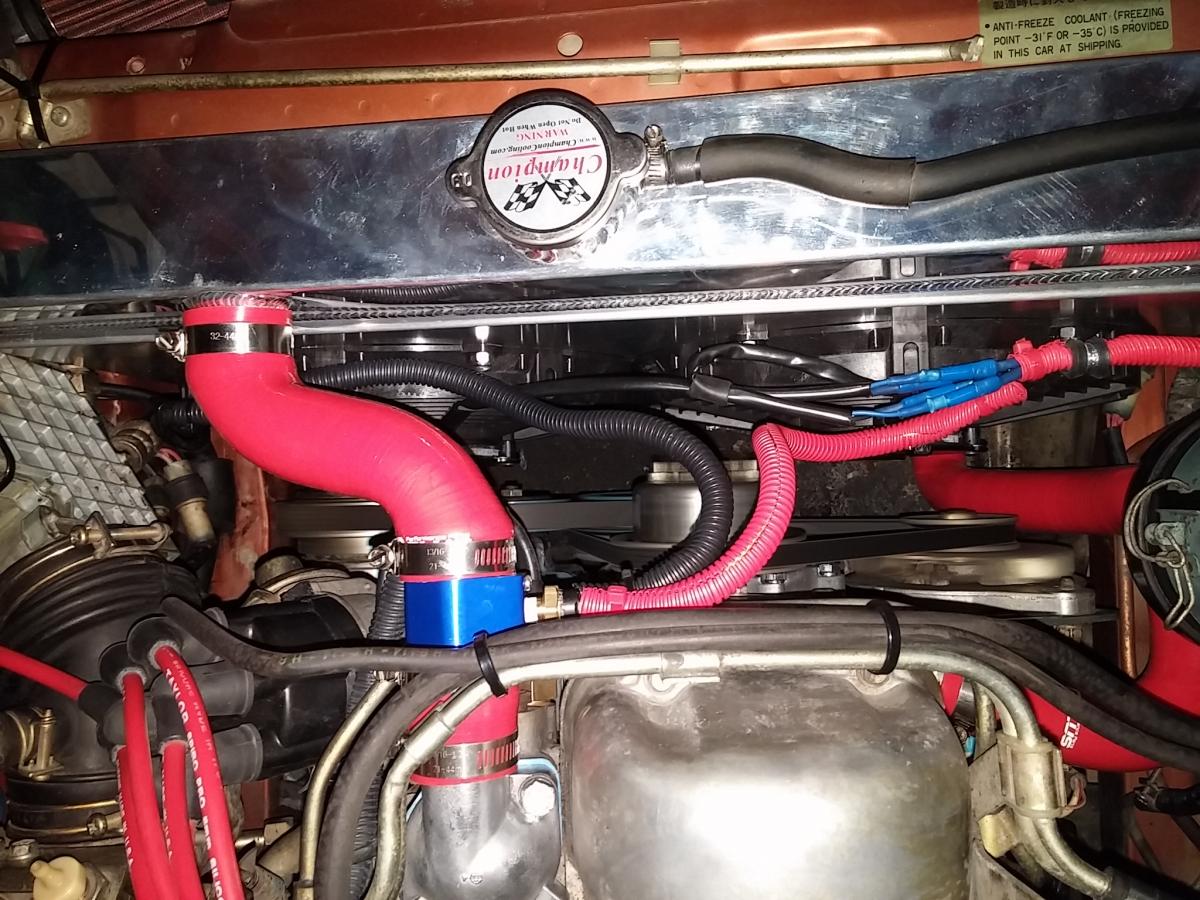

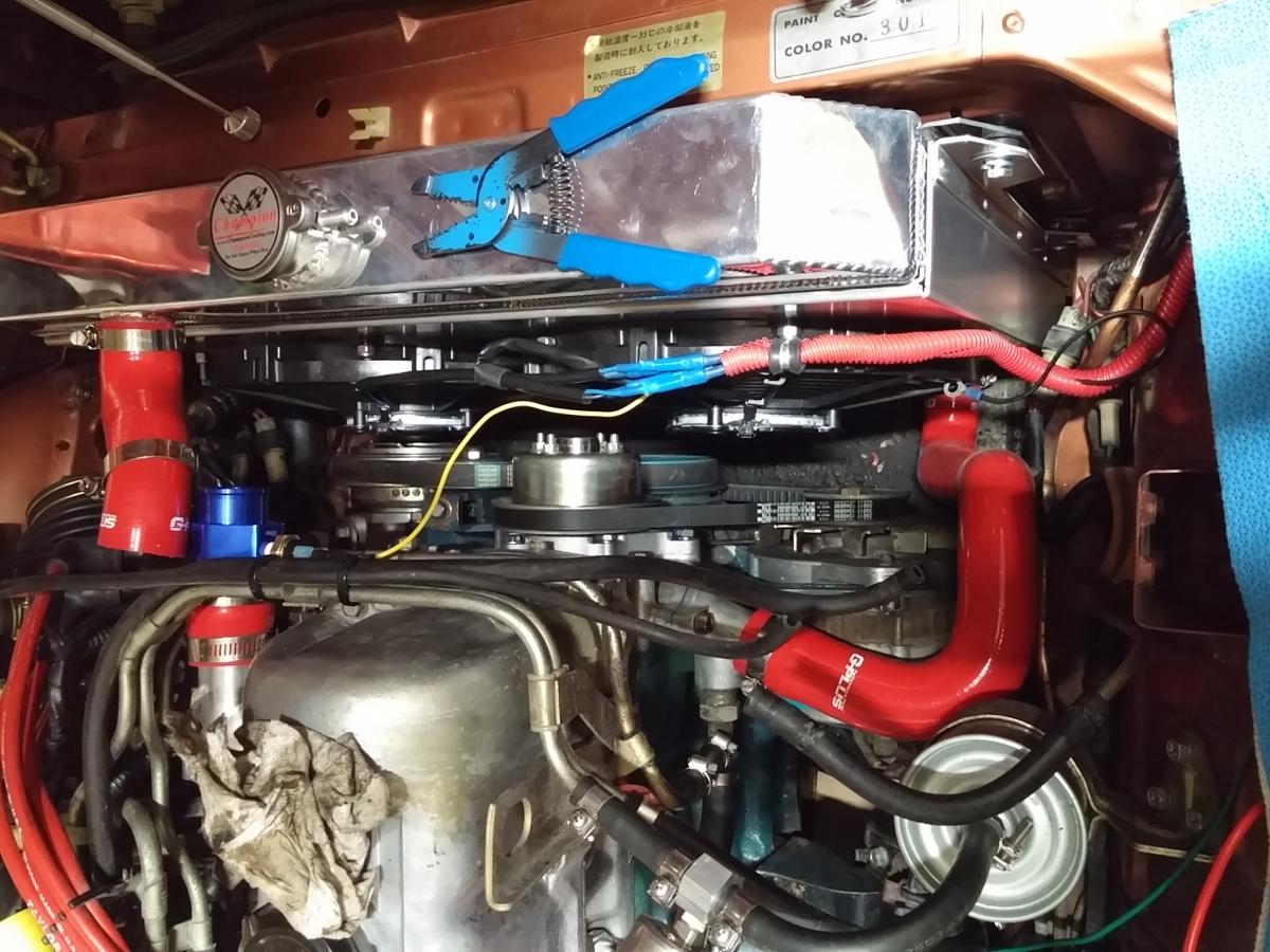

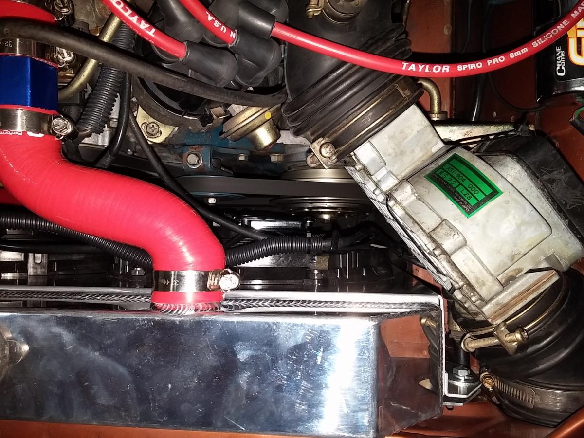

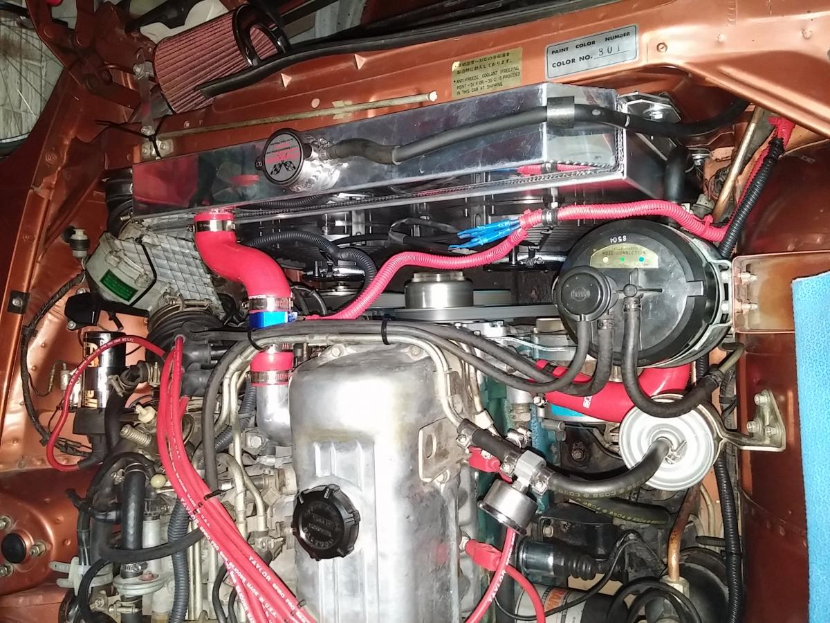

Well folks, it has happened.At autocross this morning. It was only 8pm last night when I filled the rad with coolant.Here is the final productpost-30354-0-66841400-1443975573_thumb.j
post-30354-0-14914100-1443975516_thumb.j
post-30354-0-00996500-1443975593_thumb.j
And here she is this morning
post-30354-0-88970200-1443975671_thumb.j
Still few small things left to do but I will write about it later.Time to race...
