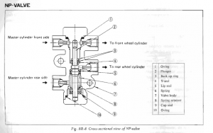

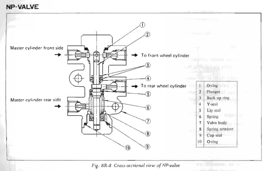

I'll try that. I'm not familiar with speed bleeders. You make it sound like a check valve. How do they work and where did you get them? My 71 is somewhat different from the 76 NP valve shown in the diagram. From the master cylinder the front and rear lines go into a pressure equalization switch and from there a line goes to the proportioning valve located above the right rear axle. It's that valve that I think is causing the problem.

Here's a pretty good thread on the NP valve.  Post a thread with "NP Valve" in the title and you'd probably get some more ideas.

You may be right on track with a suspect proportioning valve.  Mine was frozen and prevented fluid from reaching the rear brakes.  All became better when I replaced it with one from a friend's parts car.
If the master cylinder and rear wheel cylinders pistons were frozen then your NP valve is most likely full of gunk and could even be seized marginally operating.
My brakes worked find and just passed a roadworthy test when I replaced the MC and the wheel cylinders. I cleaned the NP valve and the switch. They were both full of sediment and sludge, but cleaned up ok and thats a couple of years back and no problems since.
