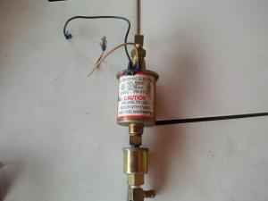

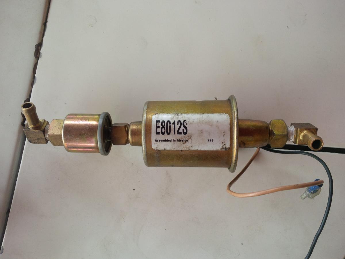

Will Airtex model E8012S which is 5 to 9 psi too much for both Hitachi SU CARBS? Is there any risk using this electric fuel pump? I just want to test if i am not getting enough pressure with the Carter P60504 fuel pump!
post-28721-0-42985200-1433968121_thumb.j
post-28721-0-98933800-1433968132_thumb.j
If that Airtex pump is truly 5psi at the low end then it will probably be too much without a regulator of some sort.  The Carter P60504 puts out more than 3psi, I know, I have one and it is connected to a regulator and gauge.  It can easily go to 5psi if you crank it up but the spec sheet says 4psi max.
Patcon is right, SU's like around 3.5psi which where I keep mine.  If you are getting less than 3psi make sure your fuel lines are clean, no rubber hoses are kinked, and your fuel filter is clean.  If all of that is up to snuff check your voltage at your pump, you may not be getting a full 12v.  If that looks good then you can try the Airtex pump but be prepared to see fuel pouring out of the front of the carb.
