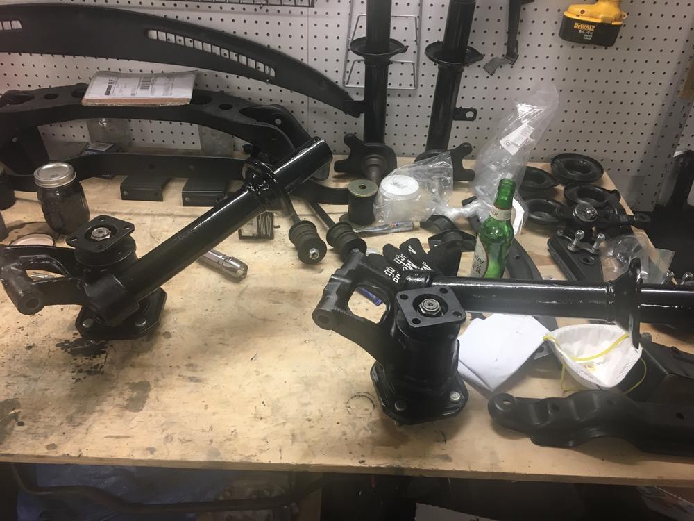

So the local shop that pressed my rear hubs together messed something up and I had to take them back. Not only do I have to replace the bearings, they tried to grind the spacer to make it shorter. Anyone have one I can buy?
  • 1 month later...
Back on track thanks to Captain Obvious and his buddy Gary.
Thanks Bruce!
We identified the problem(s). They had pressed the inner bearing in at an angle and then forced it down. This did some gnarly but repairable damage to the inside of the hub and is why the bearing was uneven and destroyed.
They also screwed up my spindle pins and all the hardware that went with them. I have new hardware on the way.
The spacers Jim K sent me were perfect and went right in. Everything is now back together (minus the drum brake backing plates) and ready to continue, but first I’m cleaning up my paint.

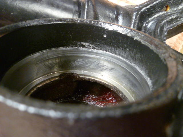

So to provide a little more info about Matthew's bearings... The shop that had previously worked on the car really screwed things up.
They had forced the spindle pin tapered retainer pins into place without having the spindle pin located properly. This not only ruined the taper pin, but raised a huge burr on the (brand new) spindle pin and we had to use the hydraulic press just to get the spindle pin out.
And the problem that Matthew originally noticed when he got the parts back from the shop was that the stub axle didn't spin freely, and had significant tight and loose spots when it spun. We traced this issue to a huge burr kicked up inside the strut housing on the bearing surface from them pressing the bearing in cockked at an angle. In other words... It wasn't straight, wouldn't go in, and they just kept applying more force instead of stopping to figure out what the problem was.
We dressed the upset material (high spots) off the inside of the strut housing and cleaned and inspected everything to make sure there weren't any other surprises. Once the burrs were removed, the new bearings went in fine and everything spun perfect.  We dressed the burrs off the spindle pins, and after that, they went back into the housings OK as well.

Here's a pic of what happens when you try to press a bearing in at an angle. You can see the semi-circular mark  on the far side where they gouged the cylinder wall that is supposed to locate the bearing. That raised bump was pushing the bearing to one side and not letting it seat square.
I used a hand file to dress the high spots back level. This pic is about halfway done. I considered using a dremel with a small grinding wheel, but last thing I wanted to do was slip. It took way longer doing it by hand, but I wanted the control that I could not achieve with a power tool:
