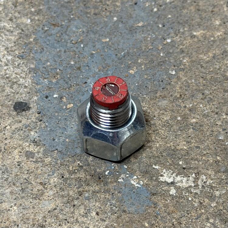

Apparently, when you use a stover nut on a Tokico Illumina shock and try to torque it to factory spec (70ft-pounds) it rips the top off and you spray shock oil everywhere. Then you get to panic race to get spring compressors on the spring before it shoots off the strut and kills you. It also kills the strut insulator and you get to figure out how you’re going to 1. find an Illumina to replace the one you just trashed, 2. figure out how you’re going to move the car on three wheels, and 3. wonder if you’ll be driving the car this year.
Edited by Matthew Abate
That sucks. I jacked the threads on one of my new Koni yellows when installing them in my car.
What Illumina inserts do you have in the car?
I think they’re BZ3015s in the front. I’ve been digging through my documentation and haven’t found the details. Of course I didn’t say in this thread, which was dumb. My Z Car Depot receipt just says “rear strut pair” so I’m not certain.
