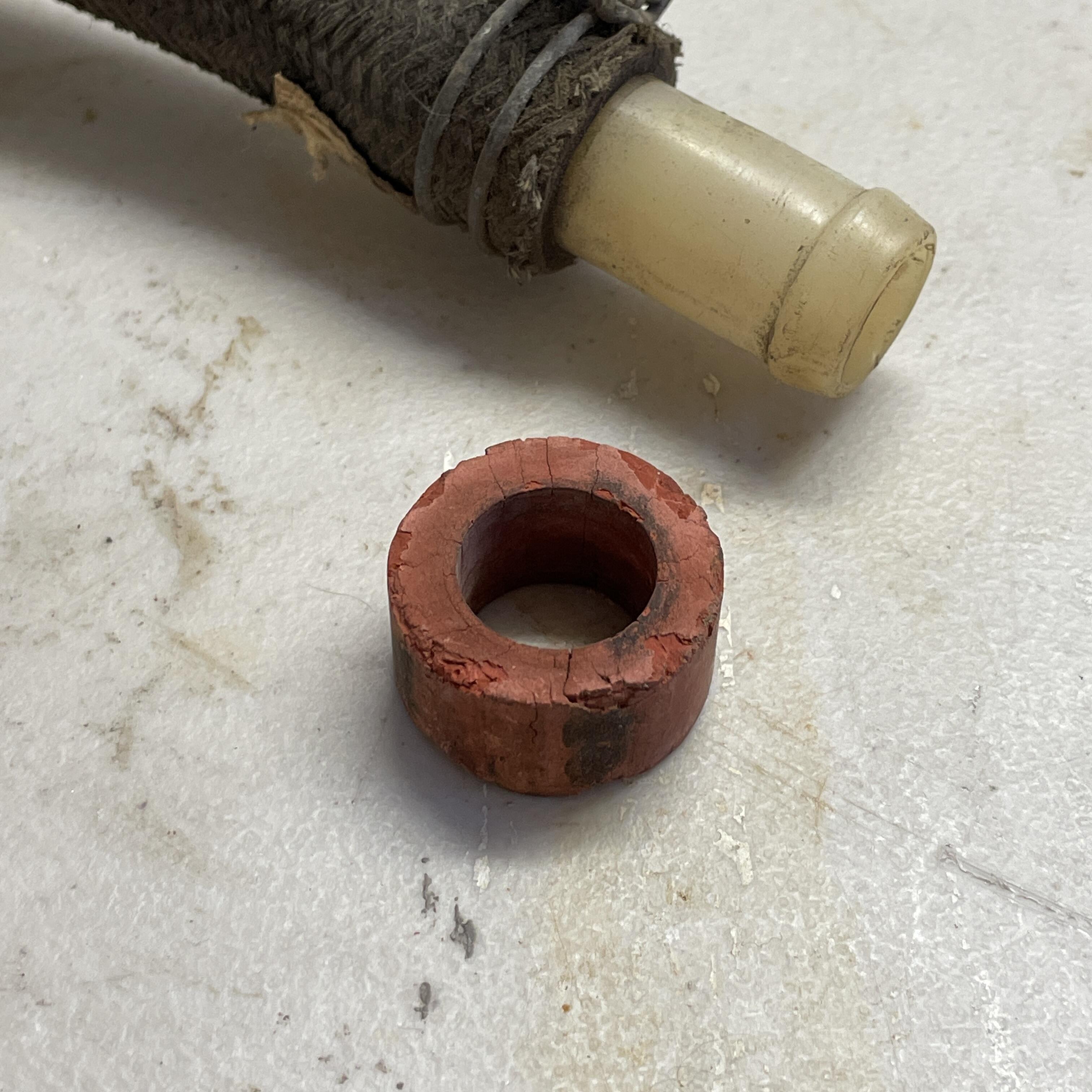

November 18, 20231 yr Author comment_659563 I found this red cylinder in the box with all of my old fuel hoses for the gas and vapor tanks. Anyone have any idea what this is? I don’t see it in the exploded diagram and a search yielded zilch. Is this just some random object the previous owner put in the box mistakenly, or is this some mystery part that I should replicate? (17mm hose with plastic barb for size reference) Link to comment https://www.classiczcars.com/forums/topic/51541-1973-rebuild/?&page=99#findComment-659563 Share on other sites More sharing options...
November 18, 20231 yr comment_659565 Brake booster check valve isolatior? Link to comment https://www.classiczcars.com/forums/topic/51541-1973-rebuild/?&page=99#findComment-659565 Share on other sites More sharing options...
November 19, 20231 yr Author comment_659567 I will check that out and see if it fits. The interior diameter looks a little big compared to your photo, though. Speaking of check valves, one of the fuel hoses has one but I don’t see it in the diagram and it’s not listed in the parts for the fuel tank assembly. I am assuming it goes from the tank to the vapor canister and is supposed to prevent backflow but I’m not confident in that assumption. Any ideas? Any good places I might want to add an additional one? Edited November 19, 20231 yr by Matthew Abate Link to comment https://www.classiczcars.com/forums/topic/51541-1973-rebuild/?&page=99#findComment-659567 Share on other sites More sharing options...
November 19, 20231 yr comment_659572 Make sure the check valve arrow is pointing to the booster, Not the vacuum source! Ask me how I know!! Link to comment https://www.classiczcars.com/forums/topic/51541-1973-rebuild/?&page=99#findComment-659572 Share on other sites More sharing options...
