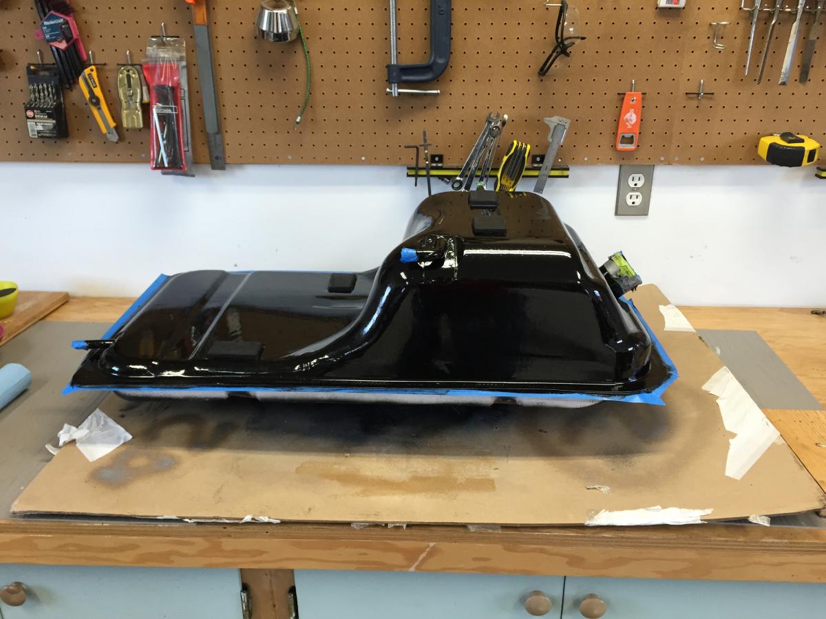

Posted May 12, 201510 yr comment_469644 So, I finished my gas tank referb with all new vent lines. I put 20 liters in it and drove to the gas station expecting to put in at least 40 more to fill to the 60 litre capacity, but it clicked off at around 32 liters. Hmm that's about 8 liters or 2 gallons short. Got in the car and the gauge doesn't quite go to full. So I did a search and found that I can probably get the tank fuller if I fill it slower towards the end. But then I looked at the gas tank and realized that to fill the tank some of the fuel would be sitting in the rubber filler neck. As long as my clamp is tight that shouldn't be a problem, but it seems like a poor design. Do you guys fill to the brim? Or leave a little space in the tank? Thanks. Steve Link to comment https://www.classiczcars.com/forums/topic/51472-dumb-gas-fill-question/ Share on other sites More sharing options...
