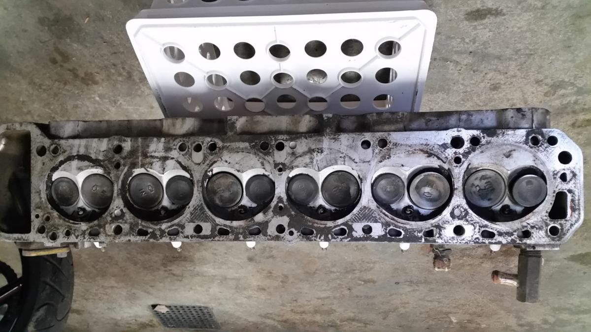

May 9, 201510 yr Author comment_469442 So it seems like I have a maximal N47 head. I brushed out the relieves. The block is stamped W24 Edited May 9, 201510 yr by Tomzern Link to comment https://www.classiczcars.com/forums/topic/51453-issues-swapping-e88-head-with-n47-head-l24-bottom/?&page=3#findComment-469442 Share on other sites More sharing options...

May 9, 201510 yr comment_469449 Thanks for those pictures Tomzern and site. Those are the first I've actually seen, and they do look like the way a factory would do it, crude but effective. My thorough side though, sees that one block is from Europe and the other from SE Asia. Tasmania. Australia. I wonder if the US models are the same. Curious enough to get me to remove a head some day if I ever find a Maxima in the wrecking yards. Those who think the Maxima head is of high value should read up on "quench". It's not a major power booster, and some people think that Nissan didn't get it quite right. The bigger valve is worth something for sure. The cam profile would be worth knowing too. I'm not sure the true added-value matches the mystique though. And there are some odd theories proposed out there about how smaller valves increase performance due to air flow velocity increase. Anyway, a person can't go wrong saving these old L engine parts either way. Link to comment https://www.classiczcars.com/forums/topic/51453-issues-swapping-e88-head-with-n47-head-l24-bottom/?&page=3#findComment-469449 Share on other sites More sharing options...
