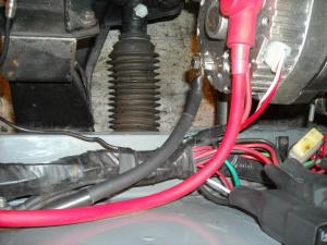

April 30, 201510 yr comment_468912 Grannyknot, I think you need bigger cables! Just kidding. I love the wiring in your engine bay. Bigger cables are good... Link to comment https://www.classiczcars.com/forums/topic/51403-q-alternator-ground-path/#findComment-468912 Share on other sites More sharing options...
