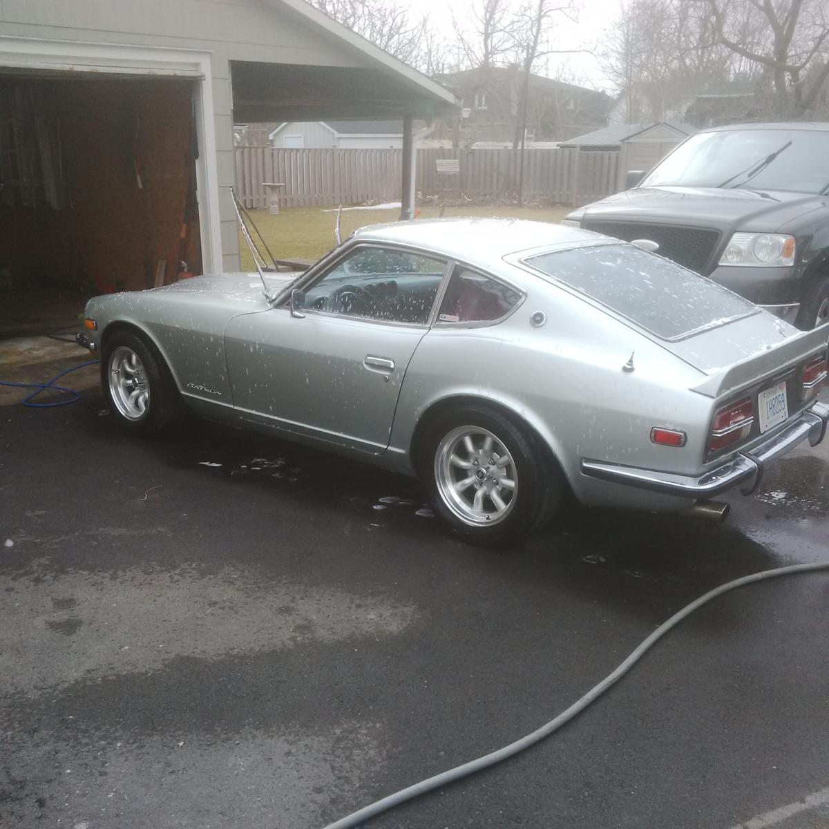

Posted April 27, 201510 yr comment_468643 Hi guys looking for help once again. I'm looking for new wheels and trying to get the right size tire. This is the look i'm going for, a 15" wheel with a little more meat than my 205/50's. Can anyone help my find out what size tire is on the beautiful 432? My guess is 225/50-15.... Link to comment https://www.classiczcars.com/forums/topic/51386-guess-what-tire-size-this-is/ Share on other sites More sharing options...
April 27, 201510 yr comment_468652 That is what is on mine 225/50 15" Toyo Proxe 4's Casey Link to comment https://www.classiczcars.com/forums/topic/51386-guess-what-tire-size-this-is/#findComment-468652 Share on other sites More sharing options...
April 27, 201510 yr comment_468676 Casey, thanks for not cluttering up that picture with any pretty wash girls. Just leave that wet zudzy stunning Z show off every inch of its perfection without any un-necessary distractions. Link to comment https://www.classiczcars.com/forums/topic/51386-guess-what-tire-size-this-is/#findComment-468676 Share on other sites More sharing options...
April 27, 201510 yr comment_468678 225/50-15 on mine too WRONG WRONG WRONG! 205/50s. Sorry. Edited April 27, 201510 yr by siteunseen Link to comment https://www.classiczcars.com/forums/topic/51386-guess-what-tire-size-this-is/#findComment-468678 Share on other sites More sharing options...

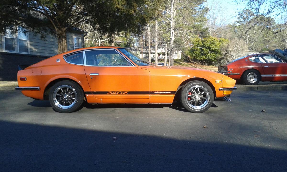

April 27, 201510 yr comment_468721 Funny you should ask! This is the exact combo of tire and wheels is on my bucket list. I also have an orange, totally stock,car and have been exploring a wheel and tire combo to compliment my 240z. I like the 14 x 7 & 14 x 7.5 Watanabewheels for the old school look, but finding tires that legally fit wheels that wide with stock dimensions of 195/70 x 14tires is impossible. On a totally stock suspended car, this is the only tire size that fills the wheel well, looks best, andfits without rub, in my opinion. Watanabe recommends their wheel size for an S30/240z as follows:(This information can be found on the follow Watanabe site listed under matching data. http://www.watanabe.com.au/ F: A 14-7.0 +3 offset & R: B 14-7.5 +1.5 offset So, now I am considering 15" Watanabe wheel as pictured by haZmatt with 205 / 60 x 15 tires and whose demensionsare almost exactly the same as the stock 240z wheel (195 / 70 x 14). 205 / 60 x 15 tires which can be legally mounted on7" & 7.5" wheels are, also, plentiful. Let me know what you think about my thoughts. Also, tire dimension comparisons can be easily made here: http://www.discounttire.com/dtcs/infoTireMath.dos Additionally, haZmatt, I do not know the tire size you have pictured so would not hazard a guess. Edited April 27, 201510 yr by AZ-240z Link to comment https://www.classiczcars.com/forums/topic/51386-guess-what-tire-size-this-is/#findComment-468721 Share on other sites More sharing options...
