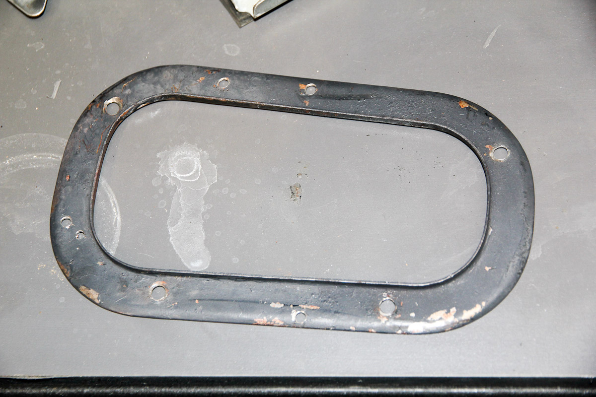

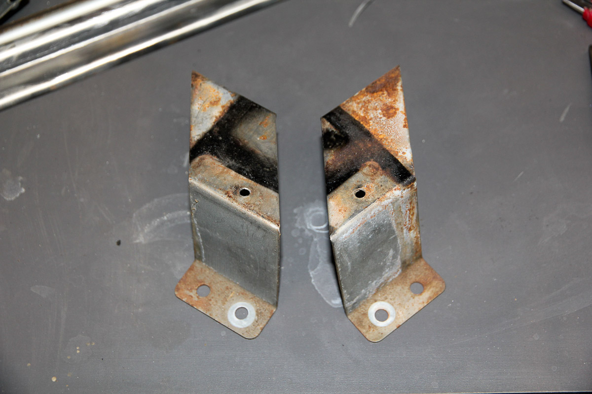

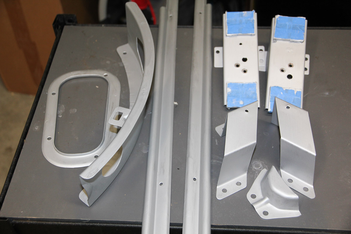

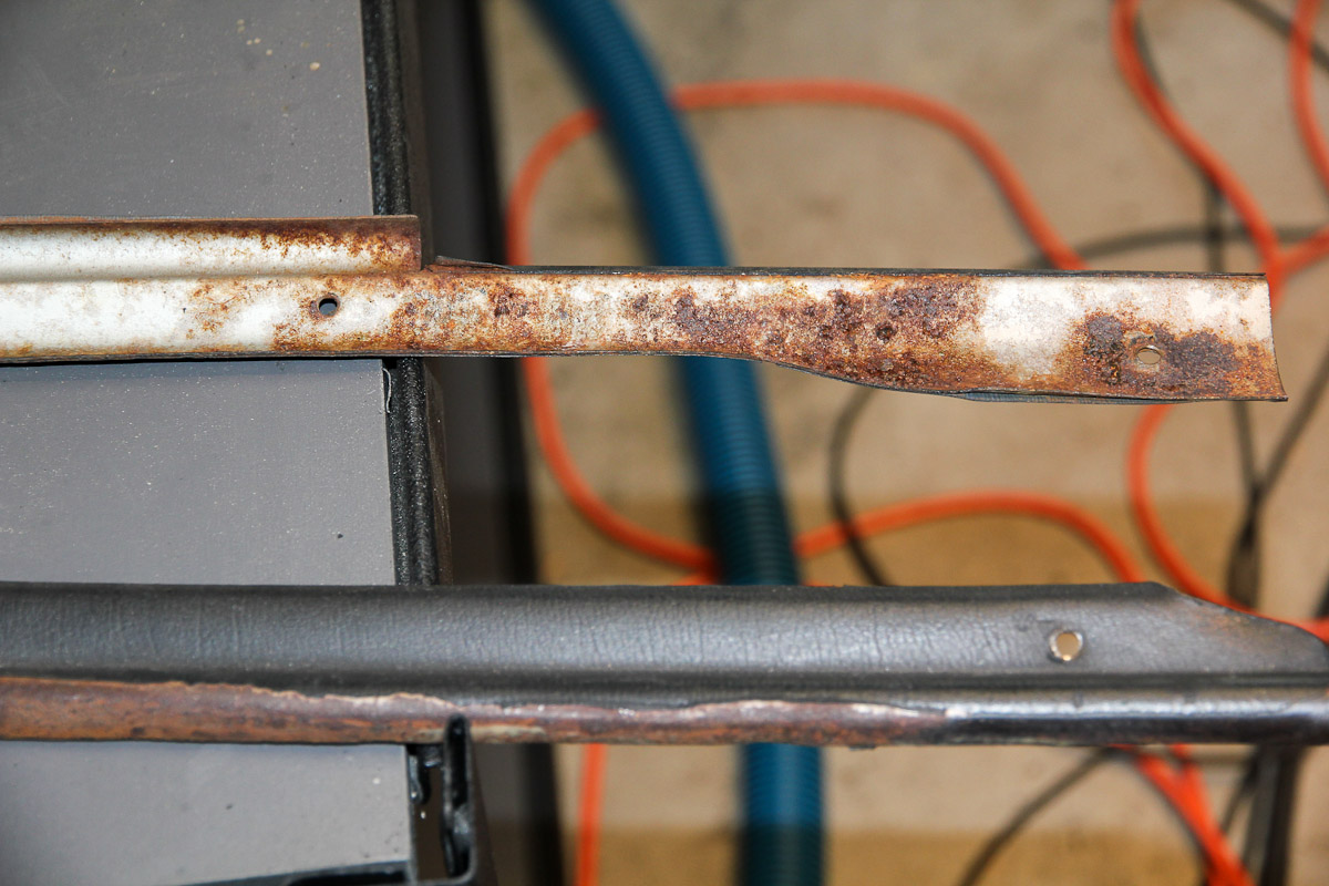

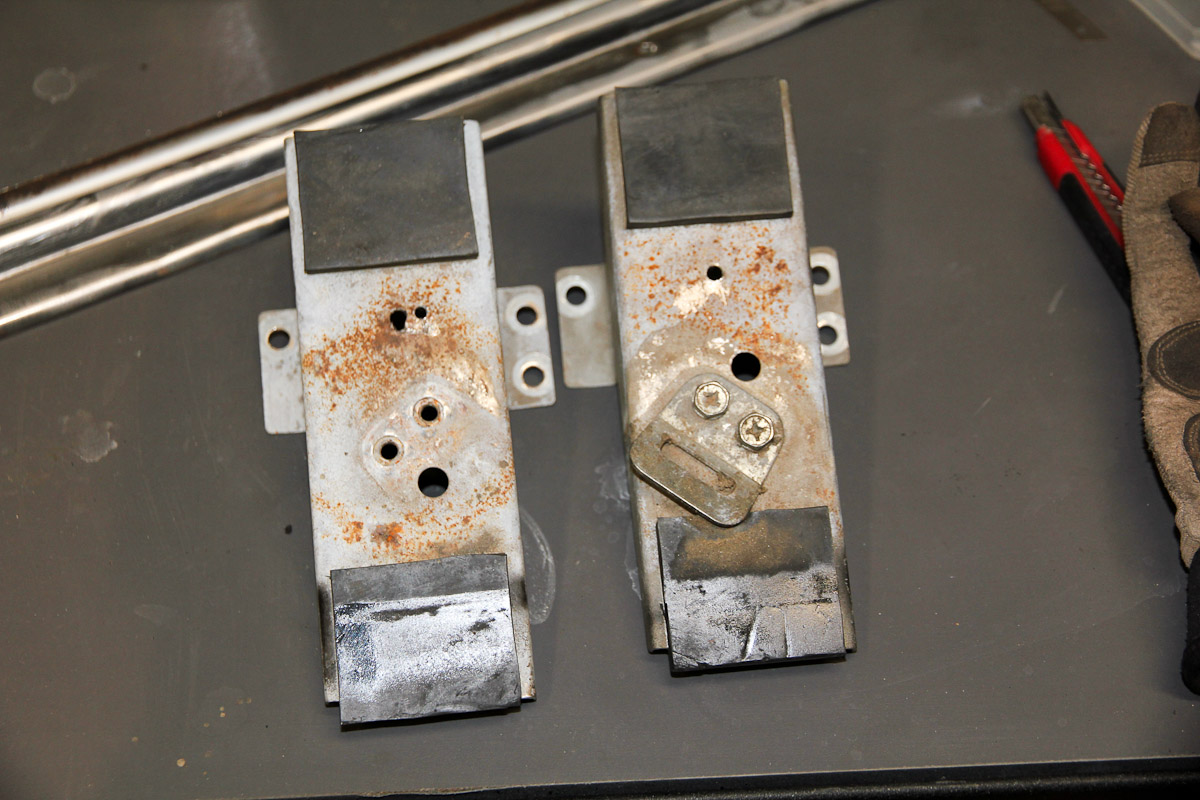

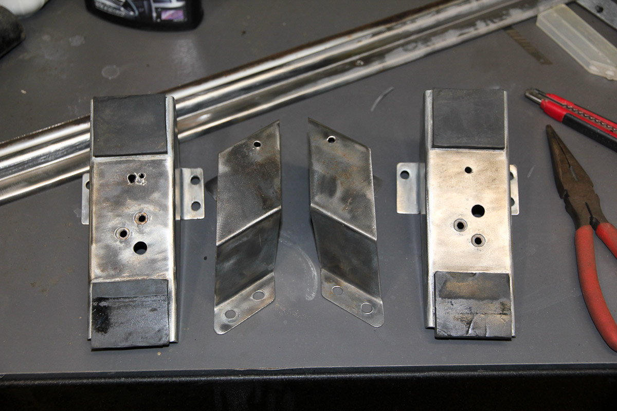

The scuff plates were in bad shape, so those were stripped (which took longer than I'd like to admit), hit with the wheel and knocked back into shape.  Since I was planning on going through the trouble of painting them, I figured I may as well do the same with some of the other bits and pieces that could benefit from some attention.  All were given a brushed-on coat of the MasterSeries silver paint.  Not exactly original, but better looking.

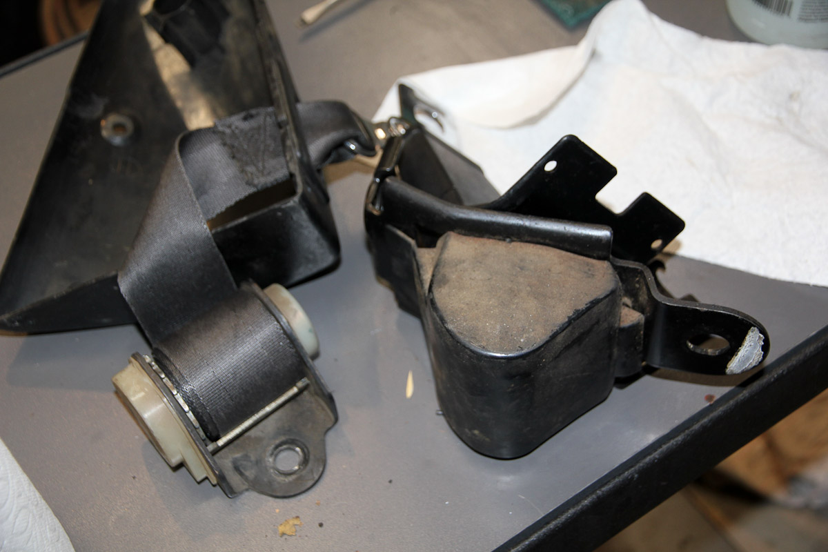

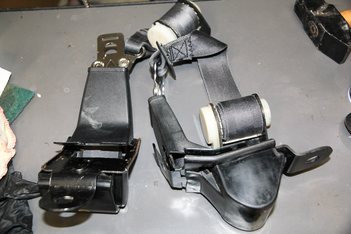

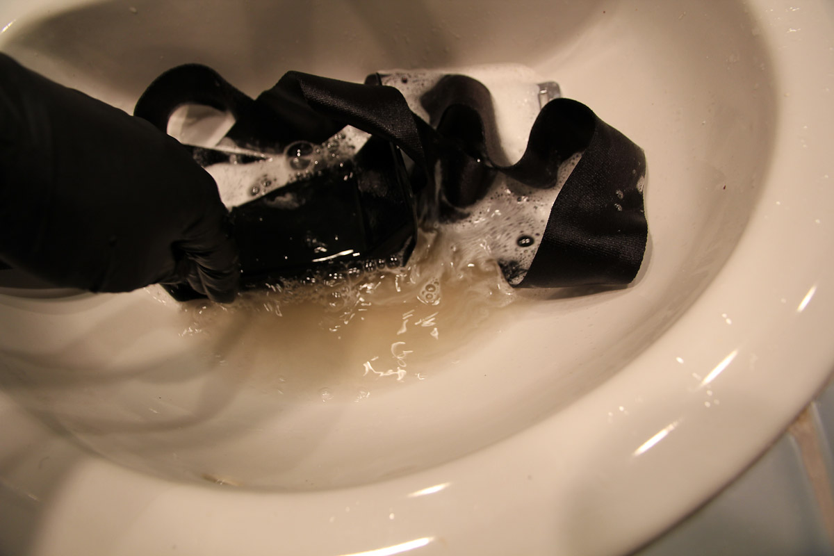

Also dealt with the seatbelts, which was a gag-worthy endeavor.  Delightful things found in the passenger seat belt included: a quarter, a nut shell, and chewed gum.  The belts were soaked in hot water with Oxy Clean, rinsed, hit on both sides with the steam cleaner, soaked again with Oxy Clean, then rinsed twice.  That nasty water was from the passenger side; the driver side was significantly worse!
IMG_3814.thumb.jpg.43ebcad9d30504dc85b7cIMG_3813.thumb.jpg.996dcf0ec96ae7055fab1IMG_3821.thumb.jpg.3064510e4ed9480533da9
It was well worth the effort, though.  They don't smell anymore, nor give me that vague "ewww....I need to shower" feeling whenever I have to handle them.  Only hiccup: I dropped it on the way out to the garage!

i went through the same drama with the scuff plates - took hours to get the nasty curled-up vinyl wrap off and wire wheel them down to clean metal. i tried to re-wrap with vinyl but couldn't get anything to stick well enough so i went with black epoxy paint and they've held up pretty well.
when i cleaned out my seat belts i found corroded coins, cigarette butts and several false fingernail tips (ewwww!) inside - they work better now...
Glad I'm not the only one that struggled with it!  I plan on re-wrapping them (or at least trying).  I grabbed two different vinyls at Joann and was able to find a retailer that shipped Weldwood HHR contact cement to me here in CA. If that doesn't work, black paint or bedliner it is.

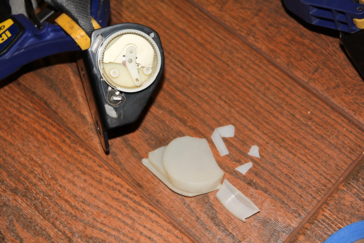

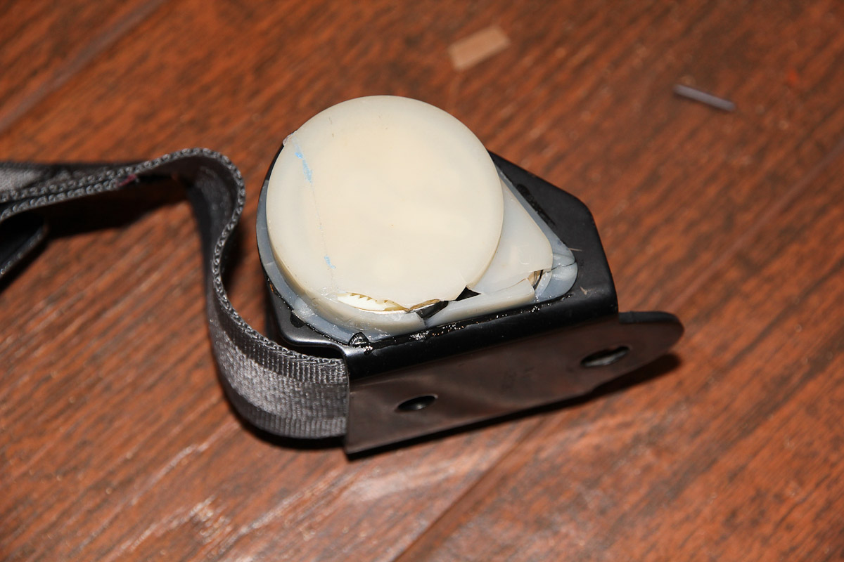

When I first got my car, my driver's side seat belt webbing was badly frayed. I have since replaced the whole assy with a donor in better condition and then took the old one apart to see what made it tick. With that in mind, I think I have a plastic side cover sitting in a box that I would be happy to donate to the cause if you're interested.
If so, shoot me a PM and we can chat.
