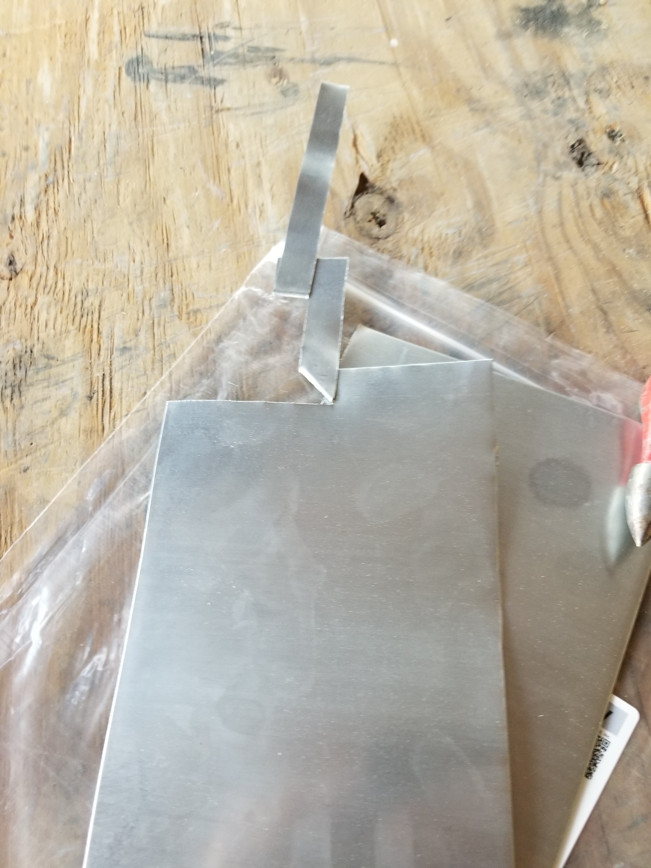

I found a source for zinc. I bought a 12x12 plate from Fisher Science. I cut it in half and made 2 large anodes.
I folded some tabs on the plate, but I beat them flat, which is a mistake. The zinc is so brittle the tabs will just crack off

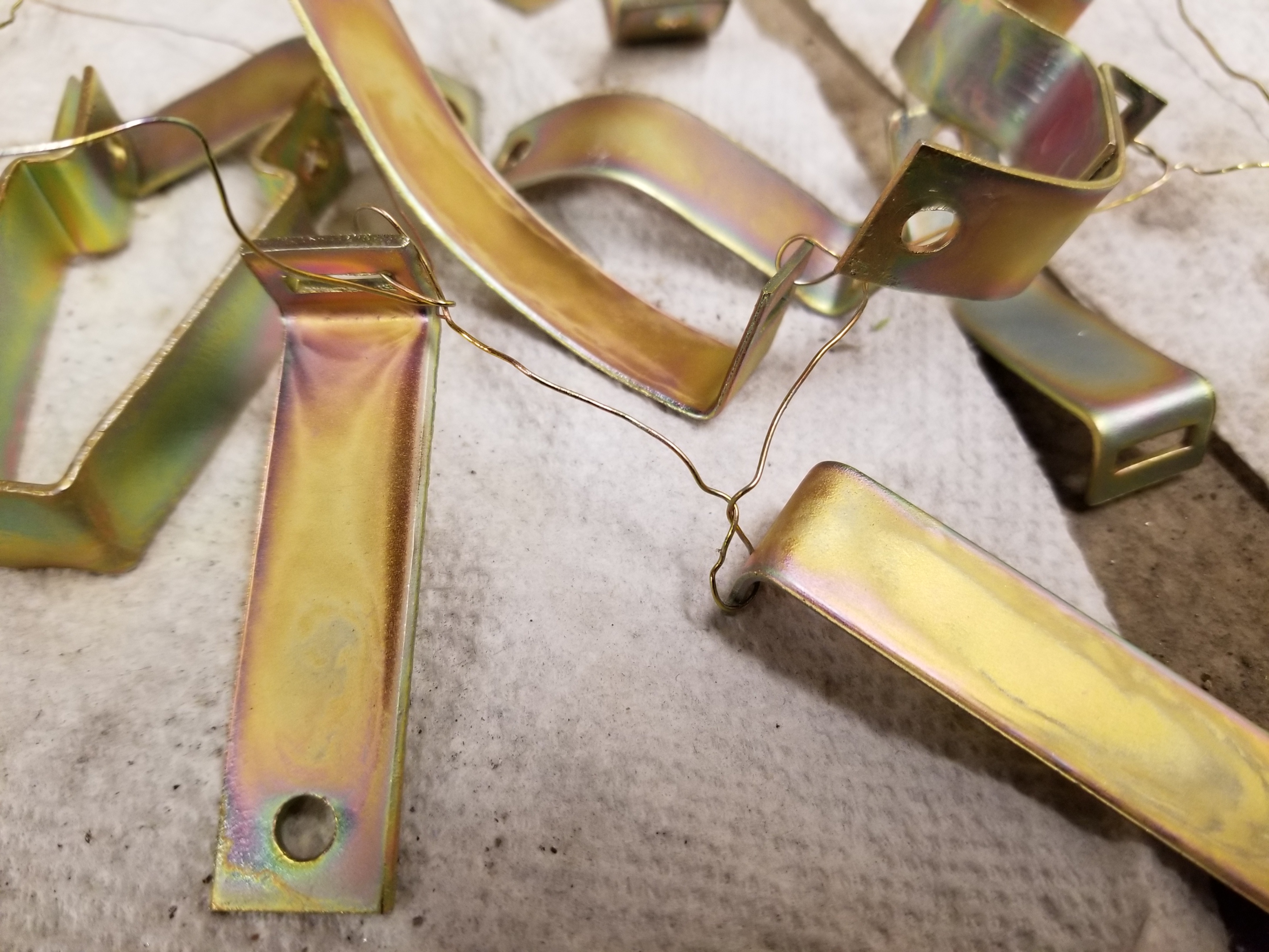

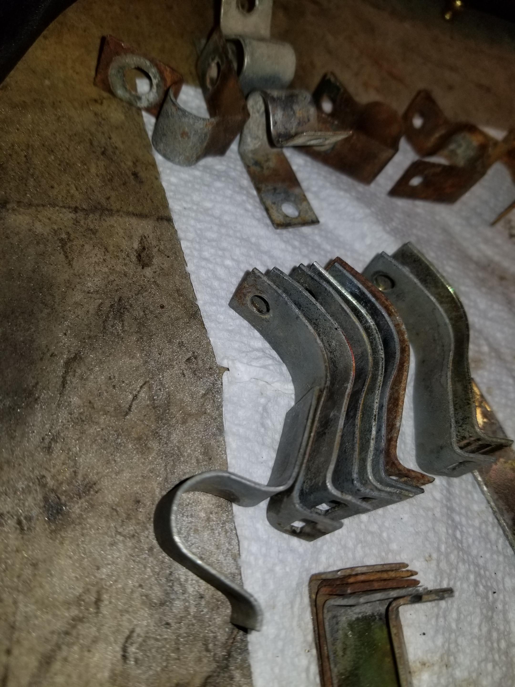

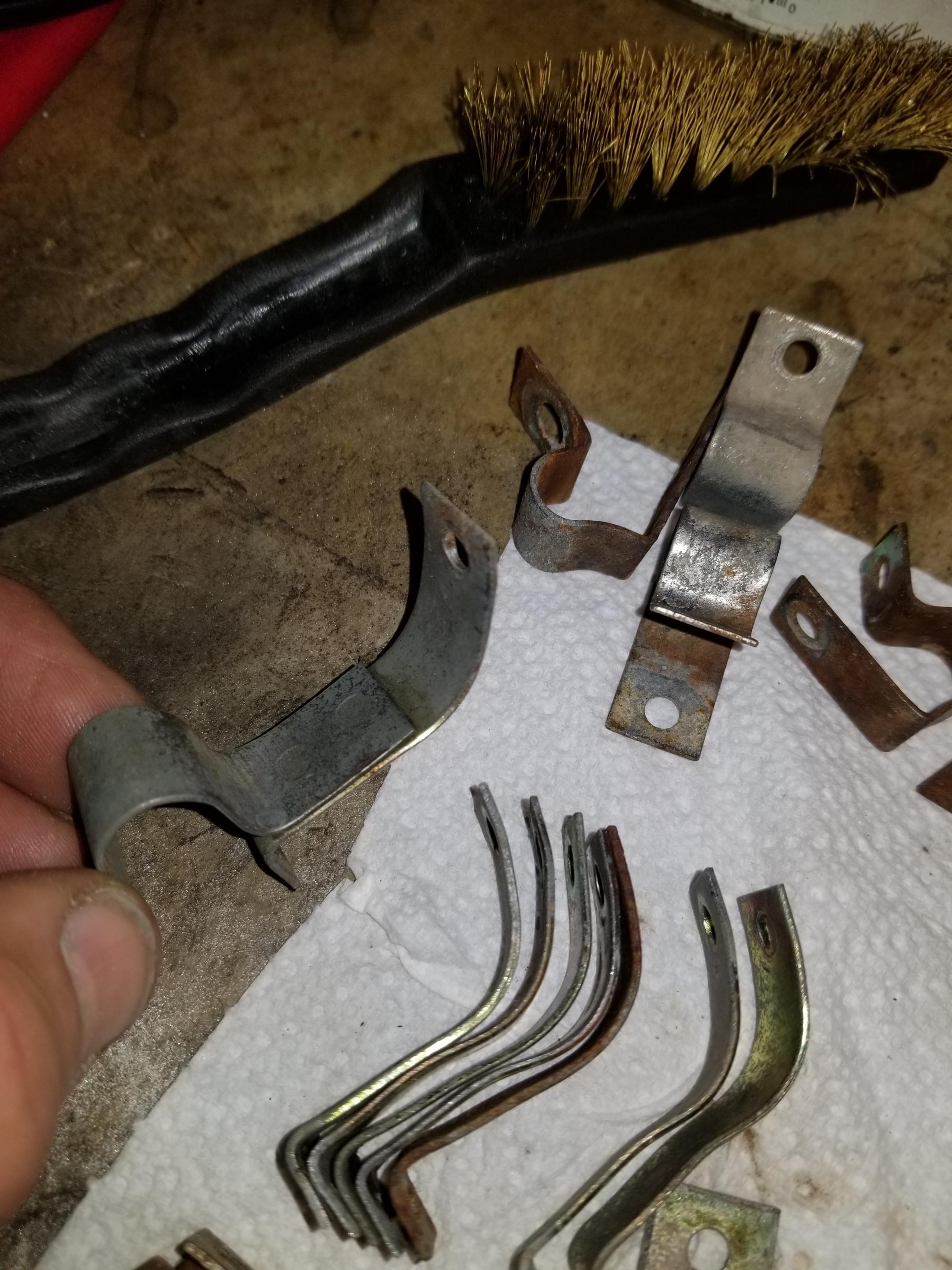

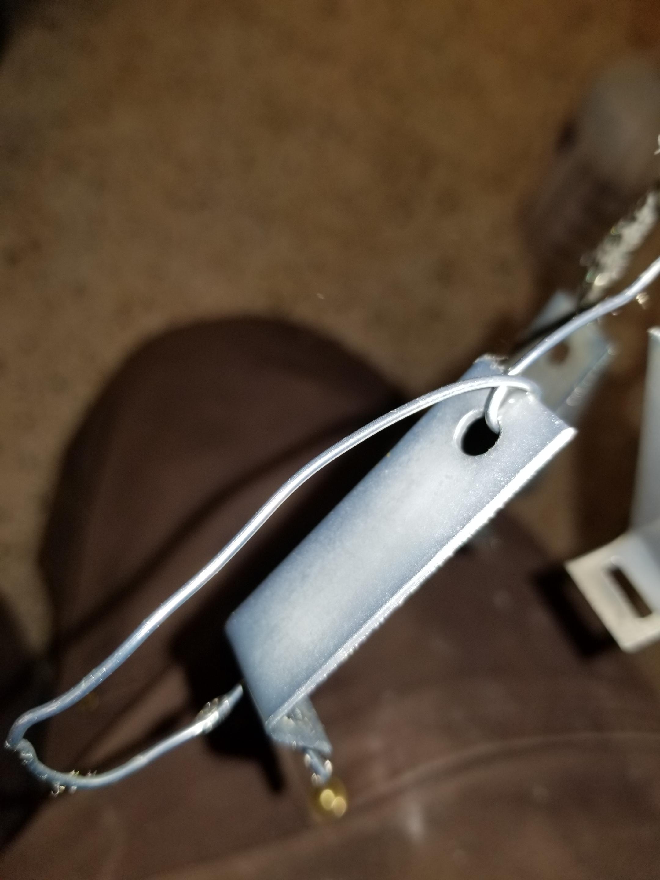

Then I started on the line insulator pieces. That didn't go so well...
By the way is this line bracket 280z specific?

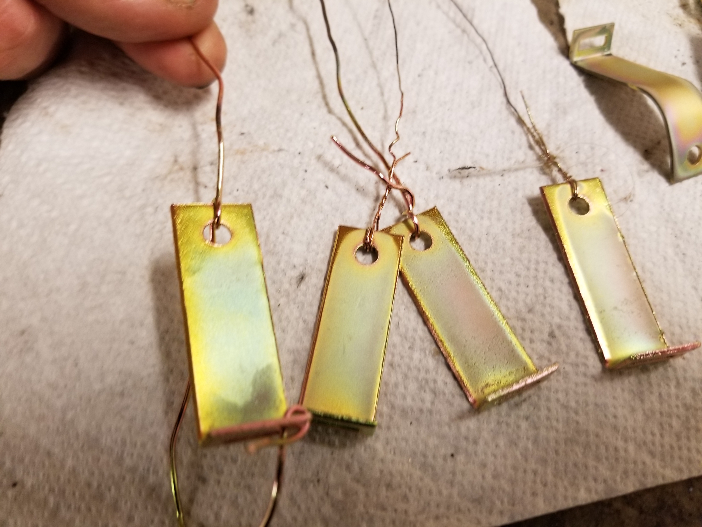

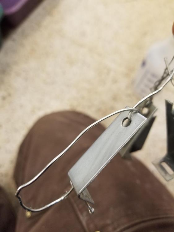

so I backed up and was figuring I was having a connection issue at the part. The hanging wires were plating beautifully
20171226_190050.jpg20171226_190057.jpgT
Those are both raw zinc, no chromate

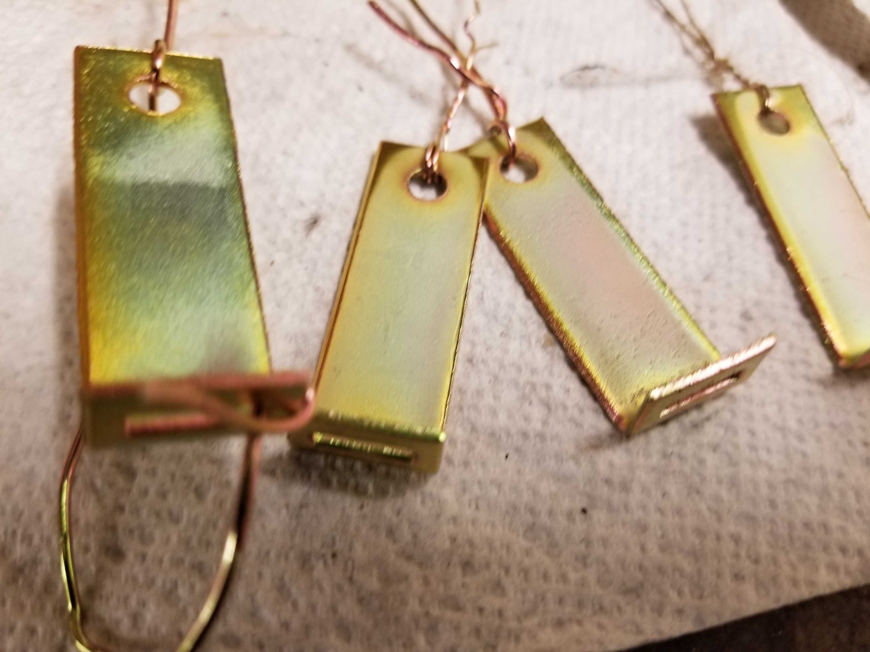

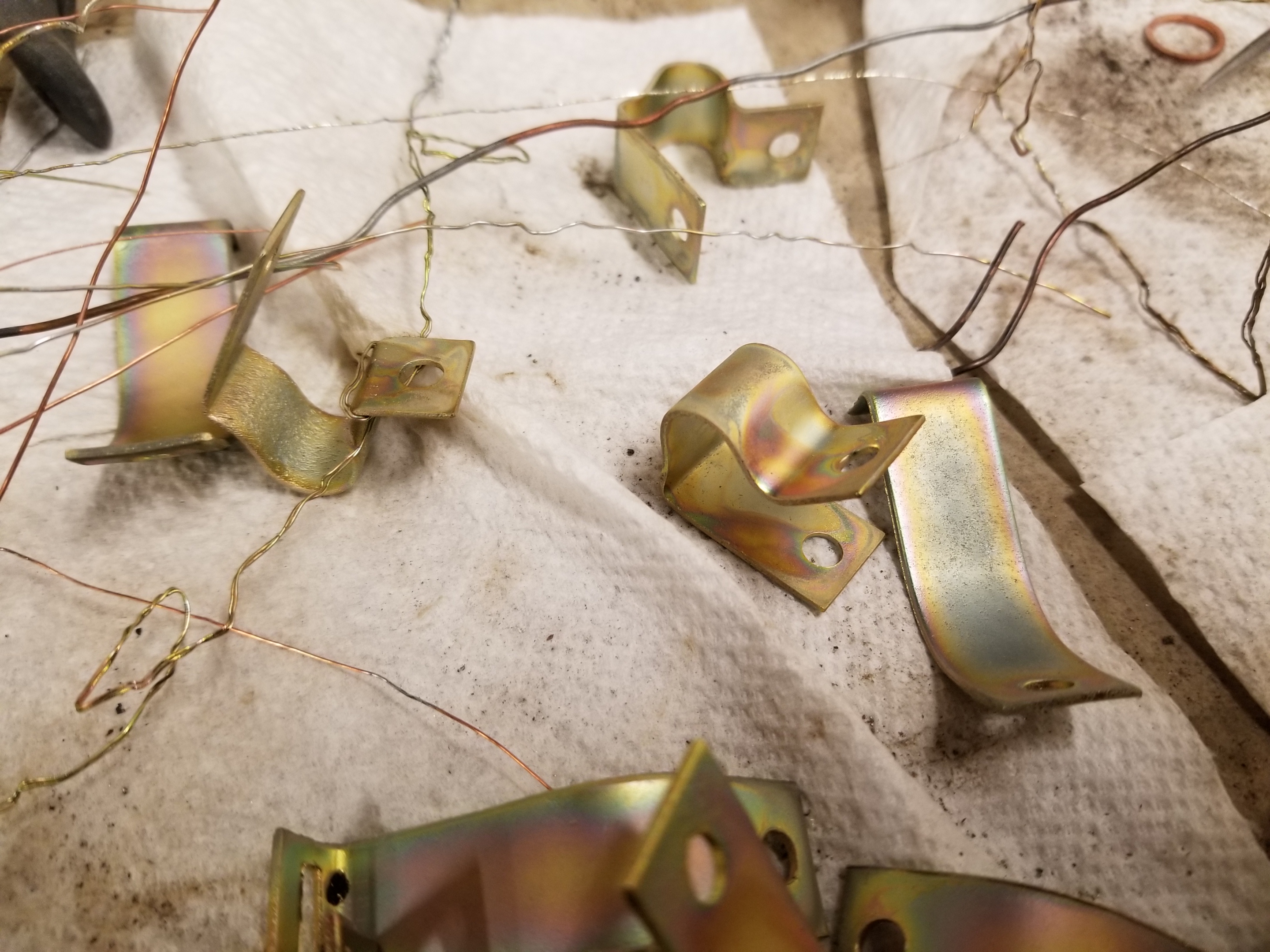

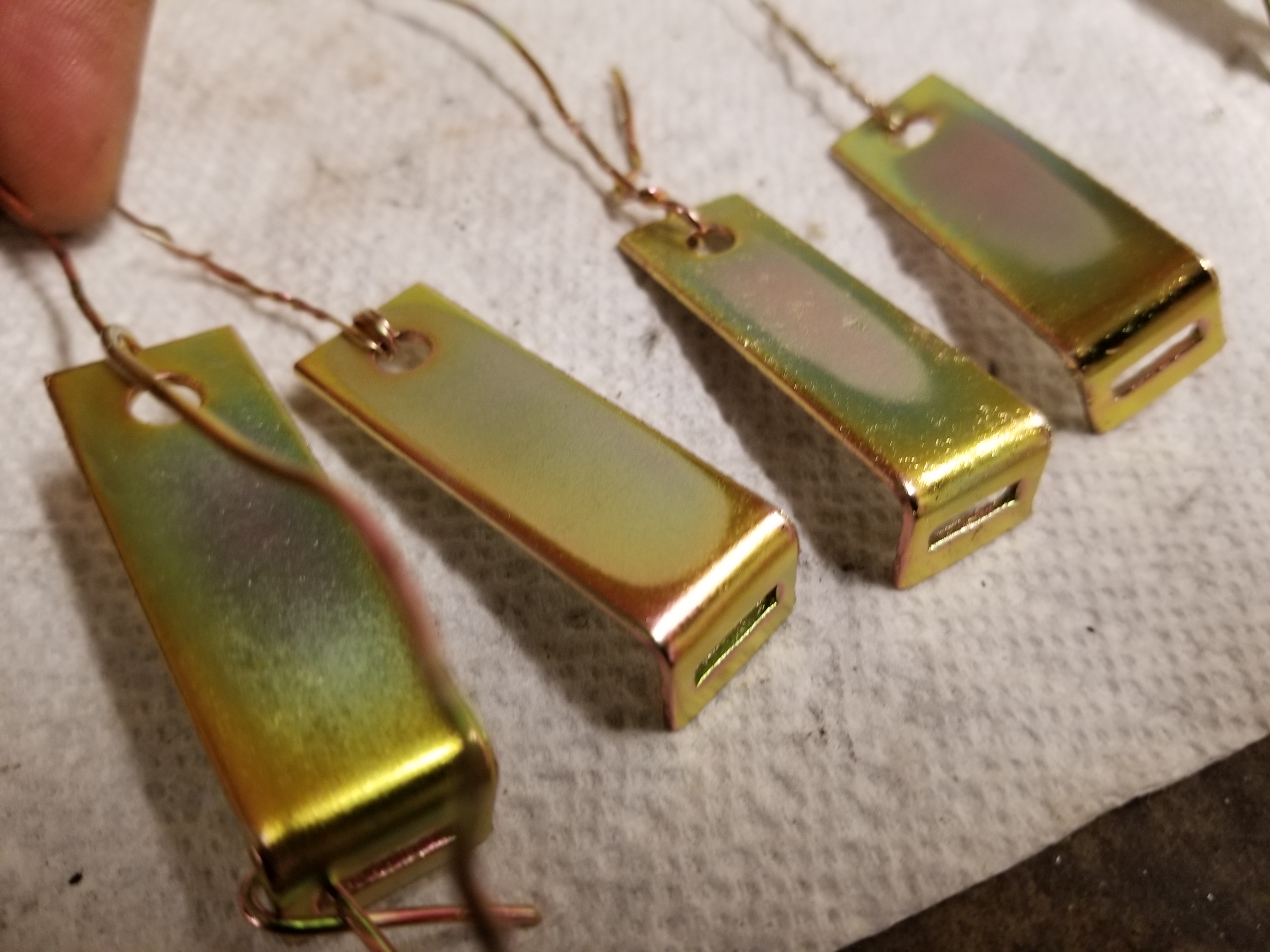

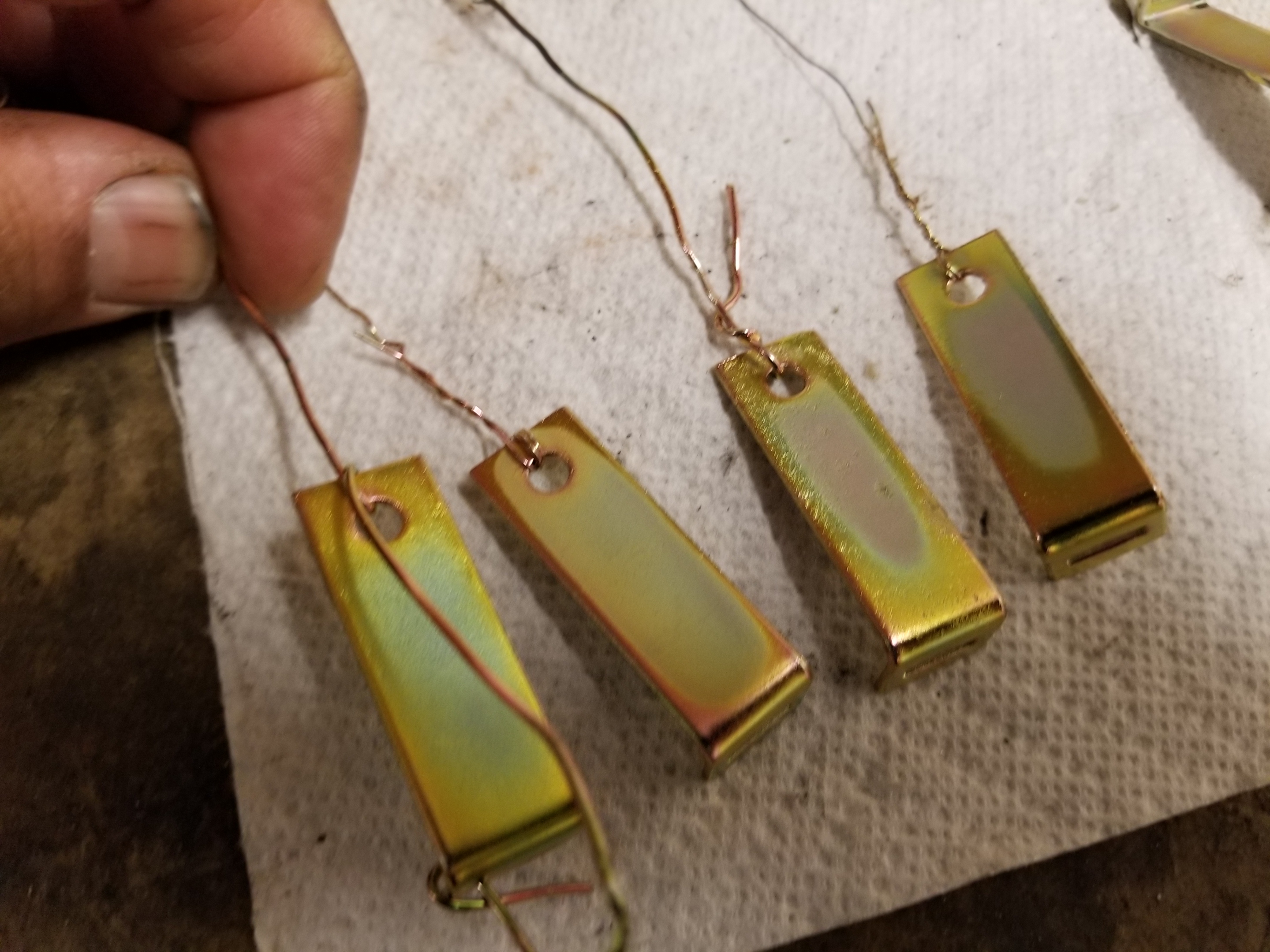

So I took 4 pieces all the same and wired them all differently. 2 with heavy wire and 2 with lighter wire
I degreased them and put them in the pickle until they quit bubbling..
Then I plated all 4 in the tank at the same time. I rechecked my areas and plated at 0.14 amps/inch
The one on the far left had a heavy wire tied top and bottom and it did the best. Second best was the other heavy wire 3rd from the left. Then the two lighter wires.

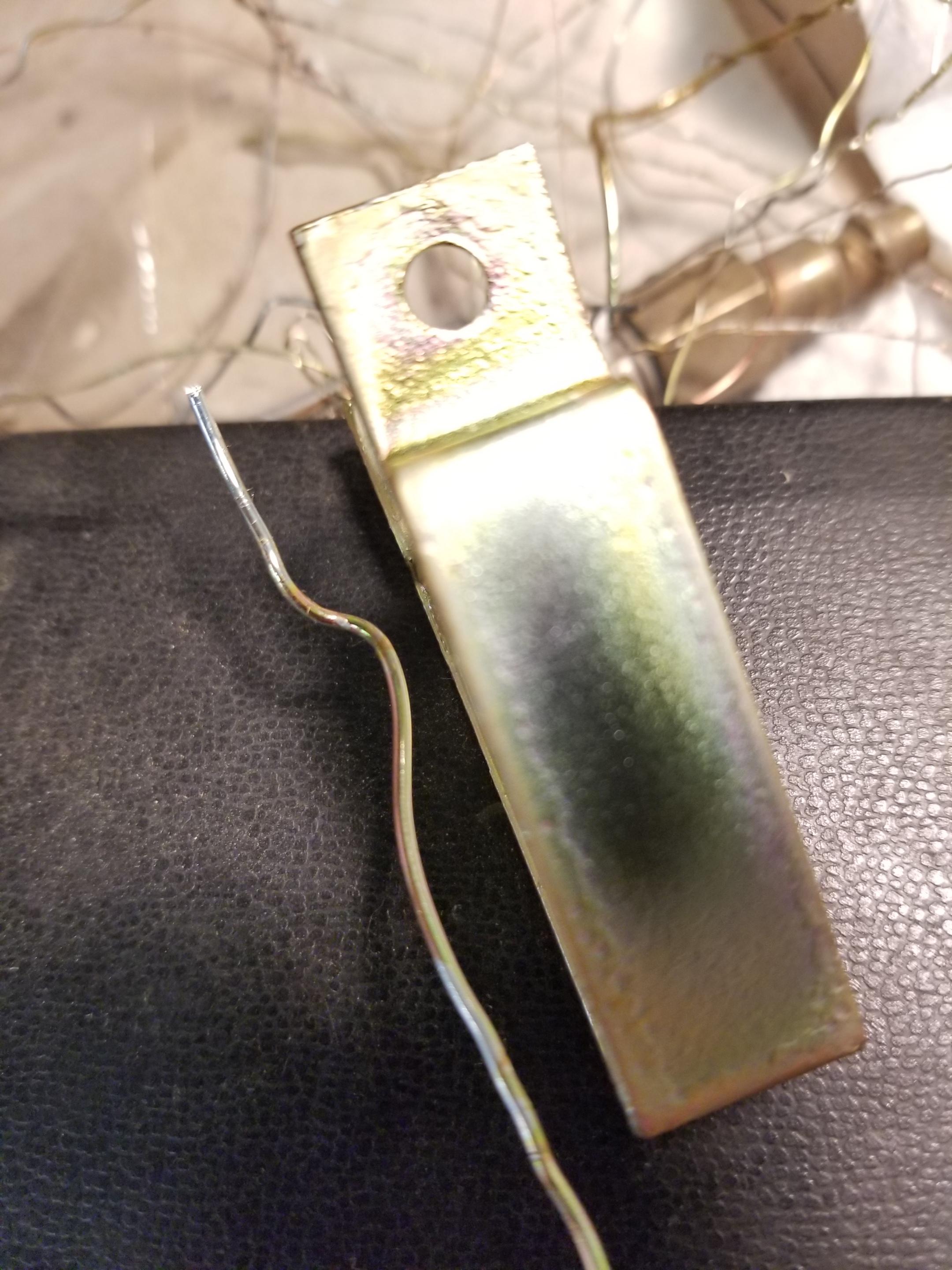

I am emailing with Caswell and got this advise:
After plating, try dipping in a very weak muriatic acid dip, about 2 seconds, then rinse and dip again in rubbing alcohol for 5 seconds, rinse and go in to the chromate. Let me know if that helps
I will try that, but these results seem to suggest a connection problem and maybe a not enough current. Thoughts?

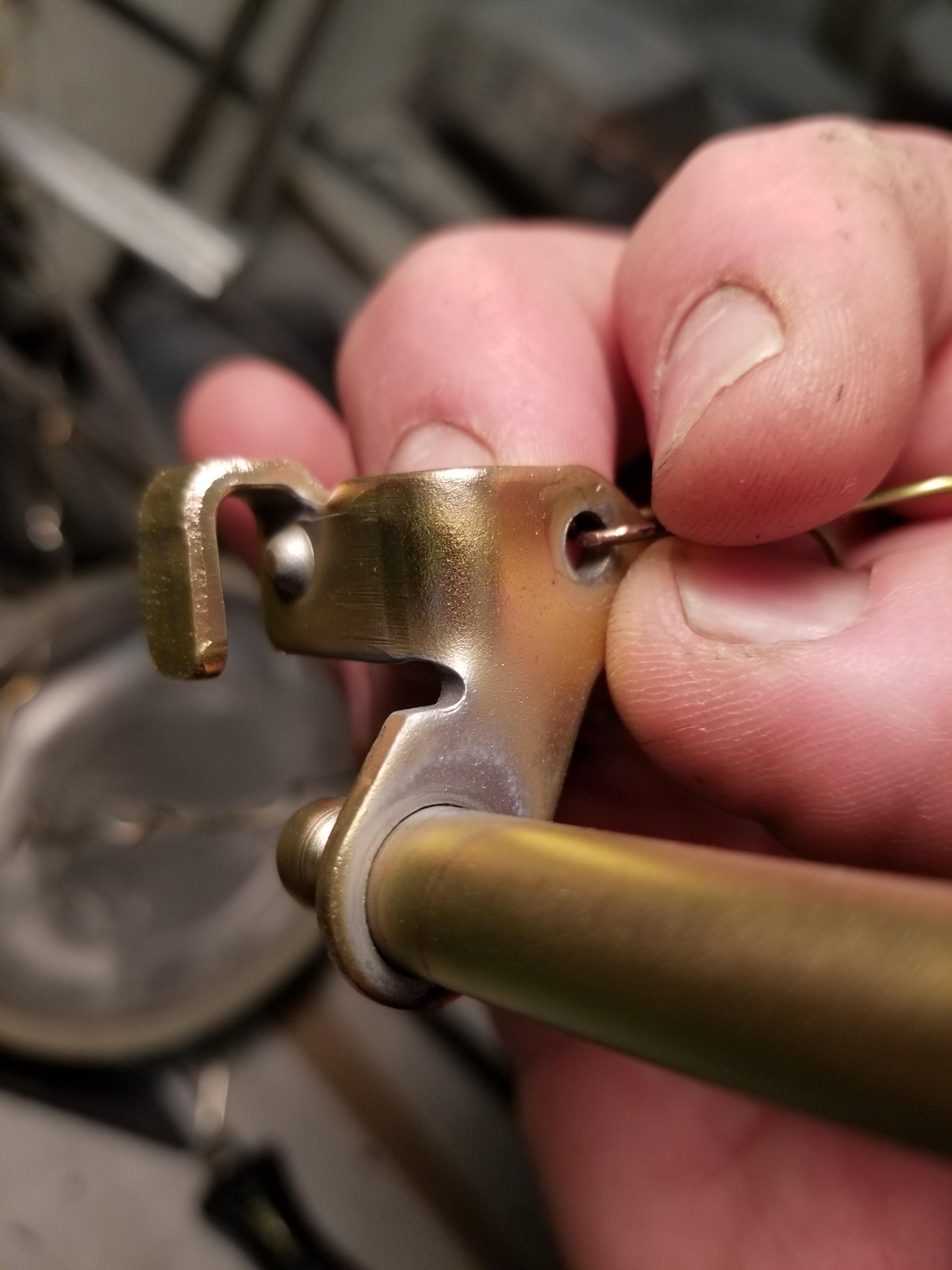

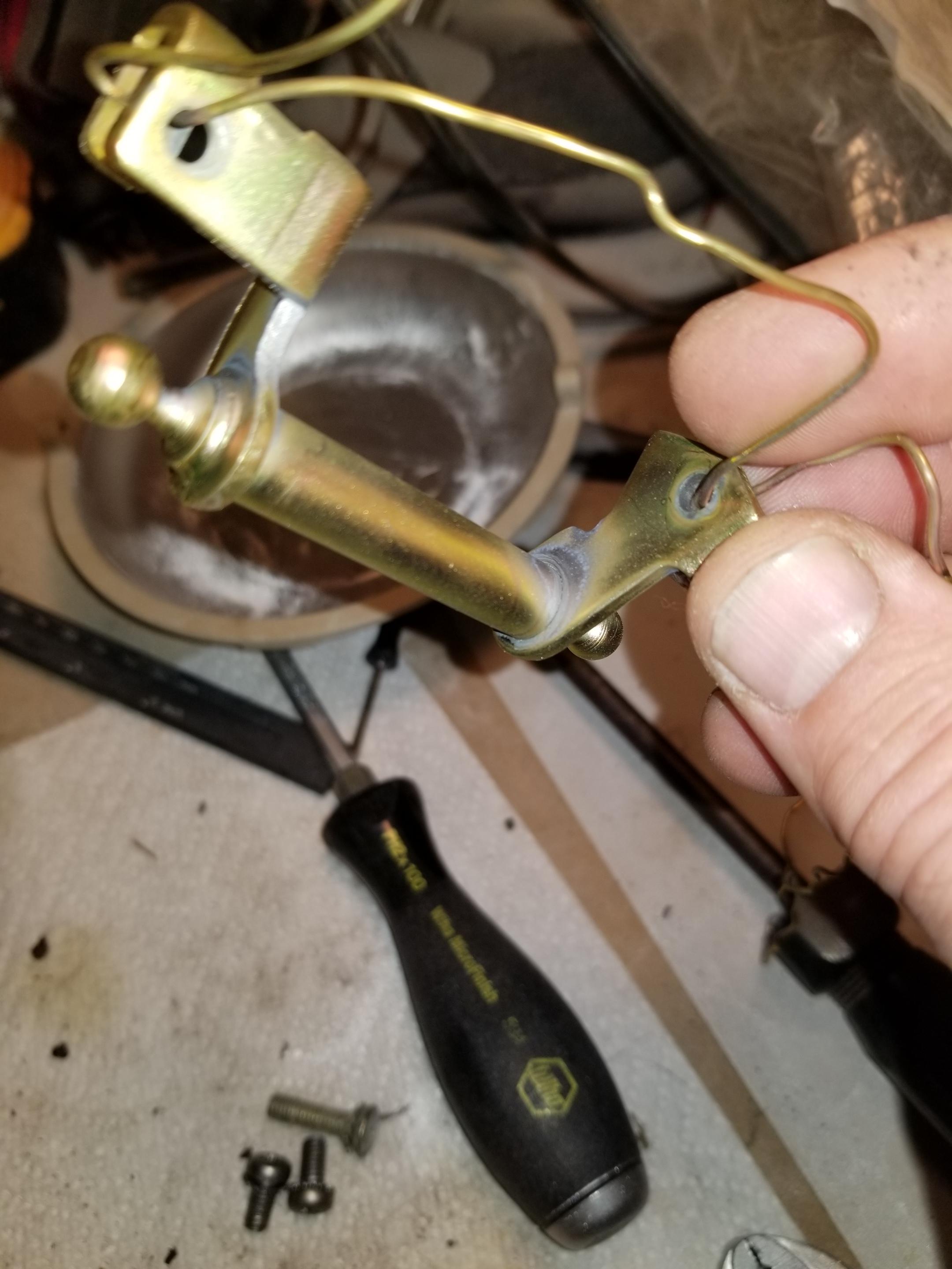

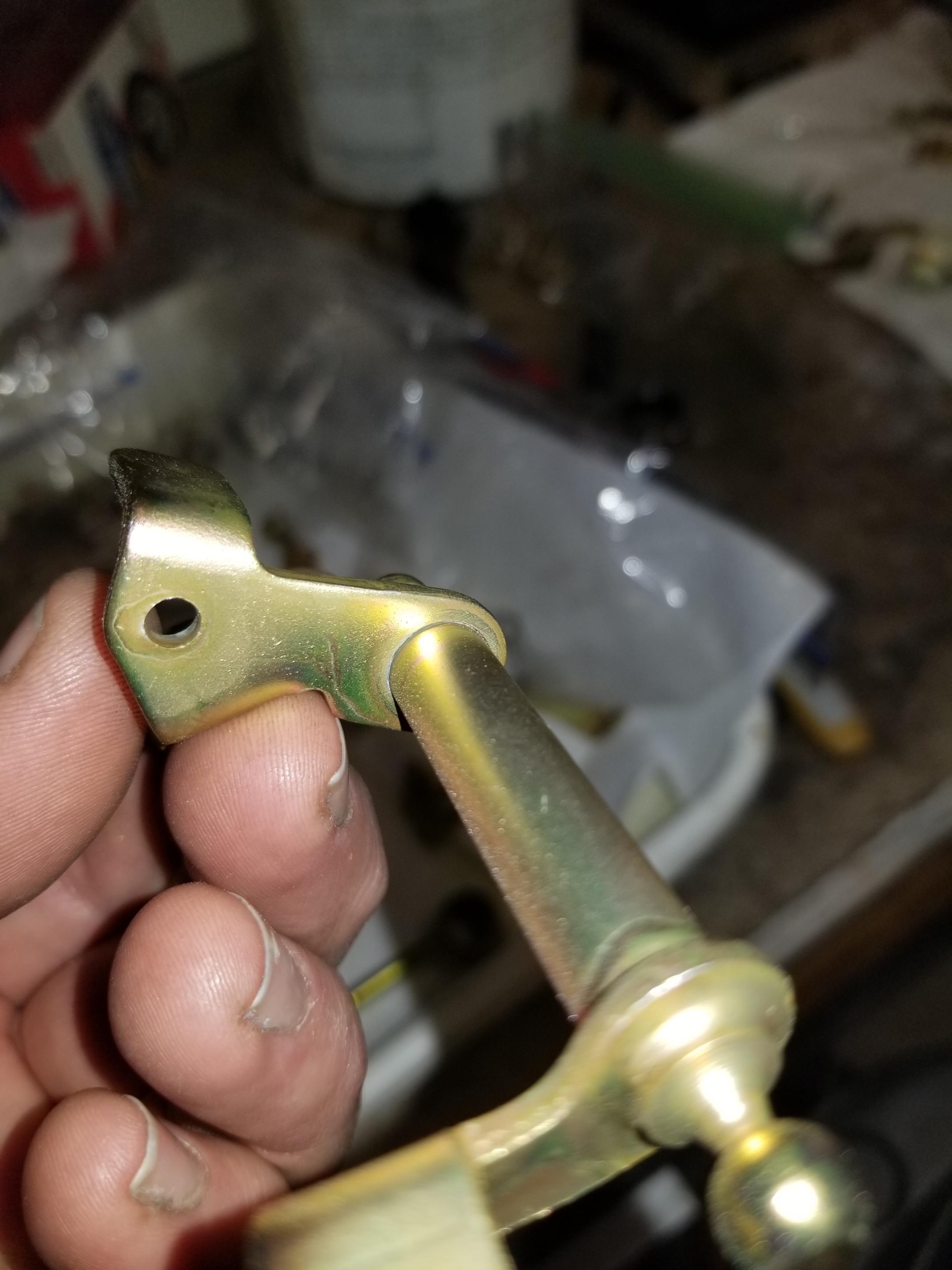

I also had some issues with this carb shaft. I was getting what I thought was heavy shadowing. So I reran it...
Now it is entirely possible I didn't get it clean enough. So I bead blasted it again and degreased and hung it so as to expose these areas better to the plates. This is what I got.

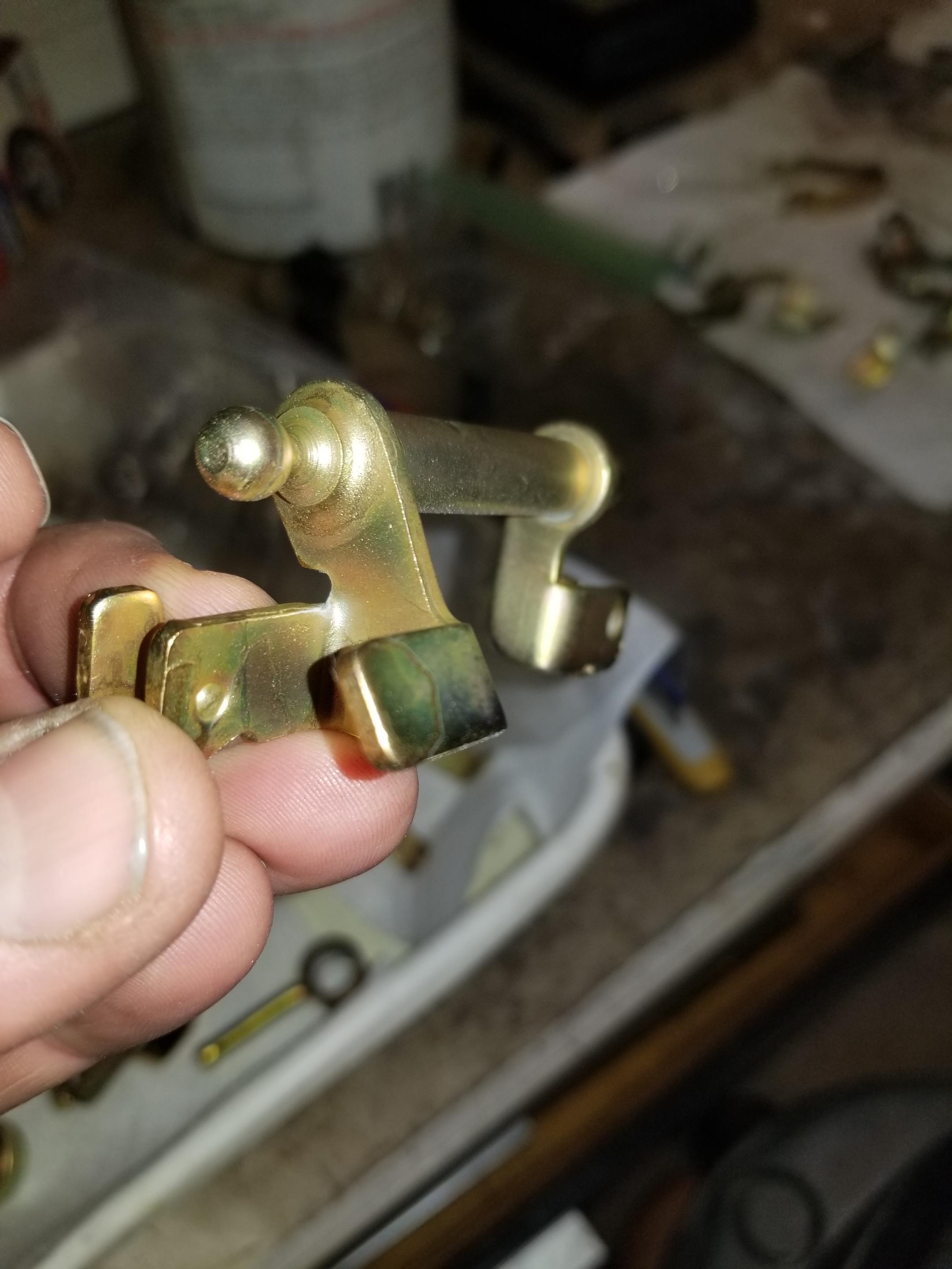

It came out really good.

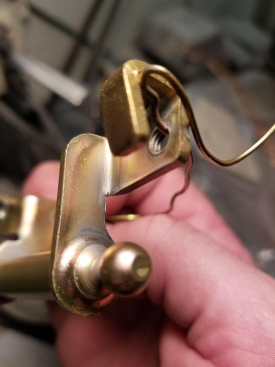

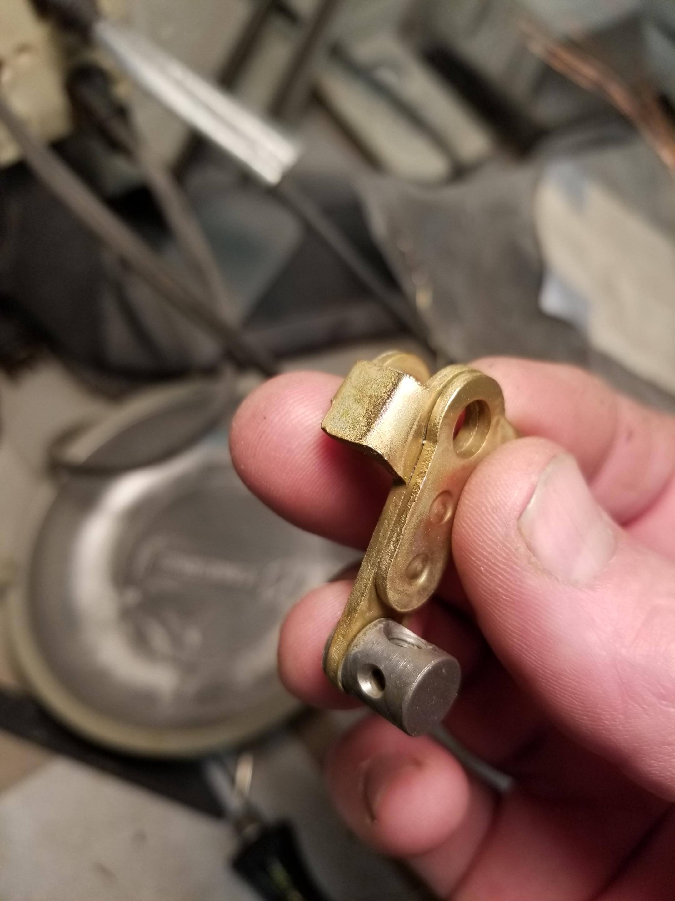

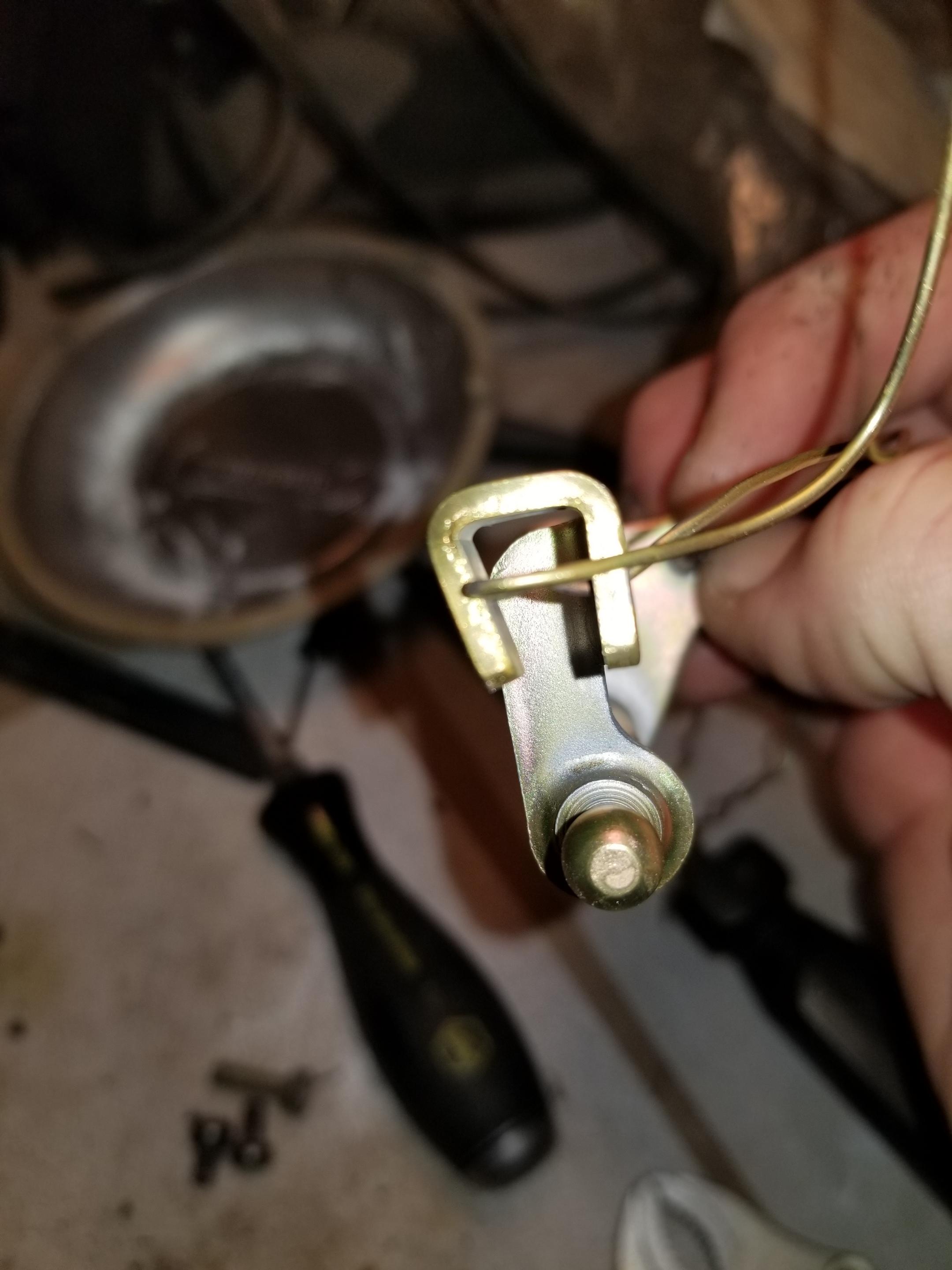

As an aside I had this piece not turn out. Evidently after bead blasting there was no circuit into the swivel part of the choke linkage. The bar plated but not the connection.
I stripped it and when I restrung it I added a wire through the barrel and it came out fine...

The centers of those parts basically look unplated. That is why they didn't chromate....
