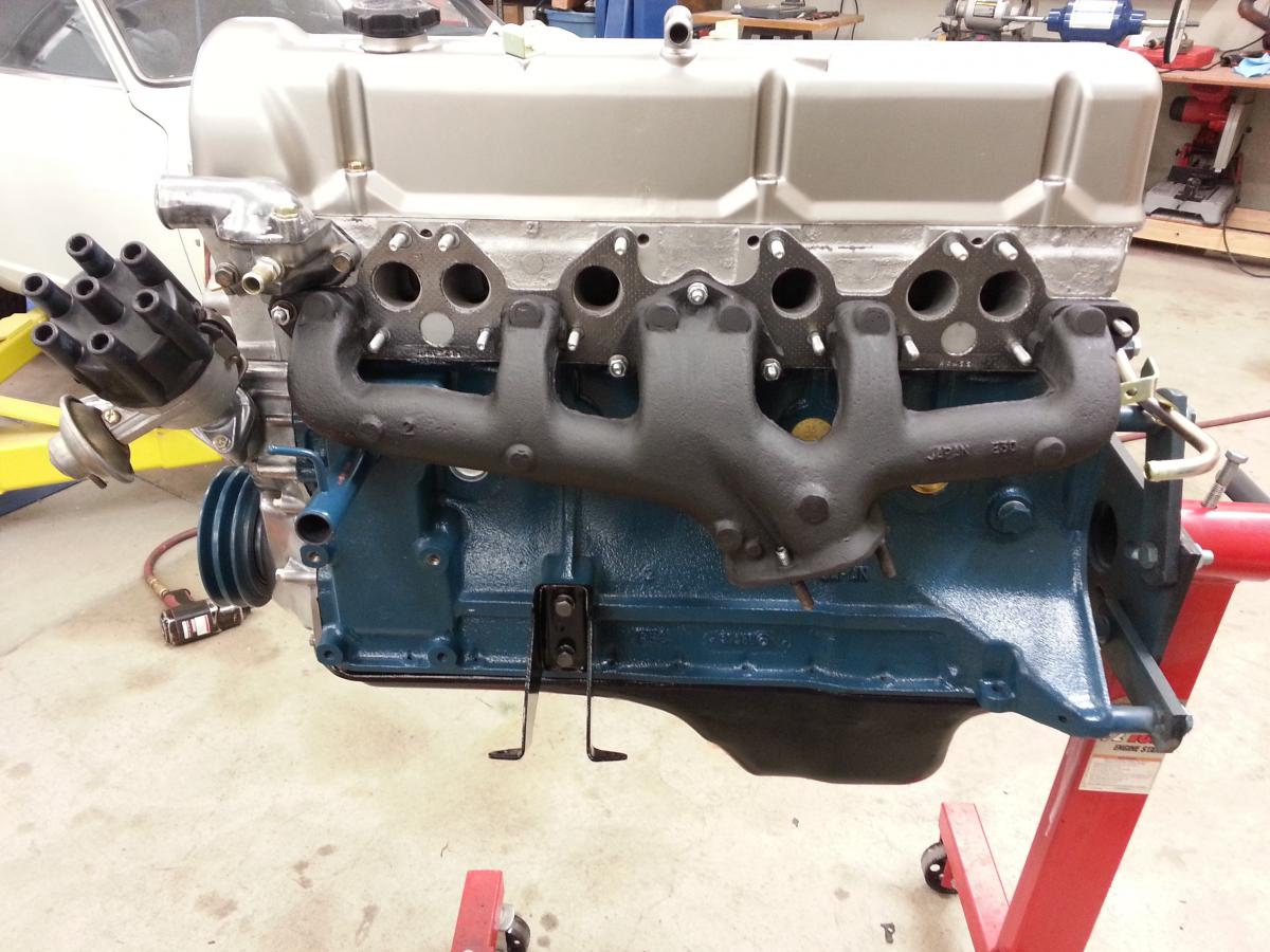

I have started to redo my engine and engine compartment. I have swapped out the original engine and working on another. I am planning on keeping the original 240 with the car (not sure why it does not match). I'd like to re use the manifold but to do that I need to take off and plug the air ports on the manifold. Is there any demand or reason to  keep that manifold intact and buy another one or just whack em off and not worry about it?

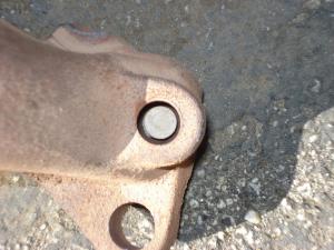

post-3522-0-59024700-1427226190_thumb.jppost-3522-0-85890700-1427226288_thumb.jp

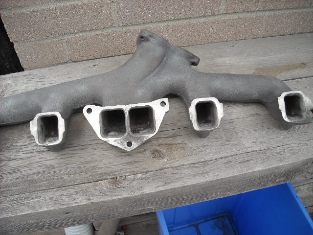

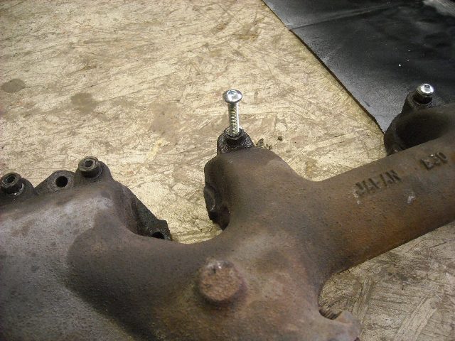

I just cut the air lines off my manifold then taped some threads and plugged them with bolts.
Then got a die grinder and removed all that metal that sticks out into the exhaust stream.
post-25243-0-93140000-1427240430_thumb.j
post-25243-0-56738100-1427240651_thumb.j
post-25243-0-87522800-1427240681_thumb.j

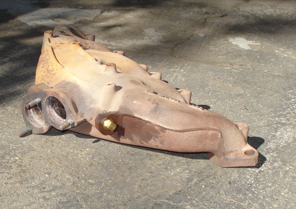

post-13264-0-84188300-1427243257_thumb.j
If you can get the air tube slugs out, you can buy brass plugs to fill the holes.
Our solution was to braze in steel plugs to fill the holes. The EGR port has been tapped for a pipe plug.

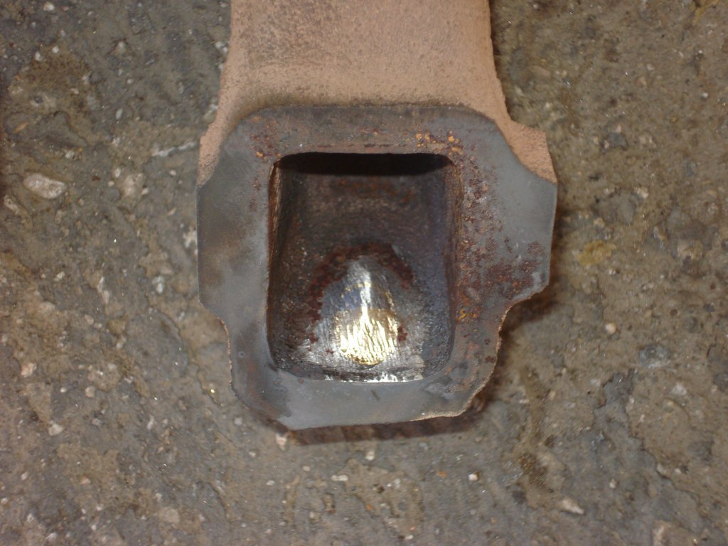

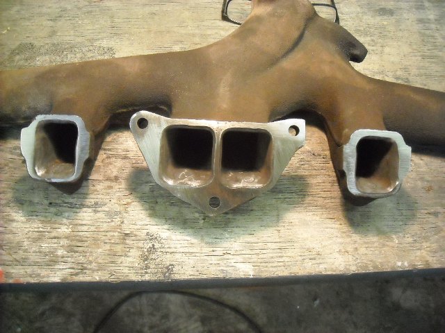

post-20451-0-16217000-1427247972_thumb.j
post-20451-0-97729100-1427247985_thumb.j
post-20451-0-64865600-1427248004_thumb.j

I used a stick welder and filled the whole hole, then ground it flat.  after repainting its hardly noticable.  Those brass plugs diseazd did look pretty slick though, that would match the freeze plugs.  In my case the connectors were completely frozen/stripped so i started by grinding the area flat first: no regrets.

Got it done thanks for the tips. I welded them in and ground them down.

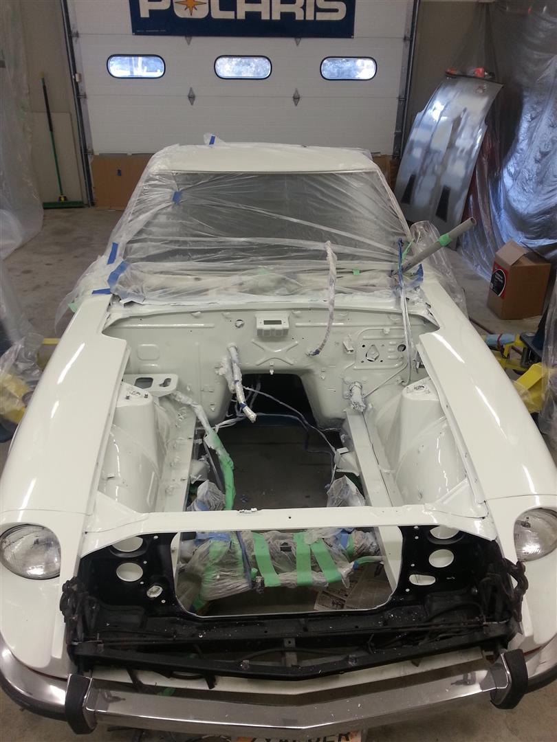

post-3522-0-37013100-1430234463_thumb.jp
