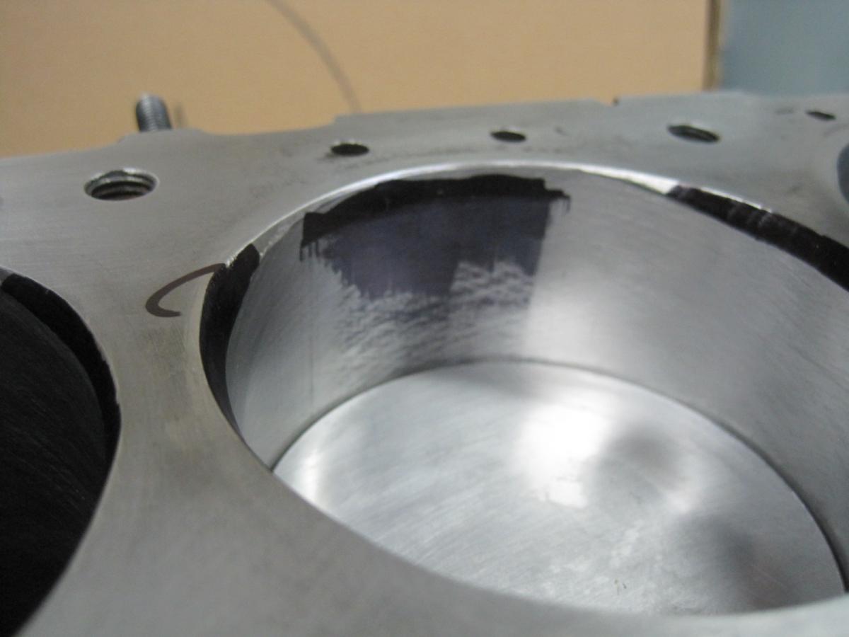

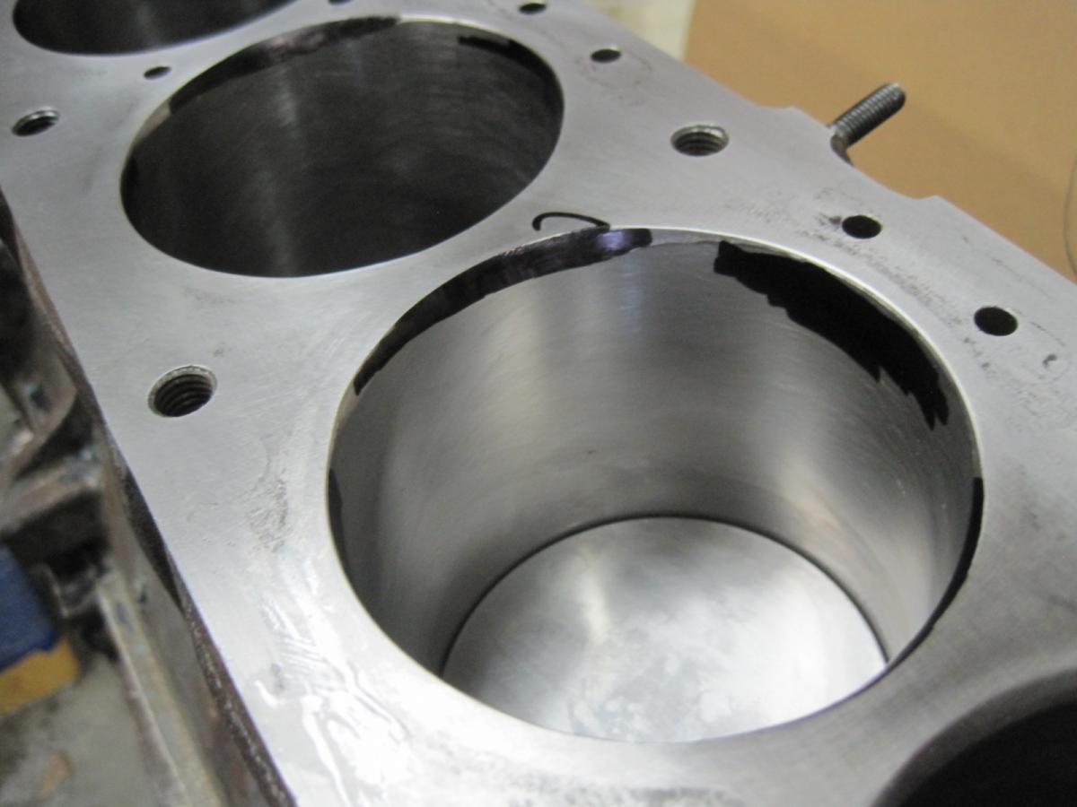

February 13, 201510 yr comment_463515 Your notches in the block look pretty deep........does the top ring fall short of the notches ATDC?Yes, they're definitely very deep and also too long ( circumference around the bore ). It just takes a slight bit of bore notching to un-shroud the Intake Valve and too provide clearance for high lift cams. Always do the minimum notching necessary in the bore. Excessive bore notching reduces CR ( can be as much as half a point ), reduces combustion quench ( not a good thing ) and creates a " Dead Zone " pocket for unburned combustion gases to collect. Bad spot to get carbon buildup and possibly cause detonation. And you never want the notch extending into the ring seat area. If that happens, go to a bigger over bore and hope you can salvage the block. Link to comment https://www.classiczcars.com/forums/topic/50936-l24-rebuild-again/?&page=2#findComment-463515 Share on other sites More sharing options...
February 14, 201510 yr Author comment_463527 Richard, your warnings are well noted. That's why I stated my disclaimer-. I really didn't exhibit any symptoms that I can say was directly caused by heavy notching. I fully intend to recheck that my top ring clears the notching as stated earlier. It is a bit of an old hot rodders trick to help make the engine breathe better, but like you said, it could cause dead spots for carbon build up. I don't believe I lost much compression, but we actually figured it in to my 9.5:1 CR. Didn't have issue with detonation either, but my engine didn't have a ton of miles. I didn't like the carbon build up I had, but this engine has been thru tuning hell with SU's and then triples. The length of the notch is following the HG, nothing more. I understand that it is waaayyy more than enough to just clearance a valve, but there was more to the notch than that. Link to comment https://www.classiczcars.com/forums/topic/50936-l24-rebuild-again/?&page=2#findComment-463527 Share on other sites More sharing options...
February 22, 201510 yr Author comment_464121 Well today was notch checking day-and they were all fine. My main concern was verifying that the notch did not extend into the ring area.The notches actually cleared more than what I thought they would.I verified by installing piston with top ring and using permanent marker around the bore. I ran the piston up and down in the bore until the top ring wore the marker off and that gave me a line of reference.I also checked my oil clearances using plastic gauge and they were in tolerance.  Next issue is rings. My rings do not fit my bores. The gaps are excessive. I actually have two sets of NEW rings and both sets show excessive end gap. I have seen as much as .027 on the top ring. I have had discussions with the machinist and without going thru the whole conversation I have decided to take my block and pistons to someone else for a second opinion. I believe the machinist went to far overbore to fix scratches that his machine put in the bore. I don't have exact dimensions but it sounded that he went to the limit of the tolerance. The only way to be sure is to take it somewhere else.If this is the case, I might just move on to my L28. Or my other option is to pull my numbers matching block out and work it.  Link to comment https://www.classiczcars.com/forums/topic/50936-l24-rebuild-again/?&page=2#findComment-464121 Share on other sites More sharing options...
