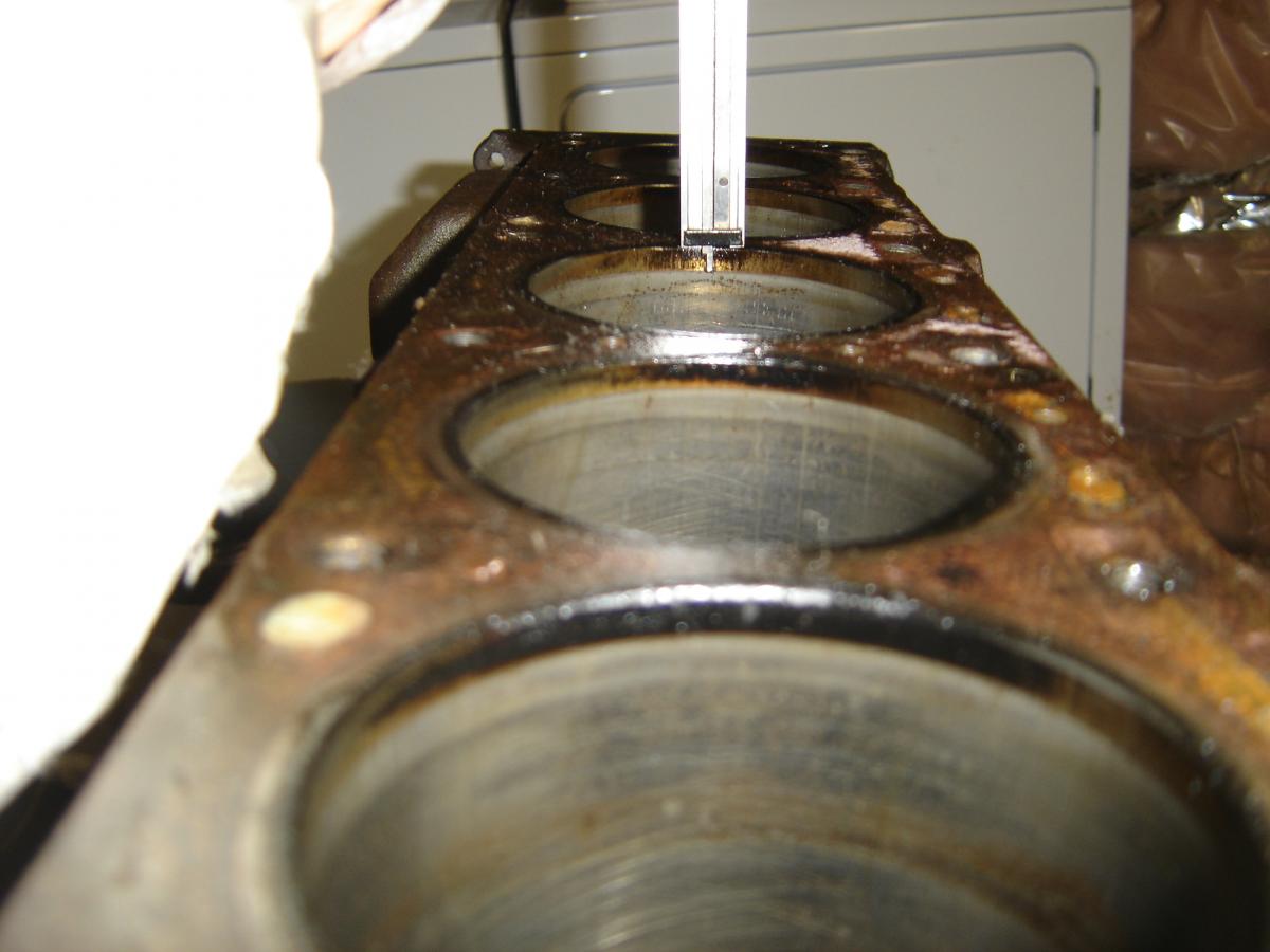

I did some measuring for the block notching.  It's .225" down to the top ring

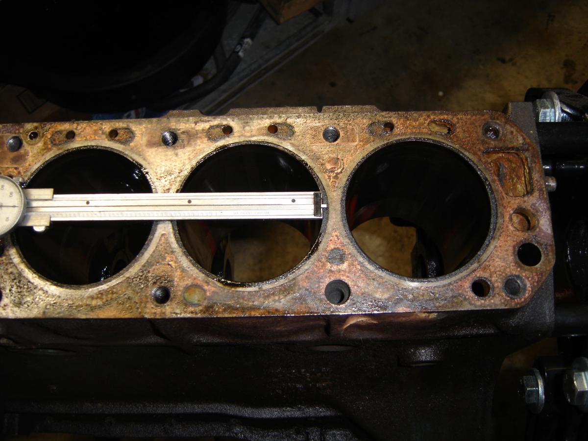

And .10" across to the edge of the fire ring

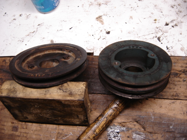

Can I use my pulley with the A/C row removed?

Might consider doing the notching now while everything is clearly marked. Your piston rings and HG have left you a perfect guide or line to NOT PASS while you are grinding. You can lay the HG on the head and mark a center line for the valve centerline and transfer that to the block. This will show you where the the outer radius or edge of the valve will be. Grinding now before cleaning makes sense too.
As far as grinding tools , I used a 60 grit drum sander on a dremmel. It is very controlable and takes material off slowly and smoothly. If it happens to jump around it won't gouge anything like a carbide bit will.
I do want to do it before the machine shop get's it.  I'll have those carbon lines and the honing of the bores will make sure everything smoothes together.  I can't believe a dremel will cut that, amazing.  I use the same thing on my dogs toe nails then the next day (after she get's over being pissed at me) I hit them again with 120 grit.  Almost forgot that I've got a spare 2.4 block to practice with, it's never been cleaned either.  Now I've got a plan.  Gotta have a plan! :D
