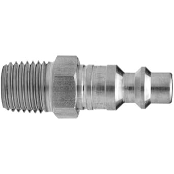

The drill is a great help.  I couldn't use it on the valve stem without removing the cam towers so I took the suction cup off the wooden handle and shoved a 3/8" male air coupler into it and then chucked it up, that works great.

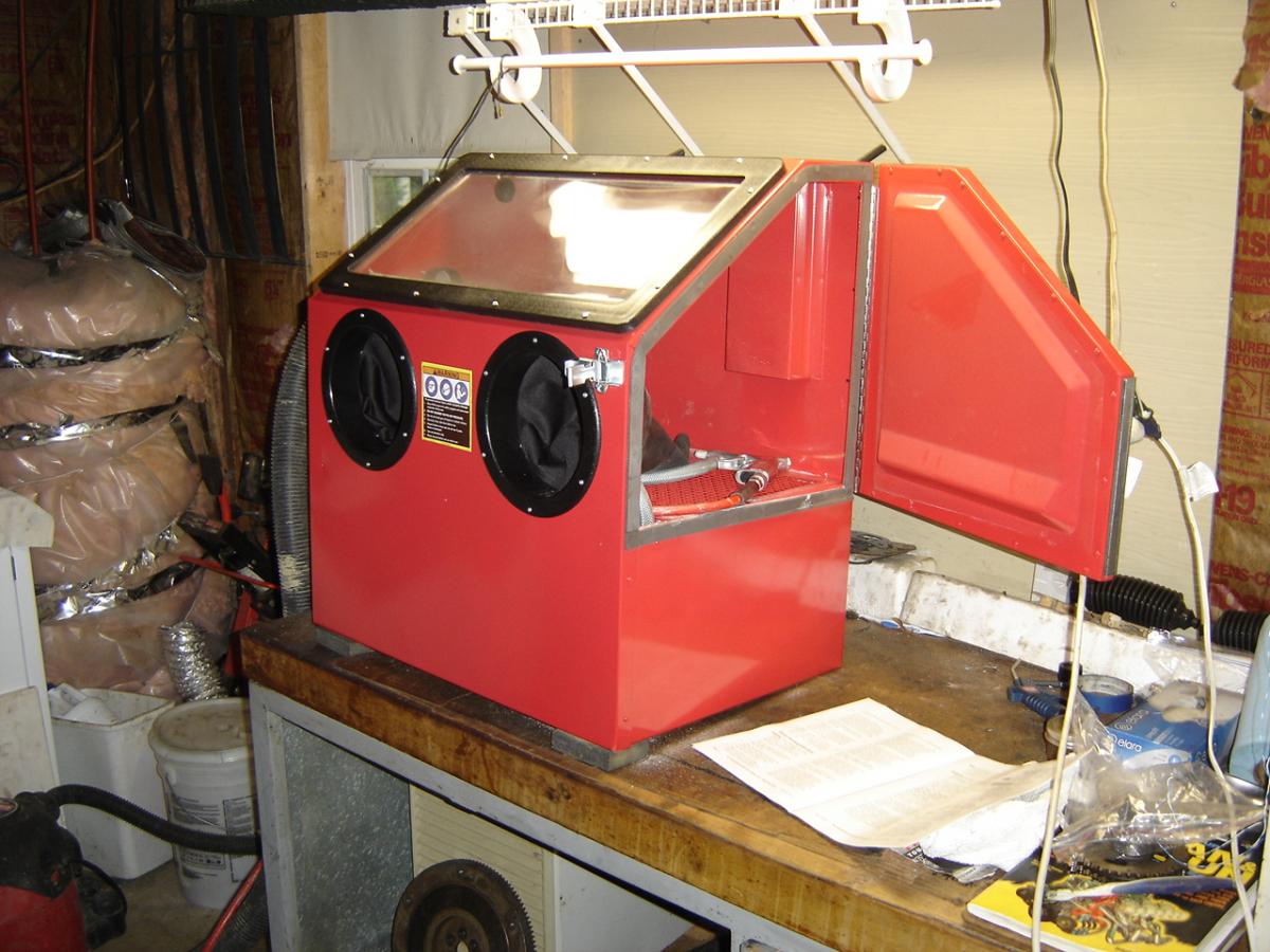

I'm taking a few days off next week to get this motor back in the car.  I'm a procrastinator amongst other things.
So here's what I've done this morning instead of putting the rings on the pistons.  I'm trying to learn the Chinese tricks, like kicking and shaking, banging against the table etc.

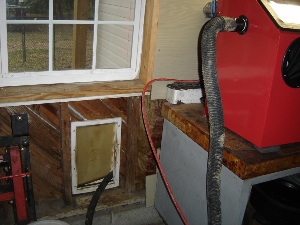

Harbor Freight blast cabinet, NO MESS. :)
post-23570-0-39597700-1444491279_thumb.j
post-23570-0-54653100-1444491284_thumb.j
Before satin Diamond Clear Coat
post-23570-0-66247100-1444491289_thumb.j
One thing to remember when you blast is you are removing material and roughing the surface. Because of that I typically protect mating surfaces with blue tape.
Good point, reminder.
I'm glad I have the blast cabinet. You can look close up with the window opposed to the blast pot I used the first time. Found 2 small cracks in the thermostat housing that are leaking onto the bolts that hold it on the head. Thank goodness I have extra parts. The diZease pays off once again!
