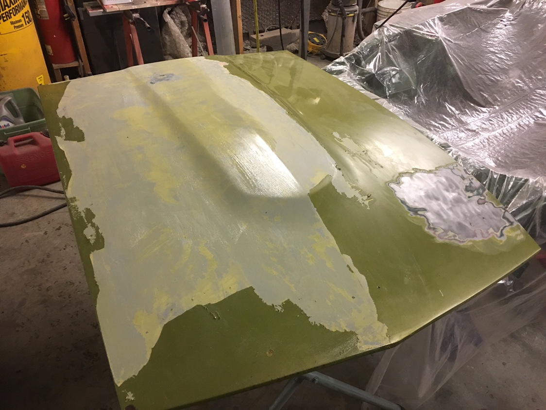

That is the plan. There is definitely some filler on the hood and I have removed the top layer of paint to find epoxy primer already there. But it is over top of the original paint and some older filler too. I need to remove ALL the old paint and filler and start fresh like I did on the rest of the car. Some people insist on filler before primer, but with the new epoxy primers, they provide a really good bite for the filler to bond to and do a great job of sealing the bare metal to prevent rust.

The facts about filler before primer is what I have been researching for about 2 months now. But I have concluded that many reputable places say that its fine to put the epoxy down first.

I'm not an expert by any means, but in the course of my research, almost all the people who advocated for filler over bare metal were the "old timers." As best as I could tell, epoxy -> filler -> primers seems to be the fairly universal best practice these days.
I agree. If you are using traditional paint and primer products, then bare metal then filler. But the new 2K epoxy's  are marvelous to work with.
I also use an thinned epoxy as a sealer over the finished body filler to seal it all in. That can be sanded and hi-build used over that for finish blocking.
You can't really group all fillers and/or all primers and/or all "epoxies" in to single groups, to mix and match.  "Epoxy" just describes one tiny part of a paint or filler, the varieties of coatings systems that use epoxy end groups is huge.  Chemical compatibility would be determined by the whole thing.  The same goes for 2K urethanes.  Which probably contain epoxy groups, along with numerous other components.
Your best bet would be to use a system from a single manufacturer, that's been proven and tested.  Besides the immediate results you might get from experimenting, long-term results can be dramatically different.  Even the car makers got burned in the 90's by using a system that didn't block UV light from the sun.  All of those old Ford Rangers and GM trucks with the exposed primer in big giant patches came from that failed advance in coatings technology.  The UV got through and destroyed the bond of the top coat to the primer.  They shortcutted the environmental tests and paid for it.
Short response - these aren't the same materials the old-timers were using.
Very true Zed. Use a proven combination of products and read the labels carefully. Mix and prepare the products as per the manufacturers direction and you should be good to go.
There are times I wish I was using the old school products, albeit at a greater health risk...!
