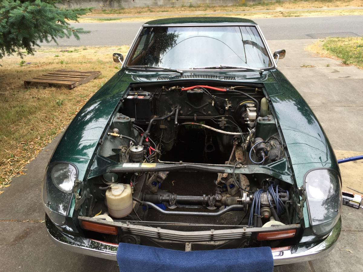

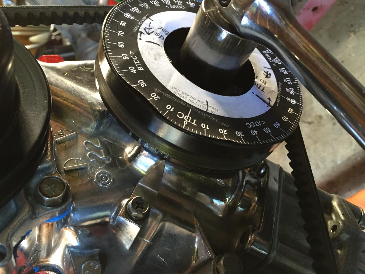

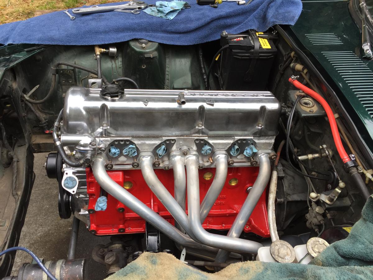

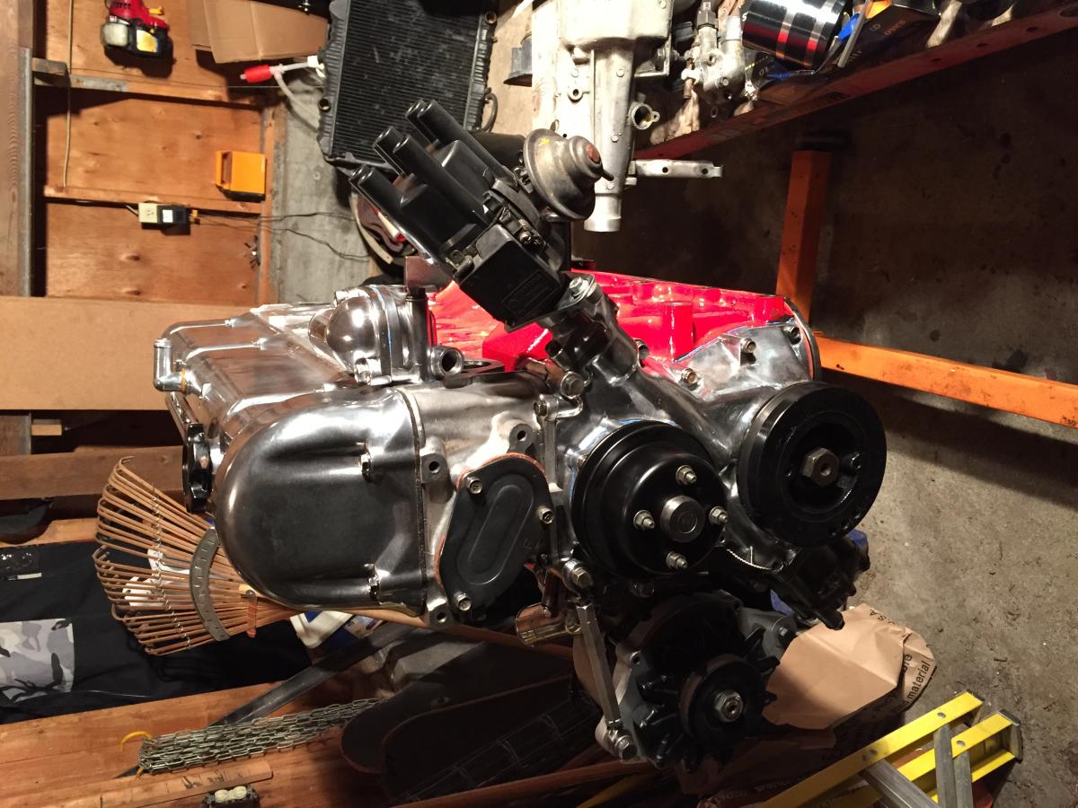

June 14, 201510 yr Author comment_471929 got her all buttoned up yesterday - a few odds 'n ends left to do, most of all gotta make a plate to re-mount the timing indicator closer to the new balancer. it's about 2" away now, since it was set up for the original 3-row pulley, which is much bigger. i'll have to dig out my degree wheel and piston stop to set exact tdc then i'll get her all timed up. the zx dizzy is different than the one on my '78, so i'll need to figure out what wires go to the multiple male spade connectors all over it... it's the one thing i didn't bother cleaning up because i'm not going to keep it for long - hope to build the crank-fired system over the next few months. my wife & daughter asked me what i'd like to do for father's day, and i told her i'm hoping i can call in all my "head of household" credits and get some help with the engine swap. let's just say they were expecting a response more like "brunch and a day at the park" - but i'm sticking to my guns on this one Edited June 14, 201510 yr by rossiz Link to comment https://www.classiczcars.com/forums/topic/50727-a-project-is-brewing/?&page=10#findComment-471929 Share on other sites More sharing options...

June 15, 201510 yr comment_471957 Nice work! Looks like it all sealed up real well. What will that cylinder head temp sensor be doing, since you have done away with the efi ... Link to comment https://www.classiczcars.com/forums/topic/50727-a-project-is-brewing/?&page=10#findComment-471957 Share on other sites More sharing options...
June 15, 201510 yr Author comment_471968 thanks for the kind words - i'm really looking forward to getting the transmission done so i can swap it into the car and fire it up.right now that cylinder head temp sensor is simply preventing a horizontal coolant geyser at startup. i'm gonna get a plug for it, but for now just didn't want anything falling or crawling into the block, as my garage isn't exactly a hermetically sealed clean room... Link to comment https://www.classiczcars.com/forums/topic/50727-a-project-is-brewing/?&page=10#findComment-471968 Share on other sites More sharing options...

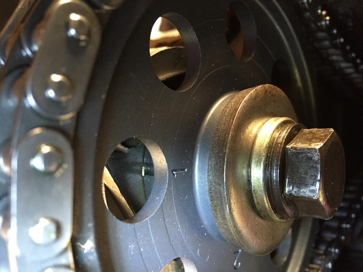

June 15, 201510 yr comment_472011 So while you have the degree wheel mounted your not going to degree the cam? Link to comment https://www.classiczcars.com/forums/topic/50727-a-project-is-brewing/?&page=10#findComment-472011 Share on other sites More sharing options...
June 15, 201510 yr comment_472012 right now that cylinder head temp sensor is simply preventing a horizontal coolant geyser at startup. I think that the CHTS hole is dry. On the ZX distributor - some, the later ones, came with an E12-92 or -93 module that has an electrical timing advance connection. It can cause problems sometimes, apparently. The E12-80 only has one external connector, with two pins, and the reluctor connections on the inside. You can swap the modules, or there's a method to lock the advance connection into one state by applying power to it. Link to comment https://www.classiczcars.com/forums/topic/50727-a-project-is-brewing/?&page=10#findComment-472012 Share on other sites More sharing options...

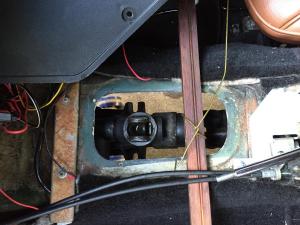

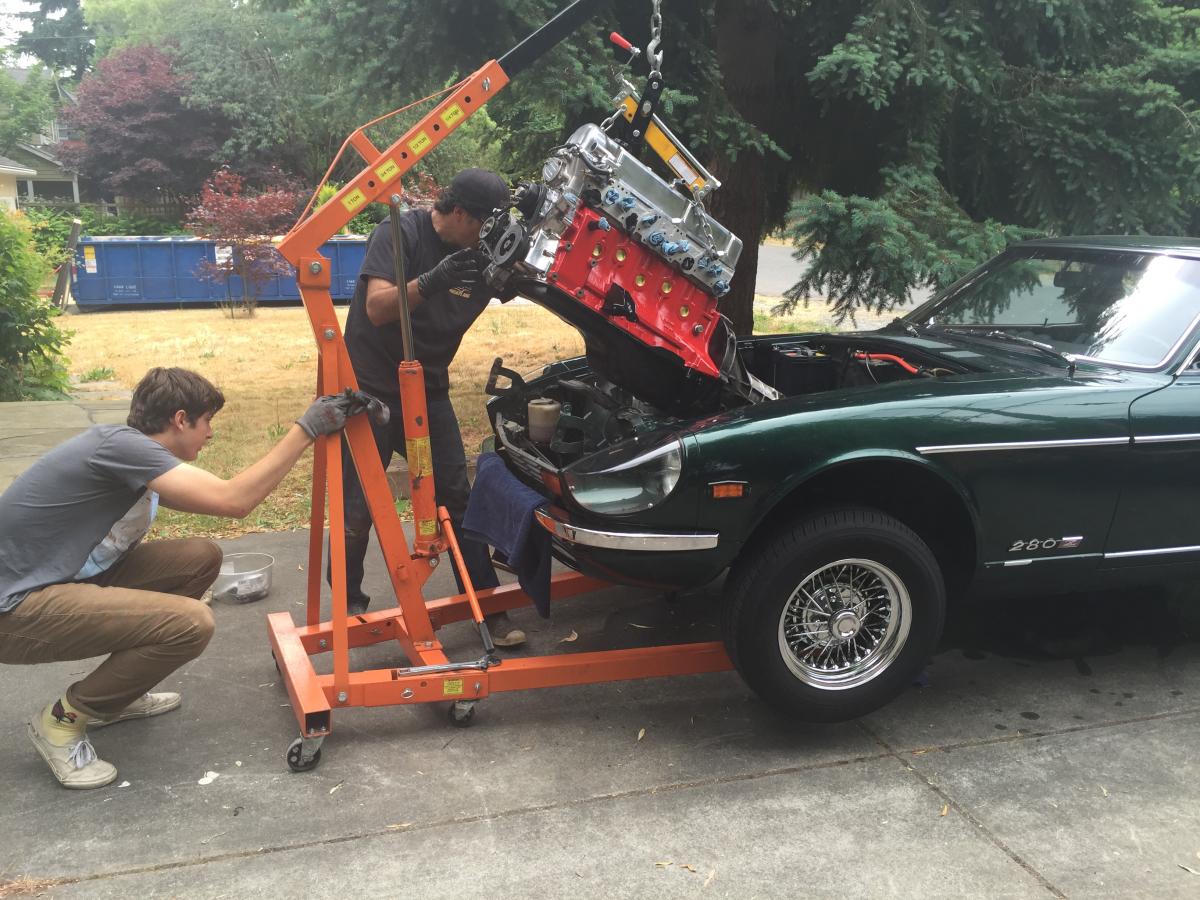

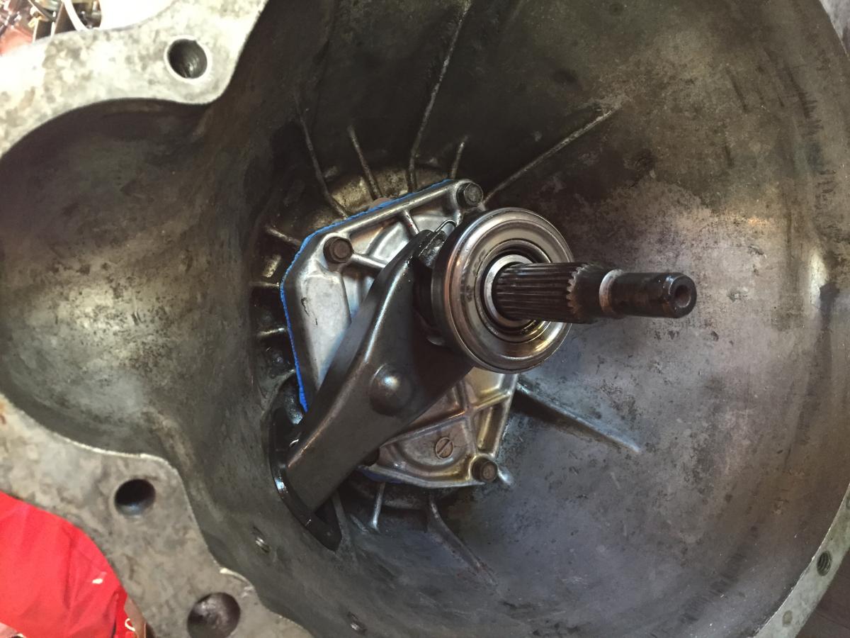

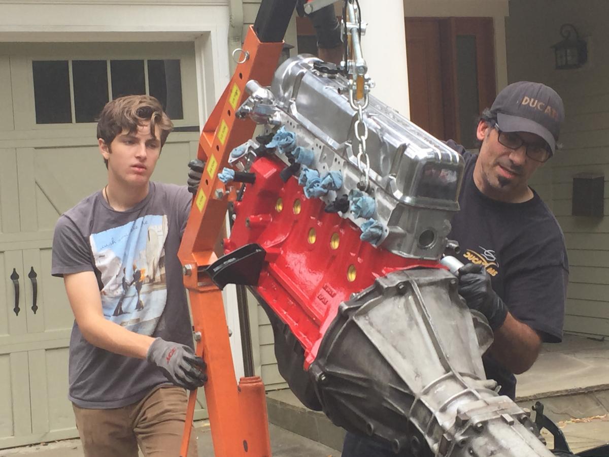

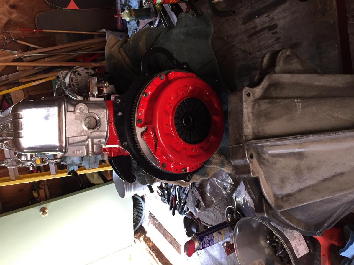

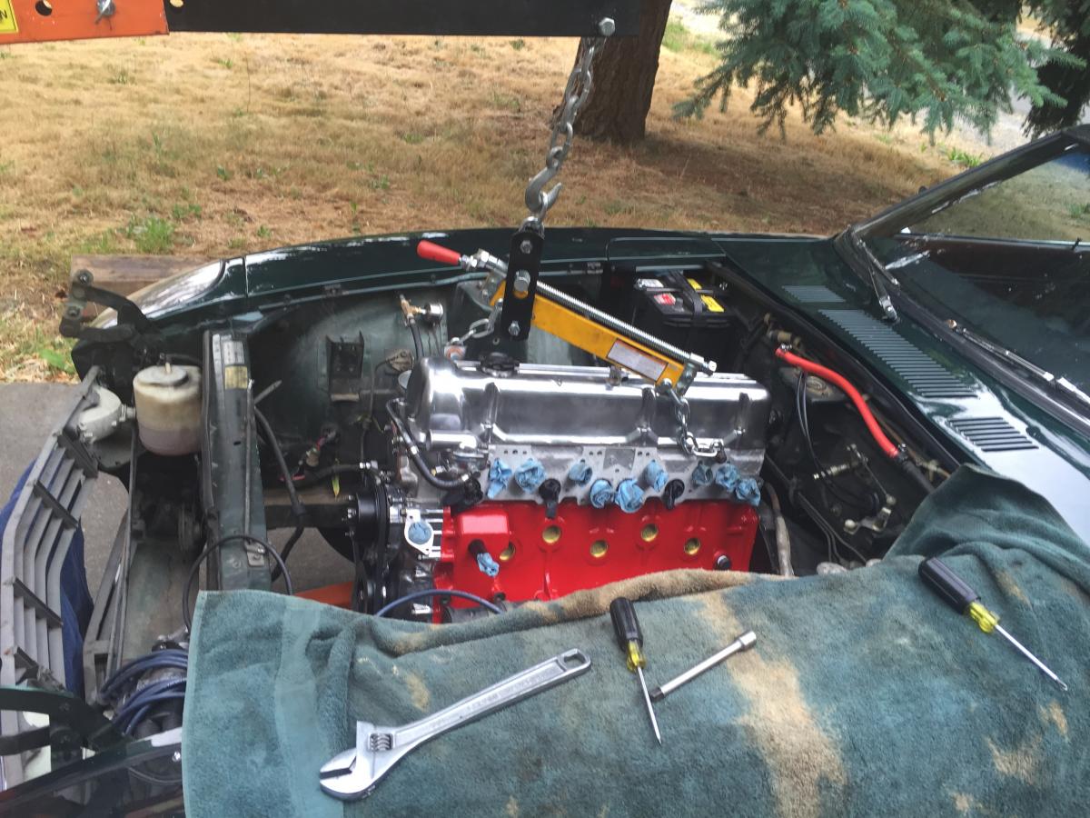

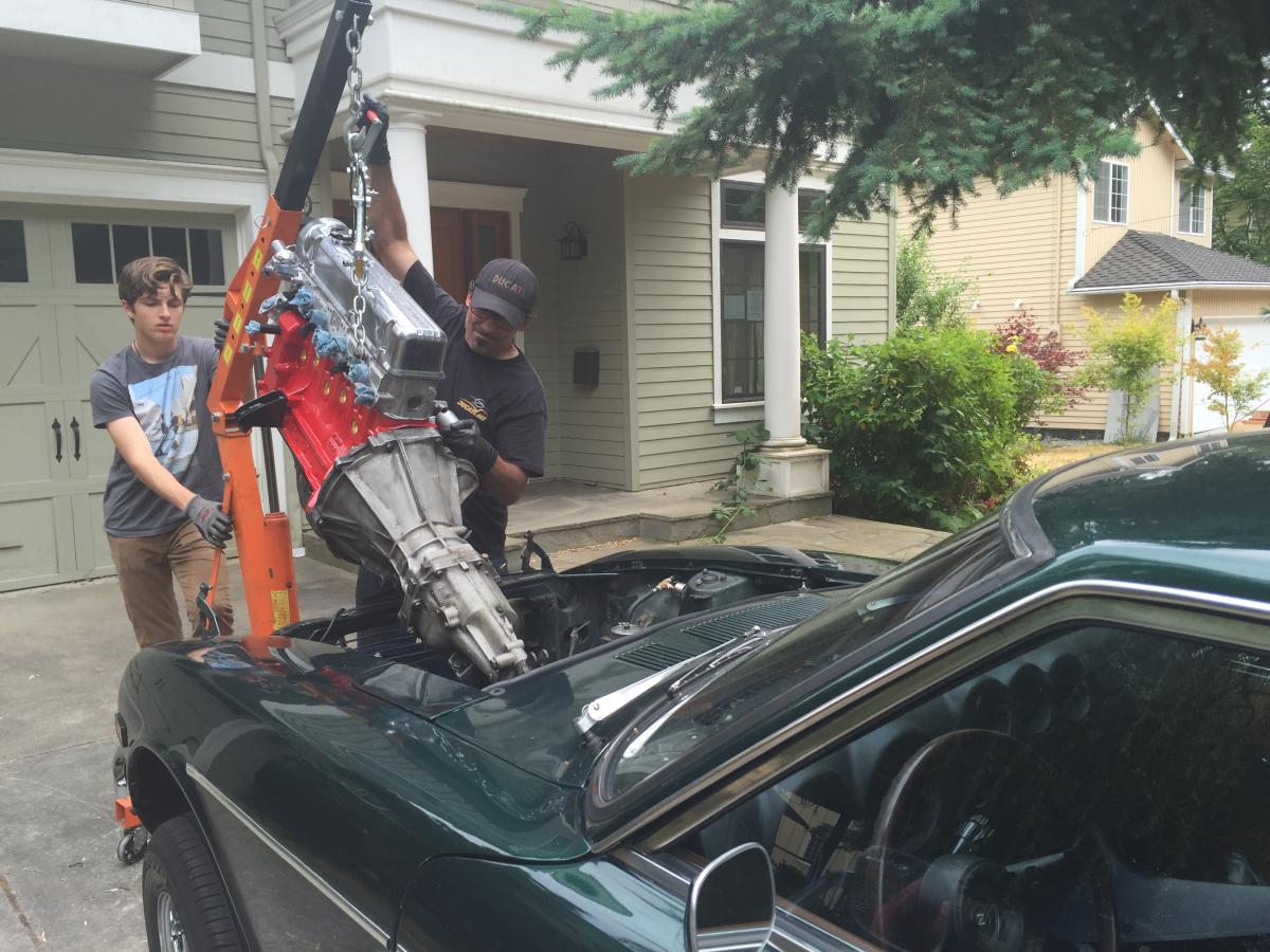

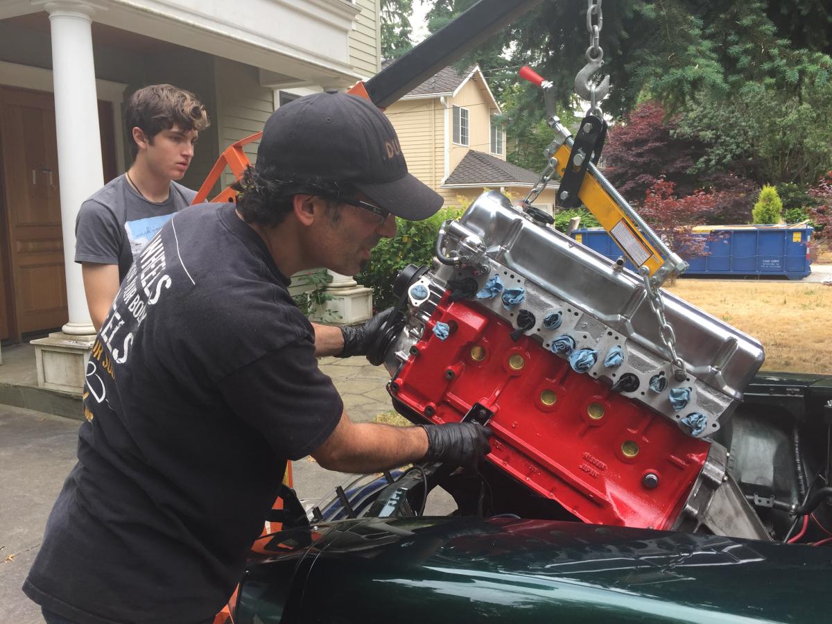

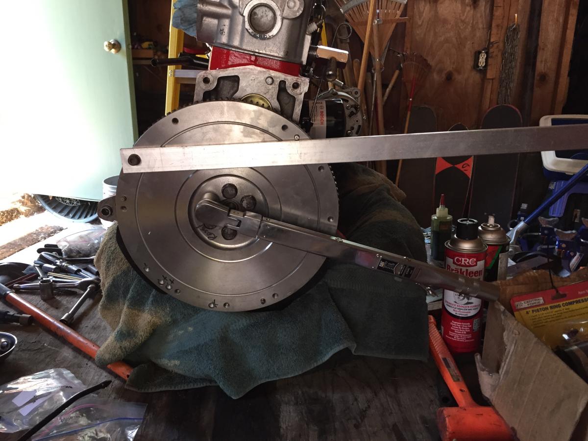

June 29, 20159 yr Author comment_472887 progress - getting closer. the original timing marker was set up for the much larger diameter pulley on the 3-row setup and the degree marks weren't accurate with the smaller single-row one i'm using. used a piston stop and degree wheel to nail TDC and fabbed up a single pointer out of a piece of sst band clamp. cam timing is pretty spot on, which makes me happy given the head shave and adjustments. replaced the front and rear seals on the 5-speed and got it all buttoned up, new flywheel & clutch mounted then mated up the tranny to the block. notched the speedo gear housing on the opposite side so i could flip it and make it work with the 5-speed. then it was the big day: yanked the old and dropped in the new. trickiest part was the fact that the hoist boom was a little short and wanted to hit the front bumper. a few new holes and i got an extra 9 inches on the boom (insert male enhancement joke) and all went well. i didn't want to remove the drive shaft, so i hung it from a wire and kept it at the right height. it actually worked and i was thrilled to get the new motor in, drive shaft into tranny and all the mounts installed. one thing i didn't notice until the new motor was installed is that the throwout arm is different - the 4-speed has a pin that comes out of the slave cylinder which fits into a dimple in the throwout arm. the 5-speed arm has a hole in it instead of a dimple... so the pin i have won't work. another little thing to figure out. setting timing cam gear tranny front seal & throwout bearing replacement locking the flywheel for torquing clutch installed hanging drive shaft old engine out ready for the transplant Link to comment https://www.classiczcars.com/forums/topic/50727-a-project-is-brewing/?&page=10#findComment-472887 Share on other sites More sharing options...
June 29, 20159 yr Author comment_472888 dropping in the new lump Link to comment https://www.classiczcars.com/forums/topic/50727-a-project-is-brewing/?&page=10#findComment-472888 Share on other sites More sharing options...
June 29, 20159 yr comment_472889 When I did my auto to 4 speed swap, I had to fab a piston, instead of the threaded rod on my slave cylinder as my 4spd had a dimple as well. My slave cylinder was made for the hole (Adjustable). Nailed the right length the first time, so i didn't have to fiddle with it too much. Another option would be to drill it out I guess. Link to comment https://www.classiczcars.com/forums/topic/50727-a-project-is-brewing/?&page=10#findComment-472889 Share on other sites More sharing options...
