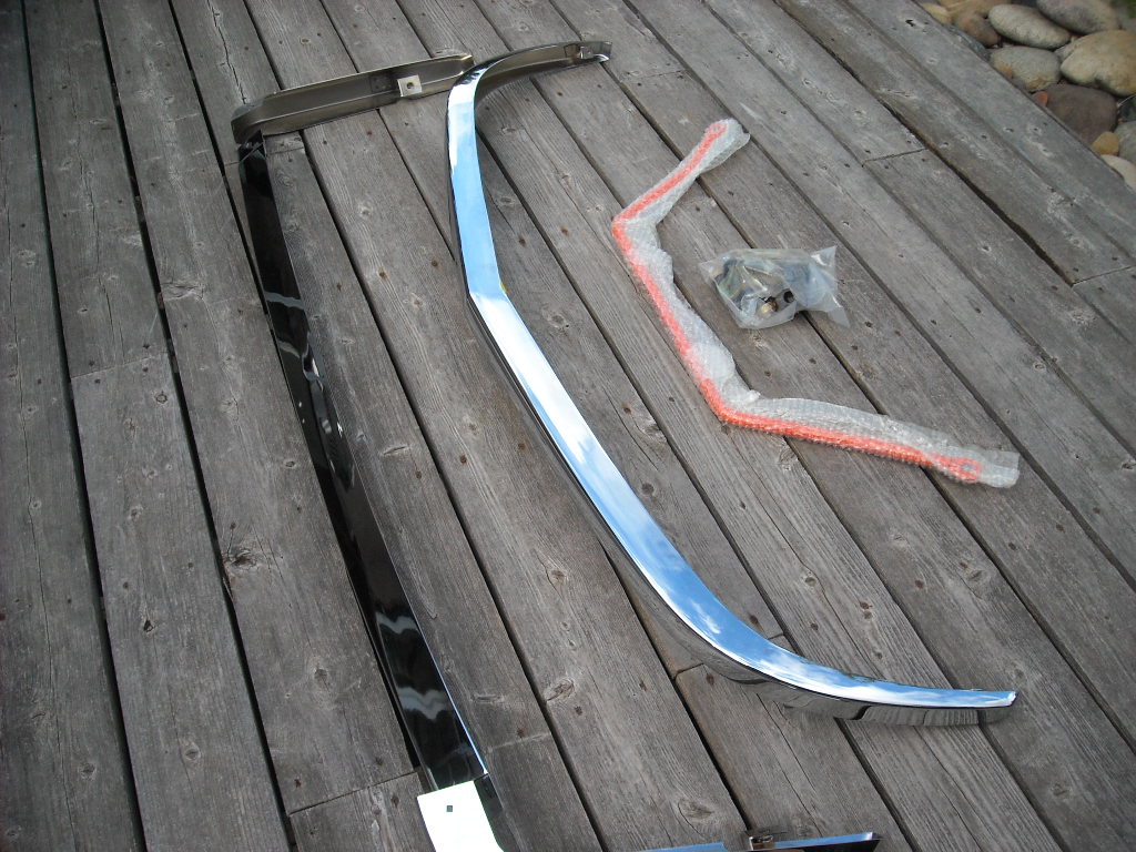

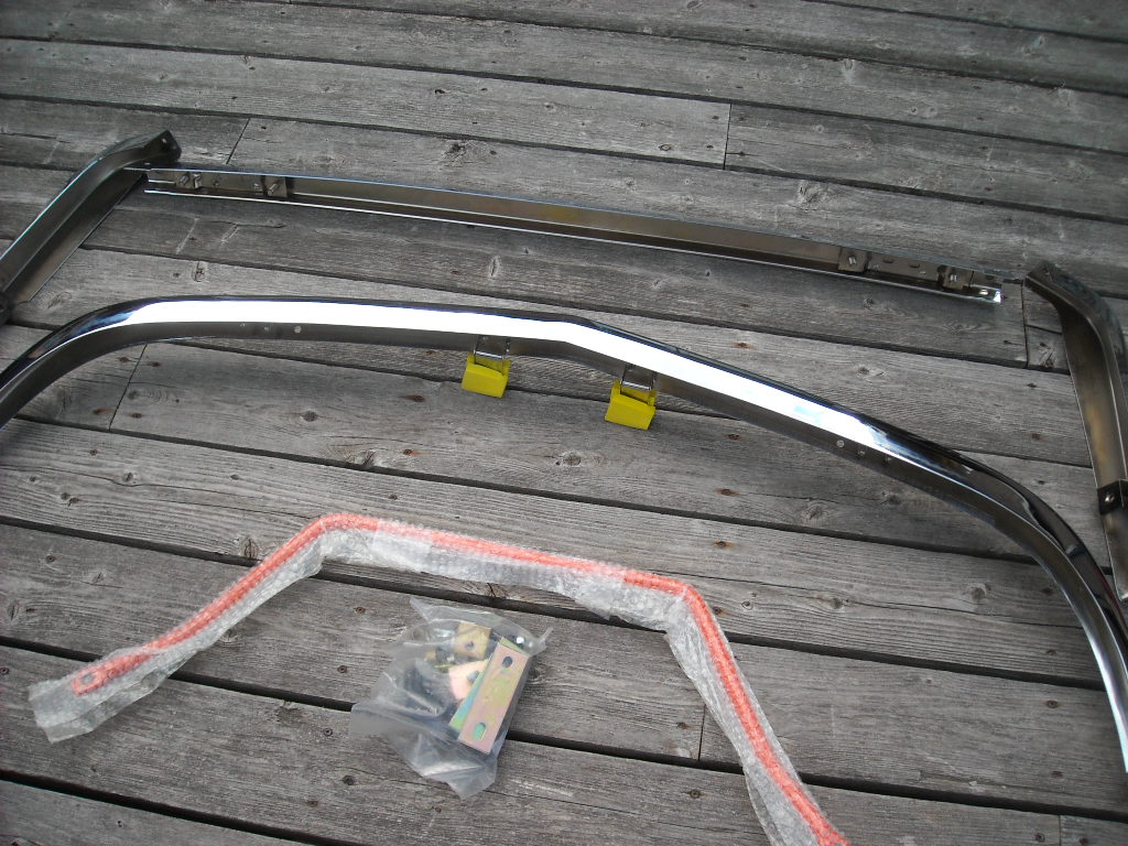

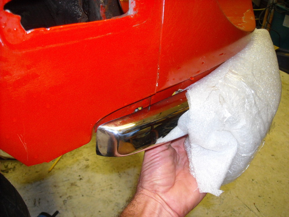

Well I guess I'm not that bad off then, my S/H was 52% of product cost. The thing I like the best about these bumpers are there are no holes for the rubber protective straps, just simple and clean.

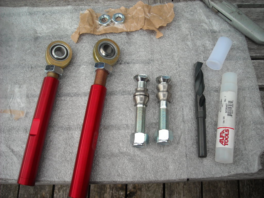

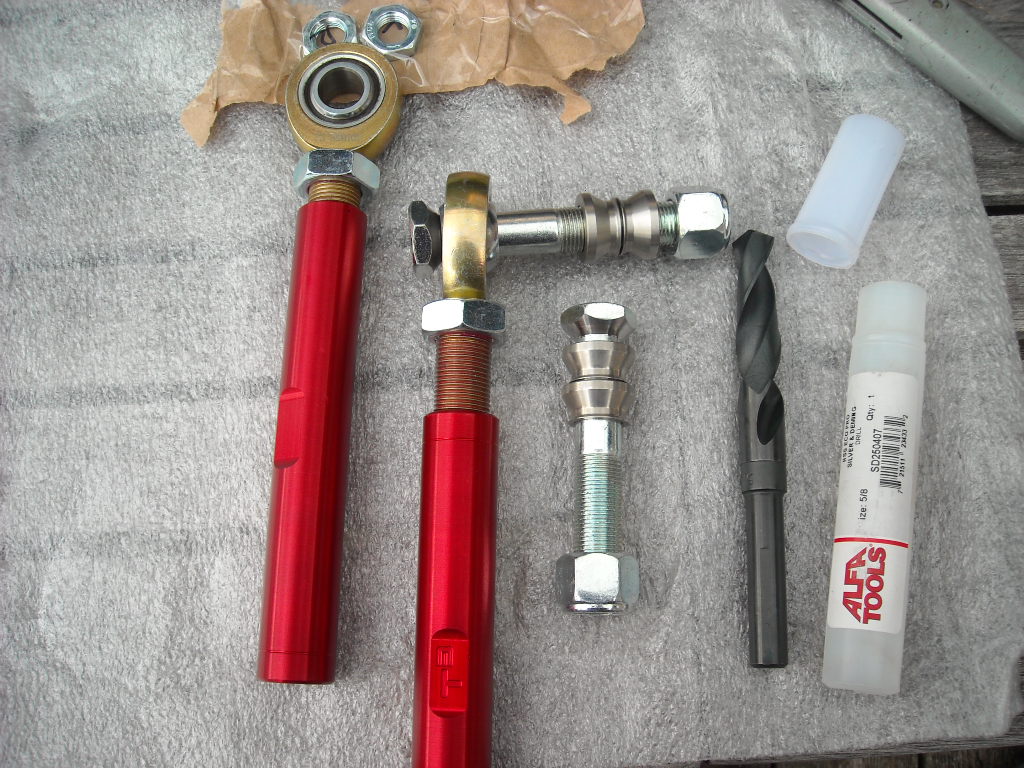

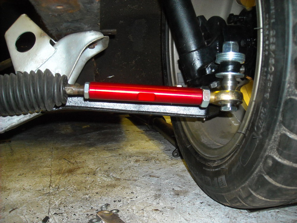

Got the TTT tie rods in and played with them so that the car can go from just a little higher than normal driving height, hit a bump and bottom out with 0 toe in or out. The strange thing is the D/S rod end is lowered 1.125" from the steering knuckle but the P/S had to be lowered 1.5" to get the same 0 reading.  If I lower the P/S the same amount as the D/S the P/S has 7mm of toe in.
The stack of washers under the lock nut is just so I don't have to cut into the fresh nylon of the lock nut until the final assembly.
Hi Chris, Looking good. I like your idea with the washers:cool:. Nylock nuts don't like being re-used and on the steering is not a good place to start.
You are probably going through the same thing we went through.
I think it might be in the alignment of the radius lower control arm versus the radius of the steering arm. The steering rack is not centered, a little to the left or right can cause this, so the inner steering swivels is not geometrically the same. Its hard to tell with the rubber accordian in place, but if you can losen one end and slide them to one side you can check if the rack is centered correctly.
Just because the steering wheel is centred, doesn't mean the rack is positioned central between the control arms. People often play with the steering wheel so the wheel is centred when driving down the road, but don't realise it can effect the steering geometry.

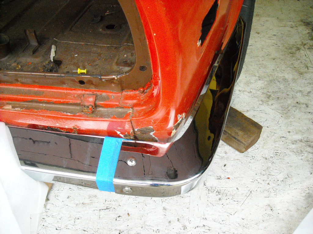

i hope those aren't the same bumpers i have been trying to fit on the gold car. the position of the side tabs on the rear bumper are not even close to the proper location, and they use stupid SAE hardware which makes using a ratchet impossible, and a wrench becomes a pain in the butt because of the increase in hex size.

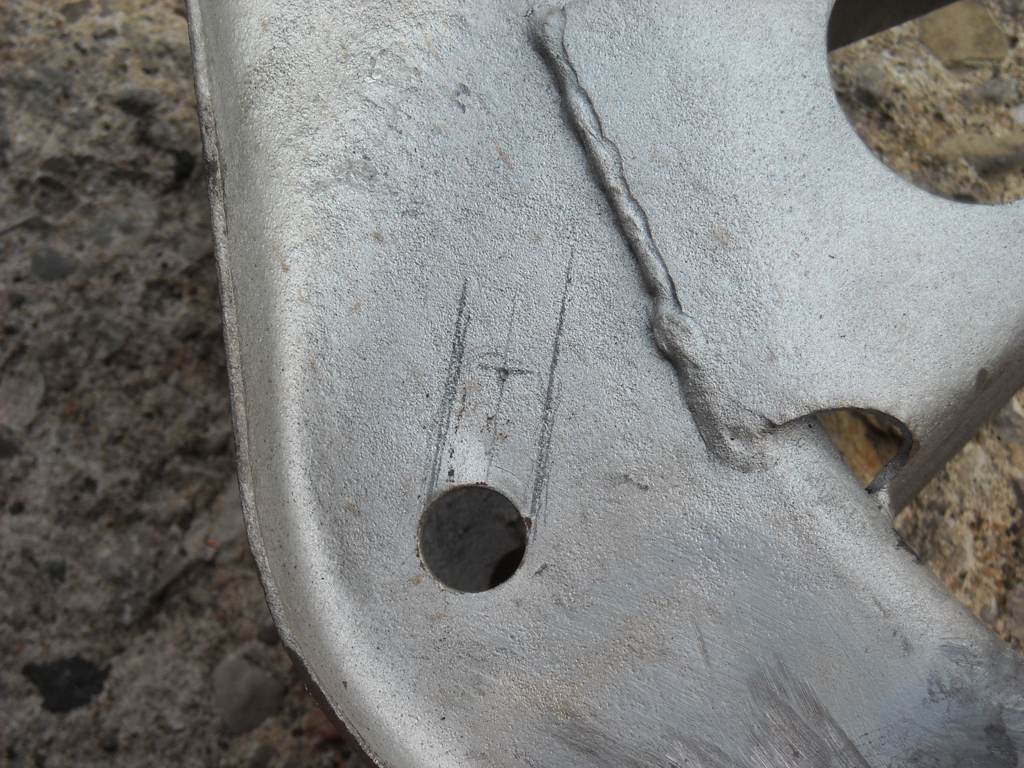

what did u do about the crack in the head?

I hope so too! I think I will pull them out of their protective cocoons today and try some test fitting, thanks for the heads up.

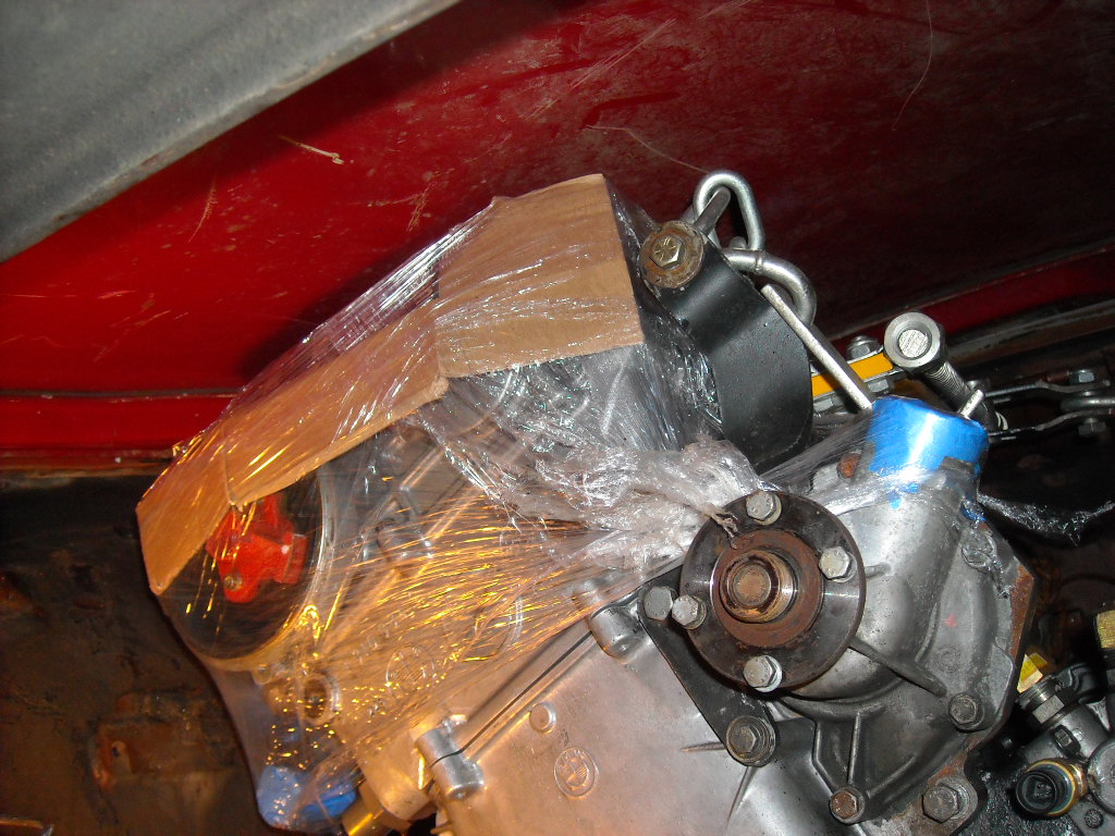

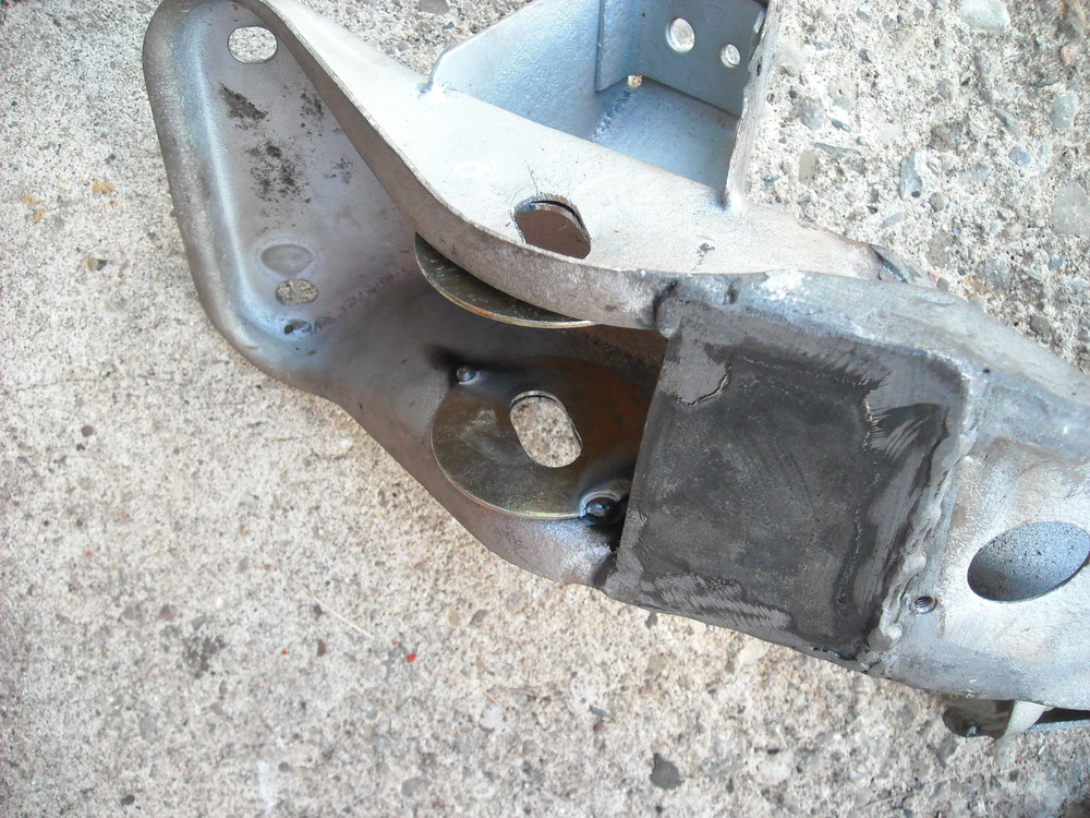

I have a guy coming to my place with a portable tig unit to seal it up, he was suppose to call this week but nothing yet so I have moved ahead finally and got the engine sitting in the car.  Just  starting to play with engine mount/tranny mount designs. I have about 1/2" clearance from the top of the engine to the hood which is okay I guess but I would like more, so time to rearrange the furniture again without screwing up the toe in/out.

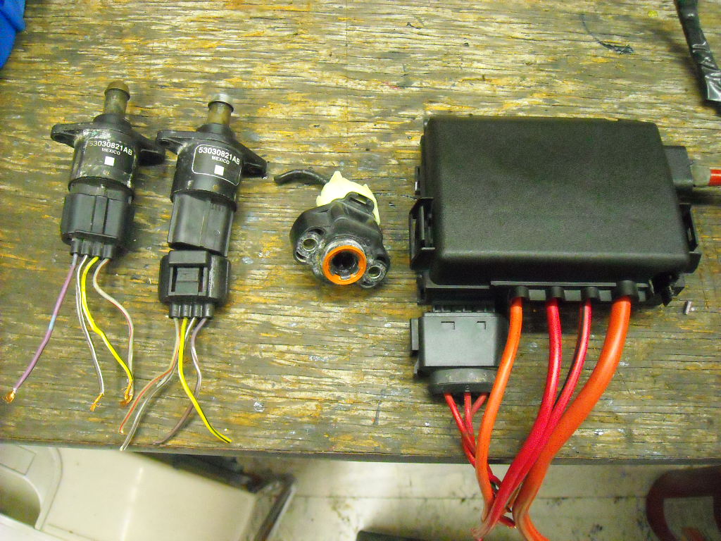

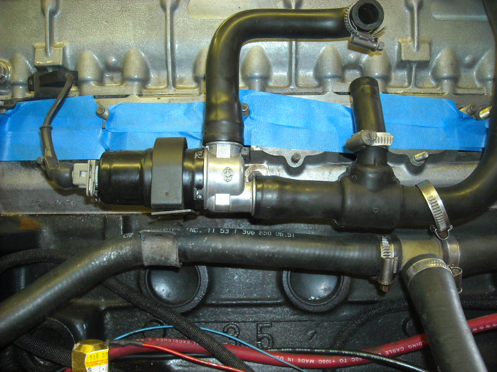

Here is the stock bmw on/off idle control valve that Matt the MS tuner wants me to replace,

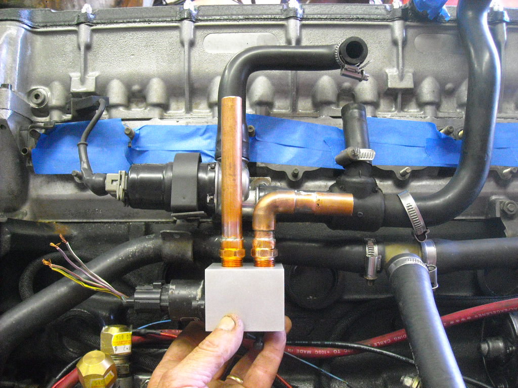

DSCN0524.JPG Here is the new stepper motor version that will replace it, not as sleek looking but it is completely hidden and it works well,
looks like all she needs is a weatherpak connector and she's good to go.
1/2" hood clearance should be more than enough with poly engine mounts.
if Monsieur TIG doesn't make it there, you are still welcome to the DuraFix aluminum rod!

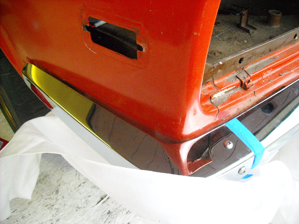

Well I'm relieved to say that FutoFab's bumpers not only look great but they also fit very well and have the correct metric attachments. I just placed the fenders on with no screws and it all lined up well, Dave Patten the owner is also a good guy to deal with, very professional.
