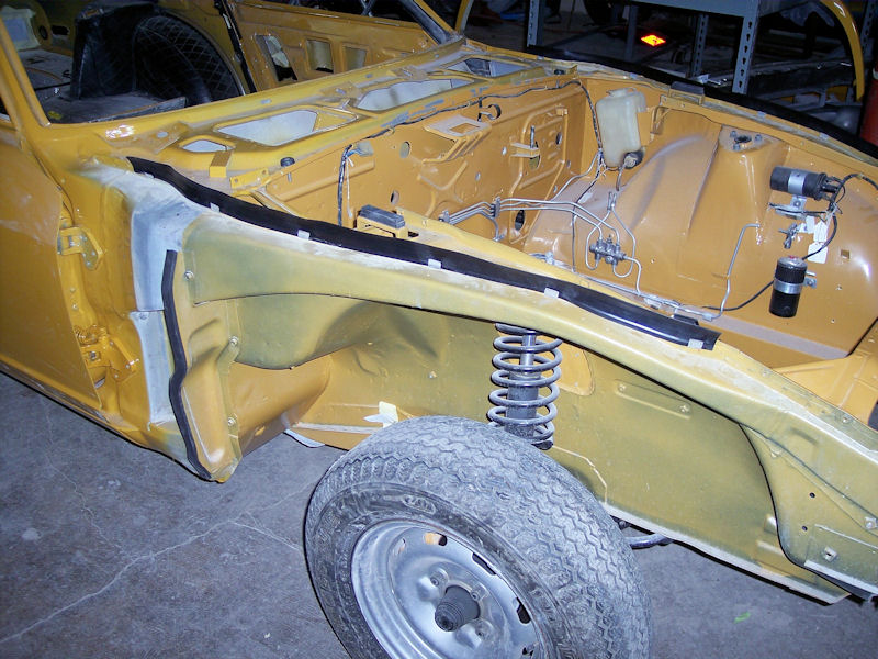

Is this the fender seal you are looking for? I bought these from Black Dragon a few years ago - about $40 + shipping. They use a "S" clip to attach to the weld ridge.
There is a rubber cushion or pad in that area, also available from BD if you don't want to make your own. I used high-density foam weatherstrip material for that pad.

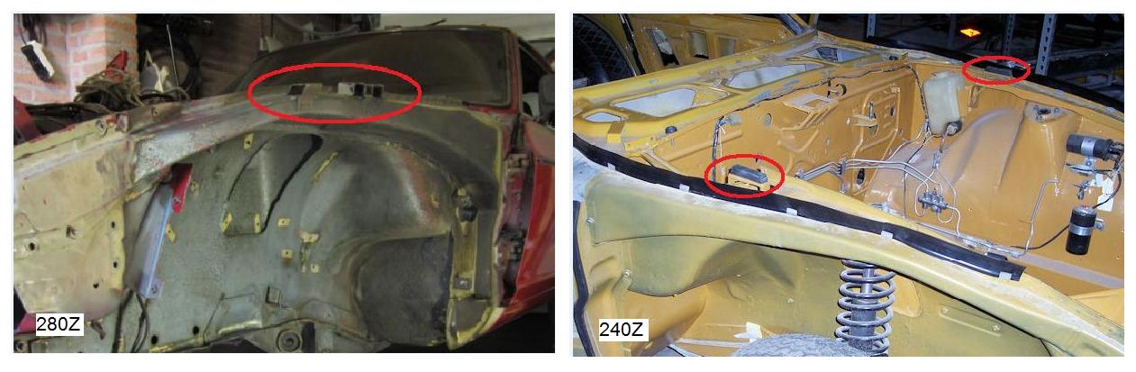

Hi Jim,
I think they changed the design somewhere between the 240Z and the 280Z. I browsed through my photo's, but couldn't find anything on the rubber. I did find some photo's showing the difference between your fender supports and the 280Z. The 240Z has one that I can see and the 280Z has three. See photo's. Hope you don't mind me using your photo.

Hi Chas,
Photos are there to be used, glad mine could help explain the differences. Quite possibly Nissan learned about the fender tops getting deformed from casual pressure and changed the support pad locations and number. The weatherstrip I used was probably about 5/16" thick and 3/4" wide. If I recall correctly I double-stacked it to get good support under the fender. The weatherstrip was adhesive backed. Even BD fails to show the 280Z version correctly.
