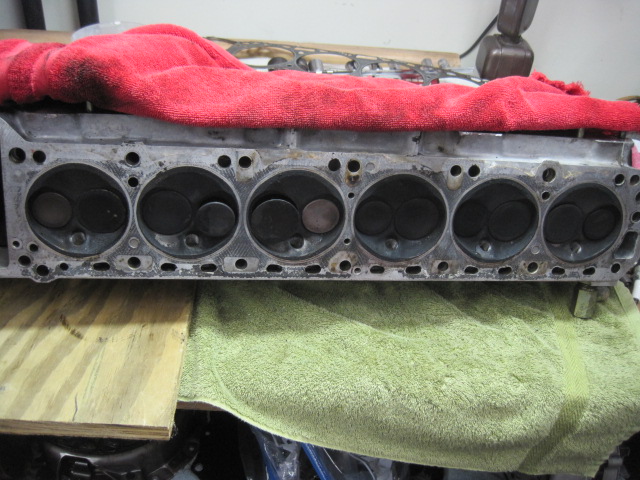

Well after walking away for a while I am back with sockets in hand. The engine is coming apart. The head is off to check HG and internals. I'd say I have a definite oil issue with combustion. Not sure if it's guides or seals but certain cylinders have that oil sheen to them. #4 is pretty bad with the top of the piston covered in a nice black oily paint. # 2 cylinder intake valve is grungy ( baked on oil?) on the back side of the valve. Head is going to the machinist
The head is in the machinist hands now. He agreed that he didn't like what he saw at initial look. Valves coming out as we speak to check guides and seats. Kind of anxious for the diagnosis.

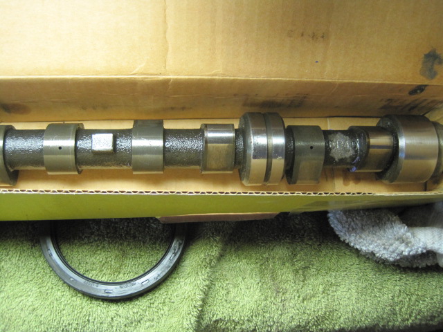

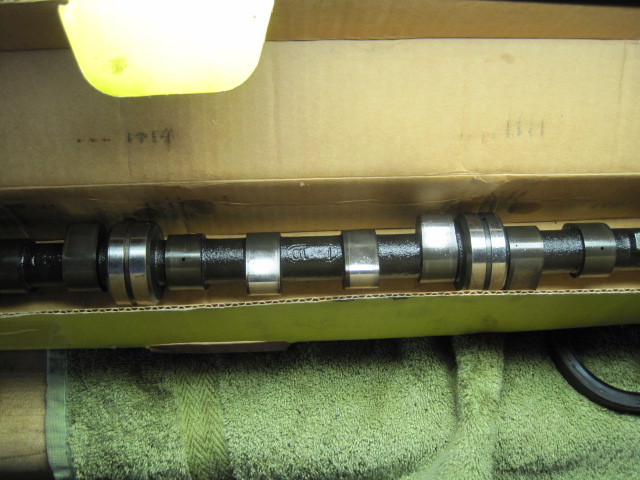

Talked to Kevin Cantrell at Schnedier cams and he said he would inspect my cam at no charge to check for any issues caused by my rockers.
He said the rockers come from a MSA supplier when you order his cam kits- and they are no longer Nissans. He did say if a regrind was necessary he would do that at cost- whatever that entails. Hell- I might just go bigger anyway!!

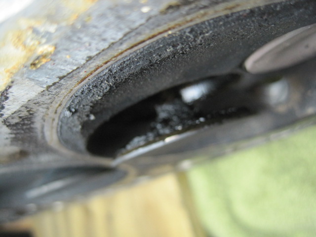

Some pics of what I have been seeing. The cam looked good but it is still at Schneiders for evaluation. You can see the build up on the back of my valves. looks more like 100k mile engine then a 10k engine. Lots of soot everywhere. The engine builder questioned my PCV system right away.
Looks like I will be replacing valves and guides minimum.
I still have no cause for high oil pressure, but I haven't plastigauged bearings or examined oil pump. Right now I am cleaning all the soot off the pistons tops and examining things there.
Re: deposits on valves....Were you loosing oil?
Did the valve seals have enough clearance from the valve spring retainer when the spring was at maximum compression?
They weren't stock seals, but seals that were recommended for a higher lift cam.
Not enough to tell if i was.
