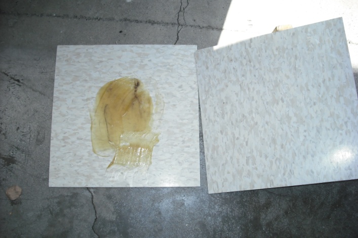

When you have an alignment done at a shop, their Hunter machines have bearing plates under each tire that allow the adjustments to be made with minimal friction. One way I've seen this done at home is to use two 12x12" vinyl floor tiles under each tire. Put some wheel bearing grease between the tiles and they form a poor man's bearing plate, allowing the tire to slide around relative to the floor when alignment settings are changed.
Pic courtesy of Google:

And Brian/bacarl, I tried your greased vinyl tiles idea last night. Slick!!! (pun totally intended) It's a lubricating, rotating miracle! All for 4x 89 cents! It also allows the tires to settle outward as well after jacking the car up without rolling the car around. just put it down, steer right/left a few times and everything slides into perfect static position.
