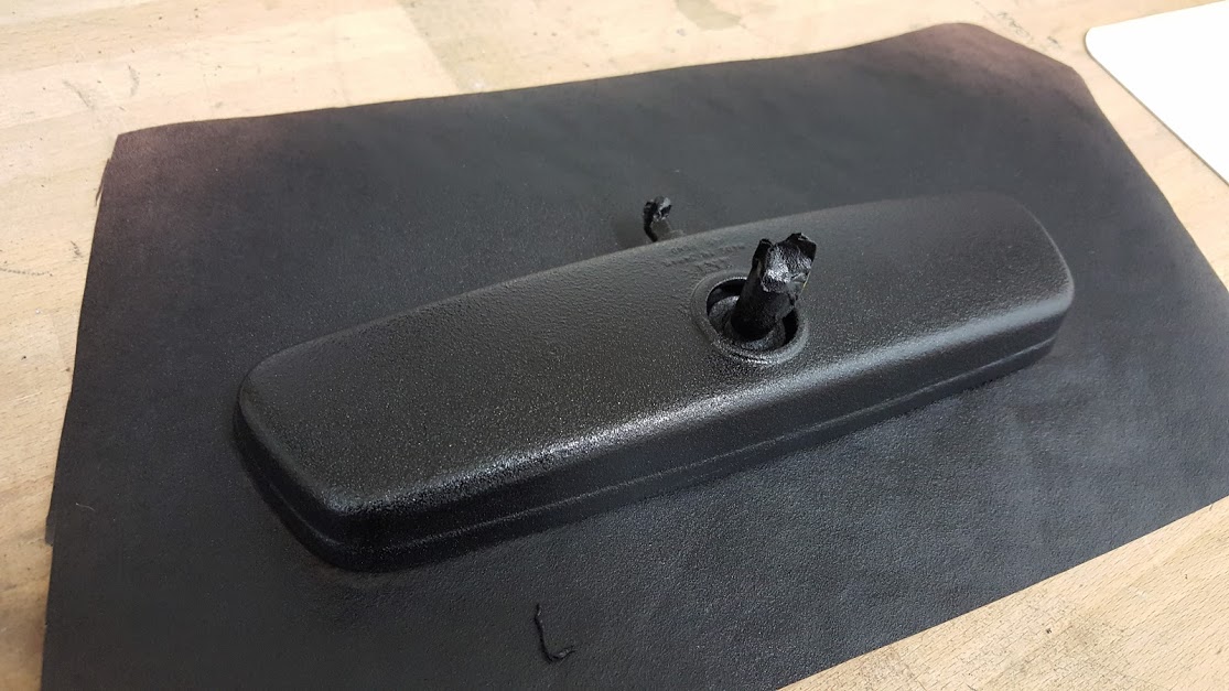

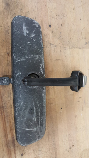

Fixed up my rear view mirror. I sanded it down and used the same bedliner spray that I used on my dash. I think it turned out pretty good.

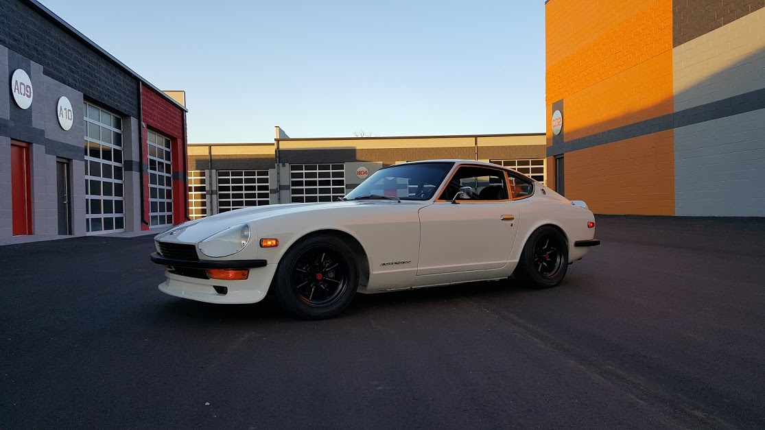

I also got my brakes dialed in. They were professionally bled and the rear drums needed some adjustment. I was able to sneak some under skirt shots too. :D
