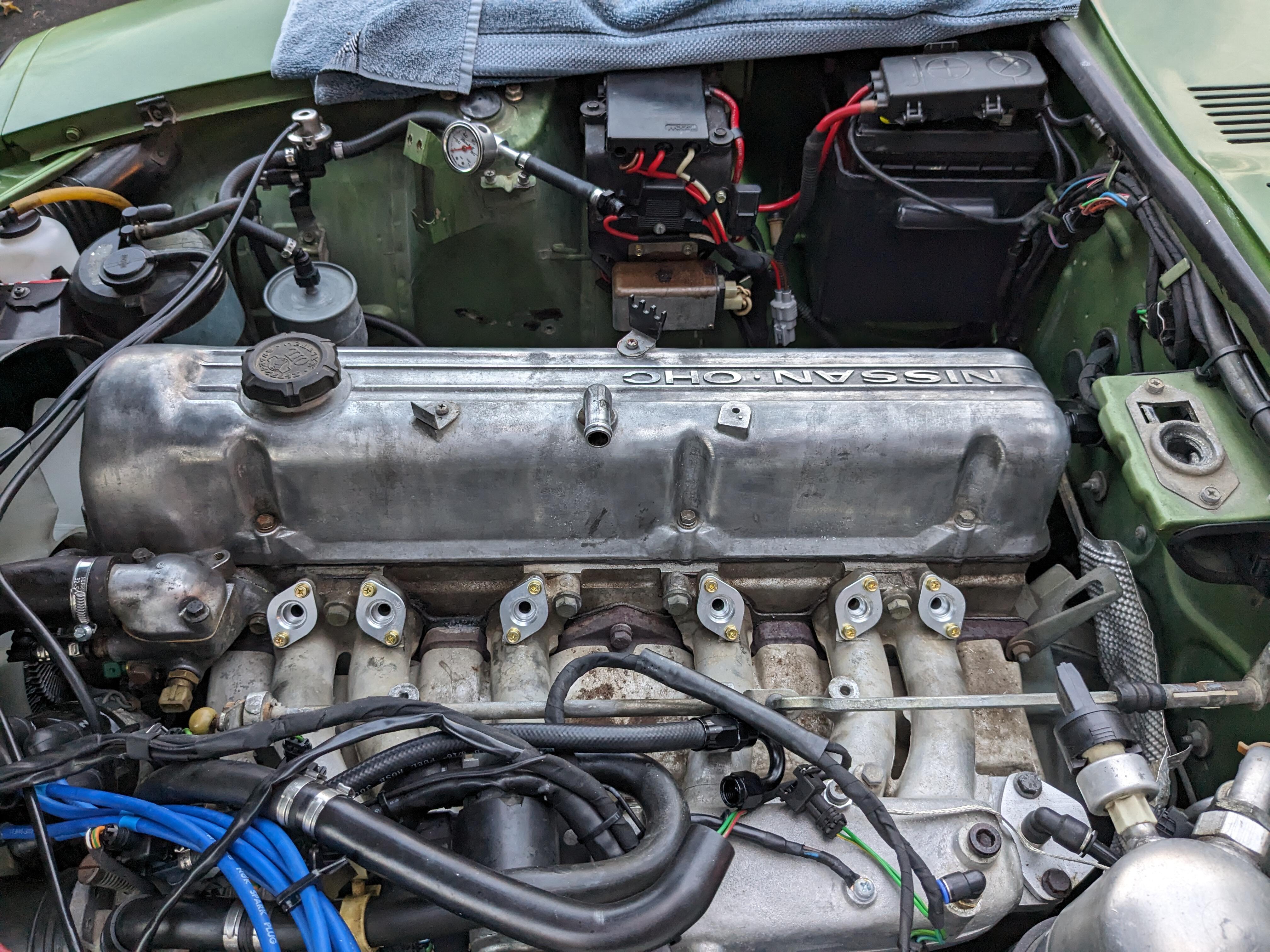

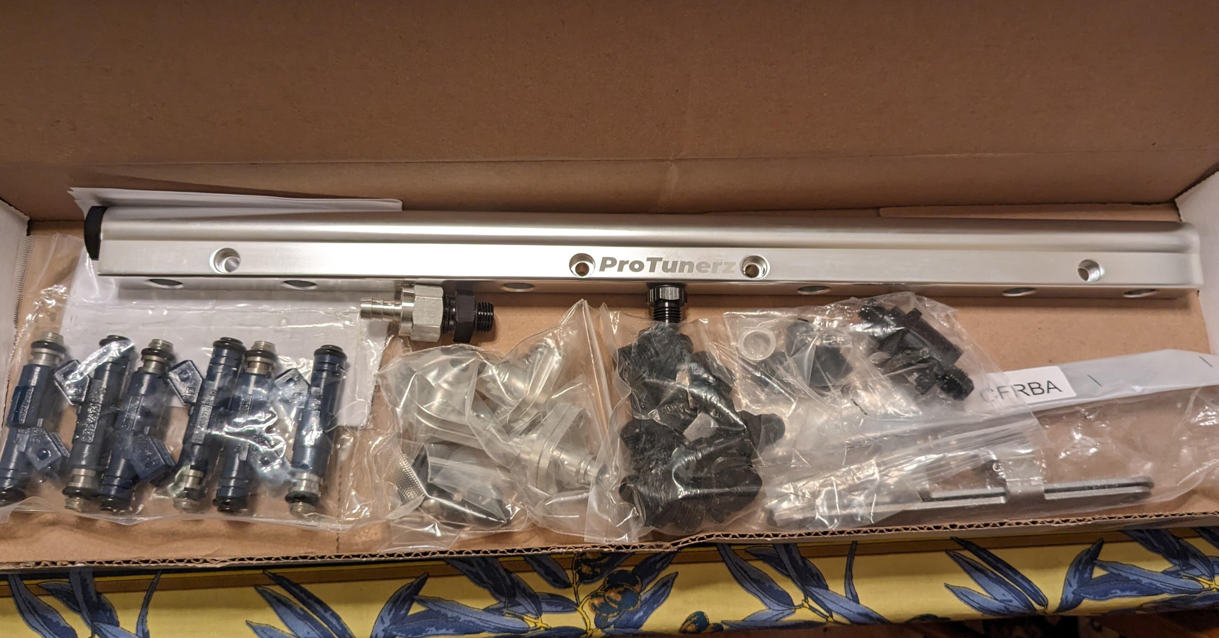

HusseinHolland Posted November 13, 2023 Share #42 Posted November 13, 2023 Been out of town since Wednesday - before that, I had the heat soak issue even though the ambient temps were in the 40's-50's. I'm going to make a heat shield, however since I have to remove the rail again, I decided to get newer injectors & a billet rail, and just get rid of all those thin metal tube rails. These came while I was away ProtunerZ rail & injector seat adaptors, 19.4lb/hr Bosch injectors 0280155712 (GM, Saab application) 2 Link to comment Share on other sites More sharing options...

Captain Obvious Posted November 13, 2023 Share #45 Posted November 13, 2023 13 hours ago, HusseinHolland said: ProtunerZ rail & injector seat adaptors, 19.4lb/hr Bosch injectors 0280155712 (GM, Saab application) How does the flowrate of those new injectors compare to the originals? I did a very little looking around a while ago and it seems the originals are low flow compared to most of the newer stuff. Link to comment Share on other sites More sharing options...

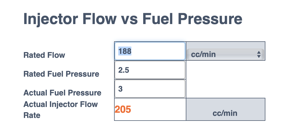

HusseinHolland Posted November 14, 2023 Share #46 Posted November 14, 2023 (edited) 10 hours ago, Captain Obvious said: How does the flowrate of those new injectors compare to the originals? I did a very little looking around a while ago and it seems the originals are low flow compared to most of the newer stuff. We had a conversation on this - I had to look around to find it - it was in the FPR thread Stock are 17.9lb/hr - 188cc @2.5bar - which translates into around 19lb/hr @ 3bar - so I bought 19.4lb/hr - 205cc. Edited November 14, 2023 by HusseinHolland Link to comment Share on other sites More sharing options...

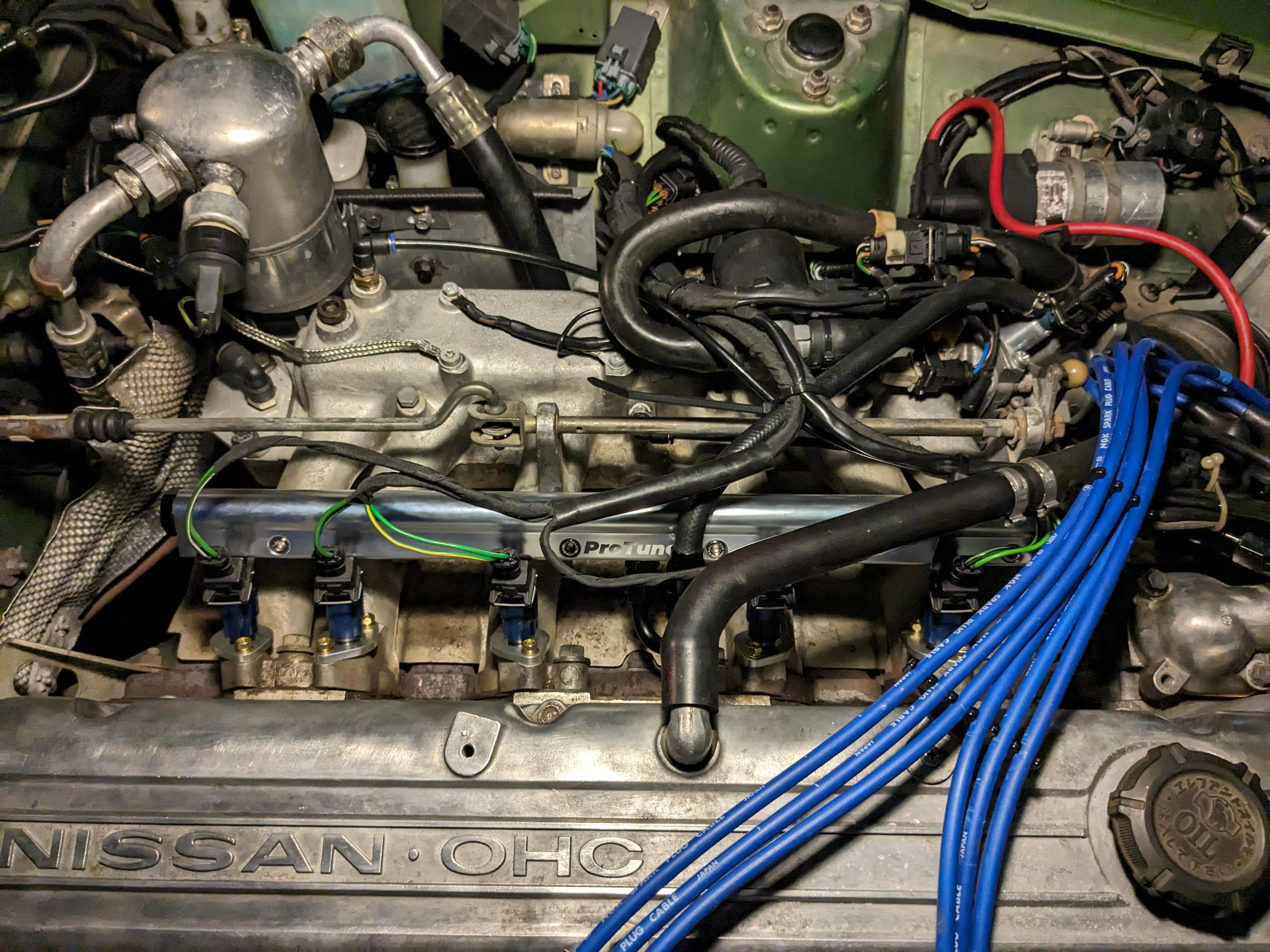

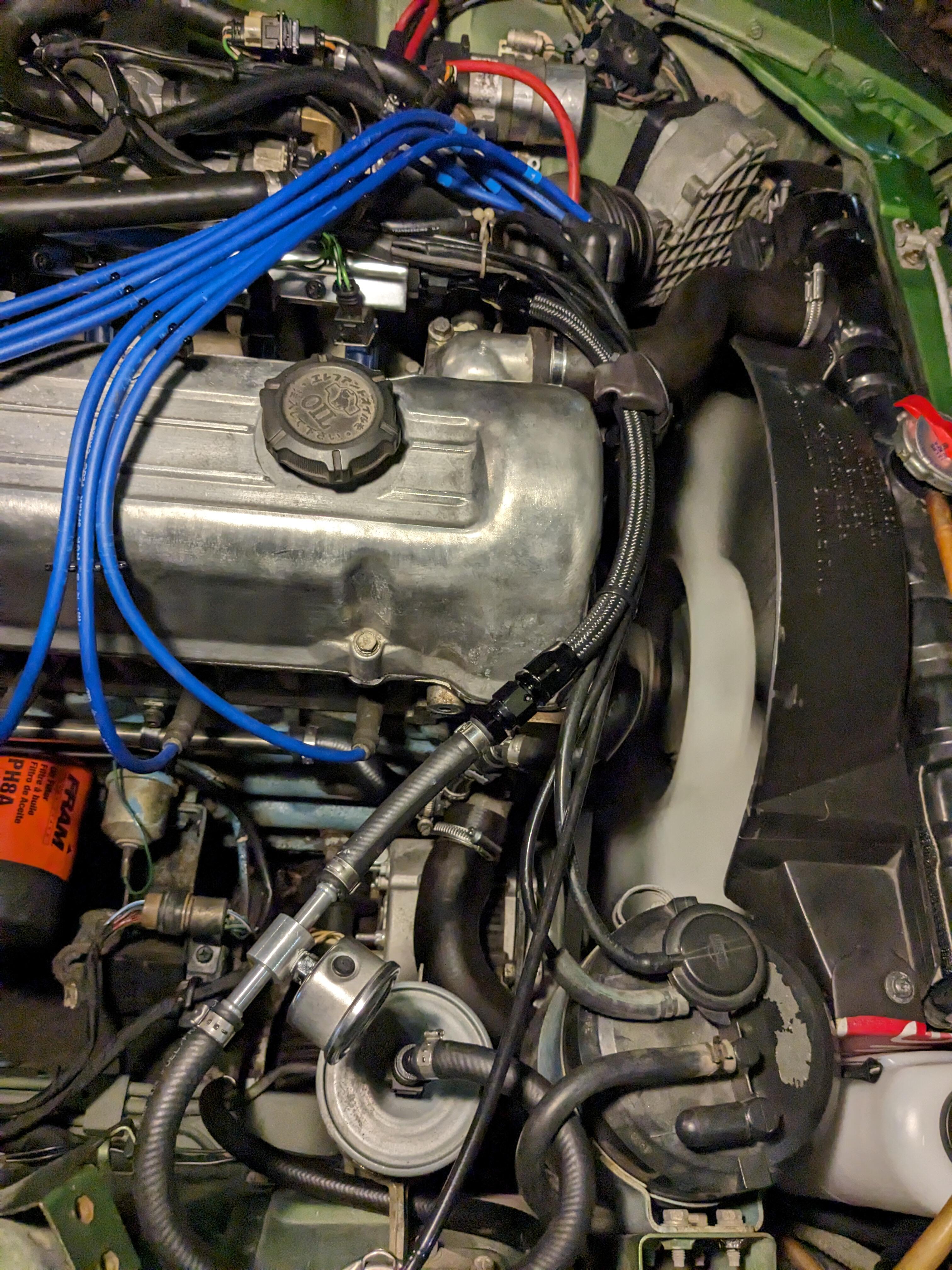

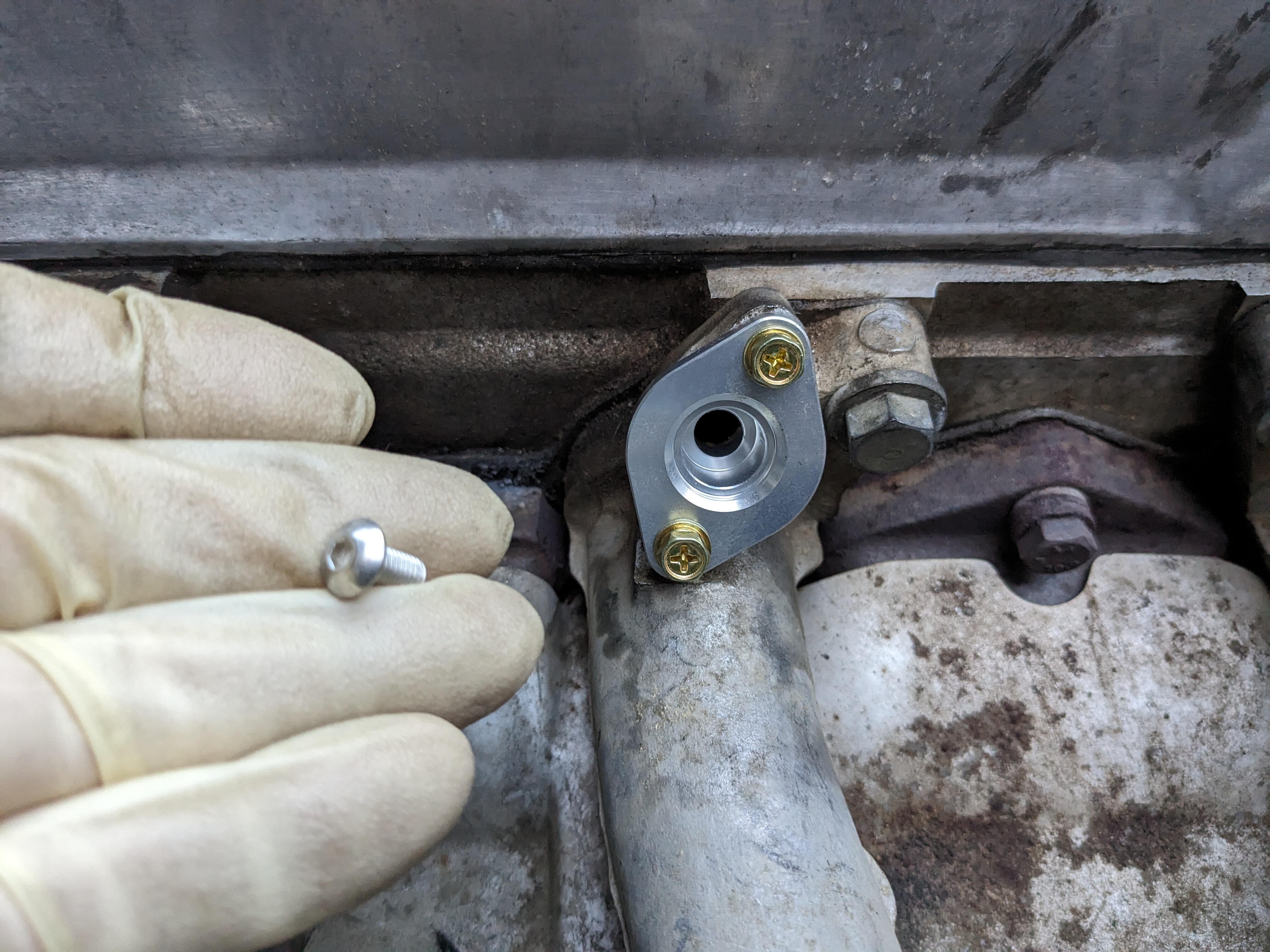

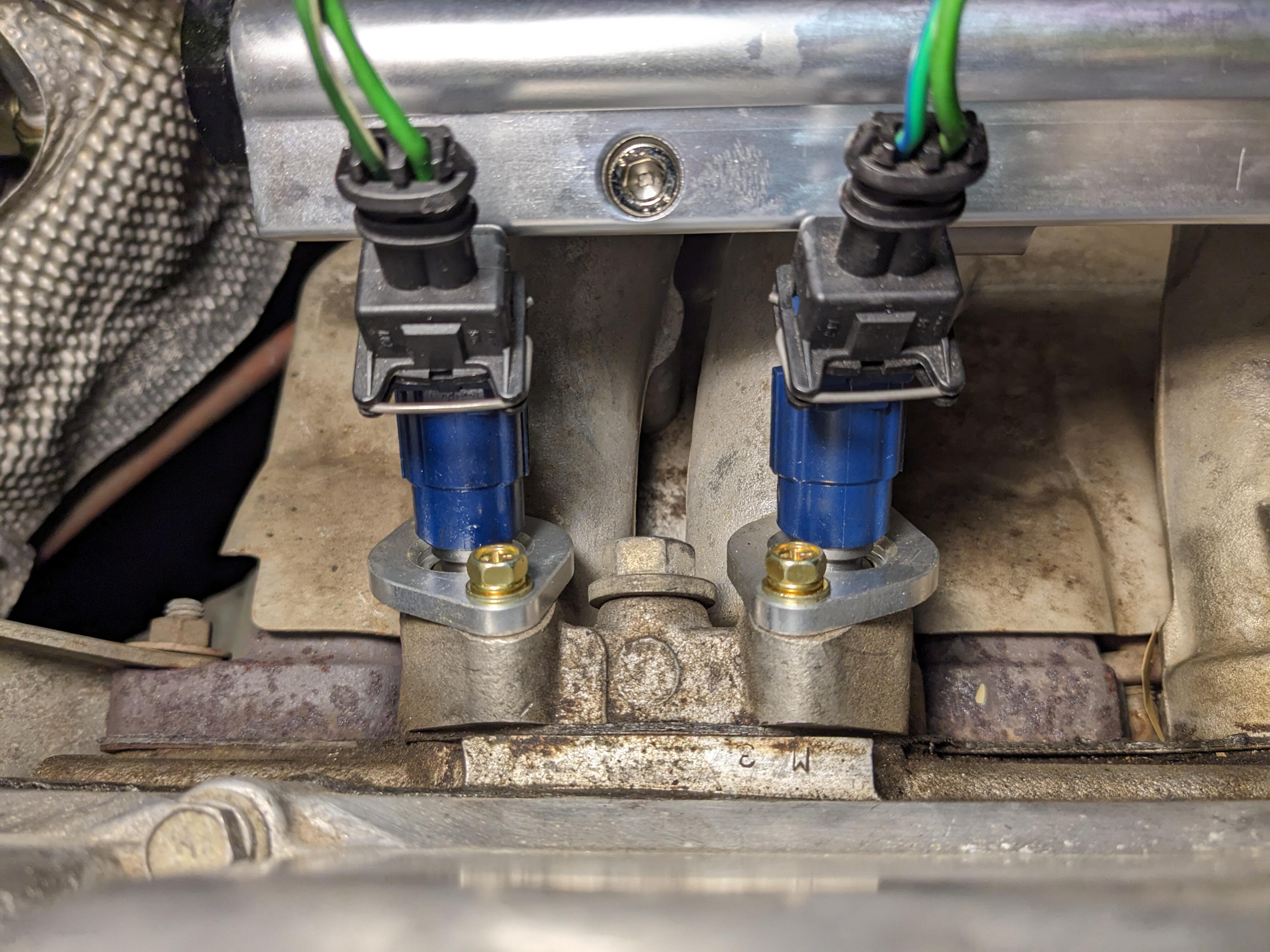

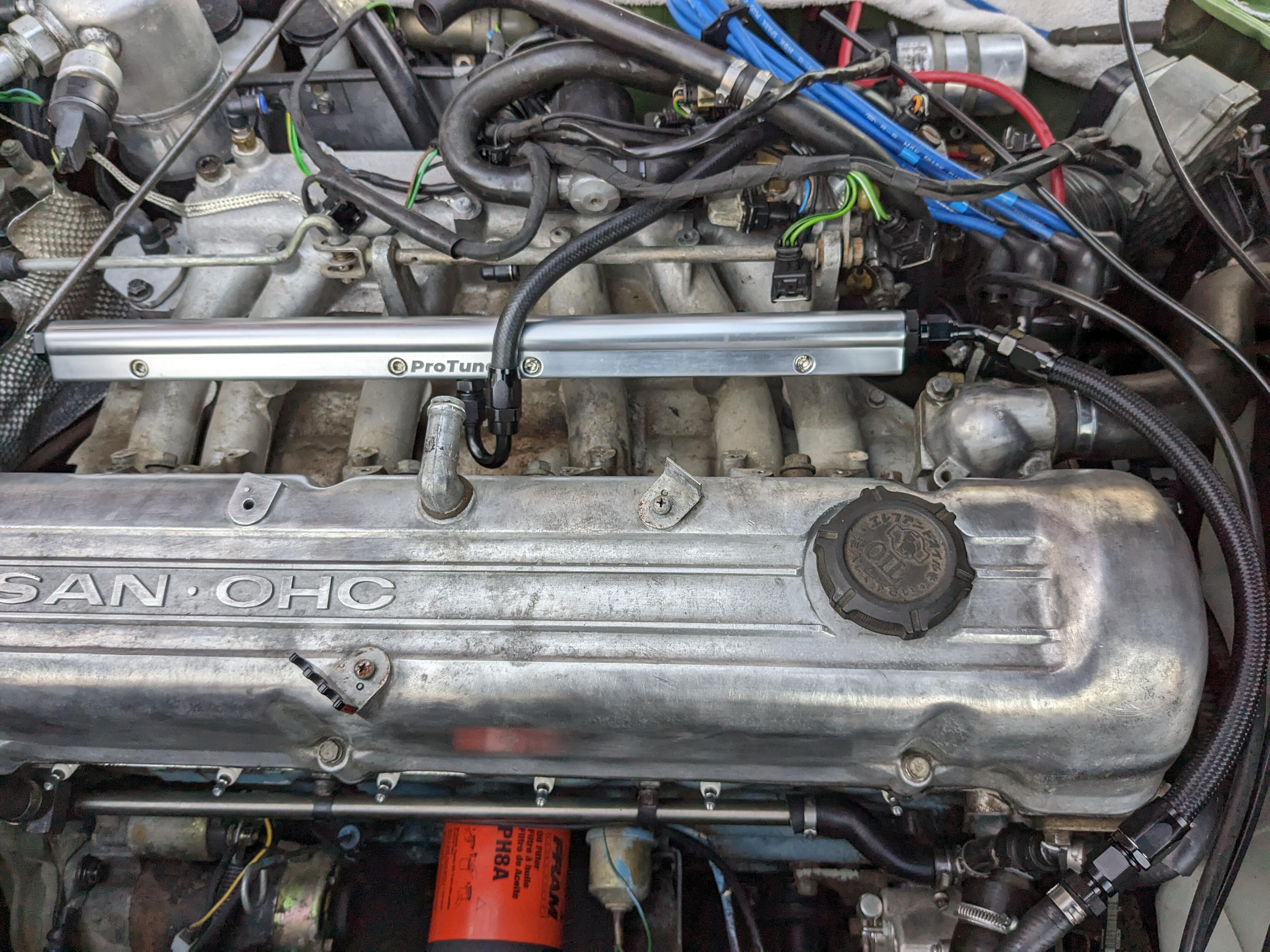

HusseinHolland Posted November 14, 2023 Share #47 Posted November 14, 2023 (edited) Test fitting the ProtunerZ rail & adaptors, made a new section of fuel feed using 6AN braided hose, and a 6AN U-bend to feed the CSV Adaptors came with SS Allen head screws, I don't like them. So, I used coated Sems screws Bosch 0280155712 205cc Added a support off the stock forward head mount point Back together & running. I'm working on a heat shield template. Edited November 14, 2023 by HusseinHolland Link to comment Share on other sites More sharing options...

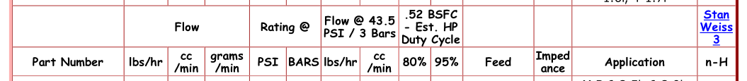

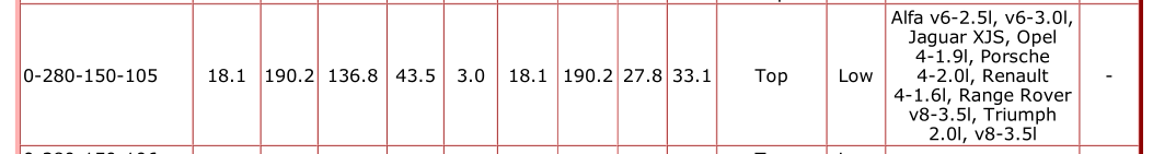

Zed Head Posted November 14, 2023 Author Share #48 Posted November 14, 2023 Here's a link to a table I had found a while ago. The original web page seems down but the table exists in various forms. 028-150-105 seems to be the standard Bosch original form replacement for the Nissan analog. In those early days they gave different part numbers based on hose length. I think that up to -112 are the same basic injector. It downloads a pdf file. Those 712's are high impedance. You'll want to remove the dropping resistors, I'd guess. Although I ran high impedance on my engine and they worked fine either way. Looks like you might be a hair rich with those. Good luck. https://alfaclubvic.org.au/forum/index.php?action=dlattach;topic=13145.0;attach=28987 and https://www.google.com/search?q=stanweiss+injector Link to comment Share on other sites More sharing options...
