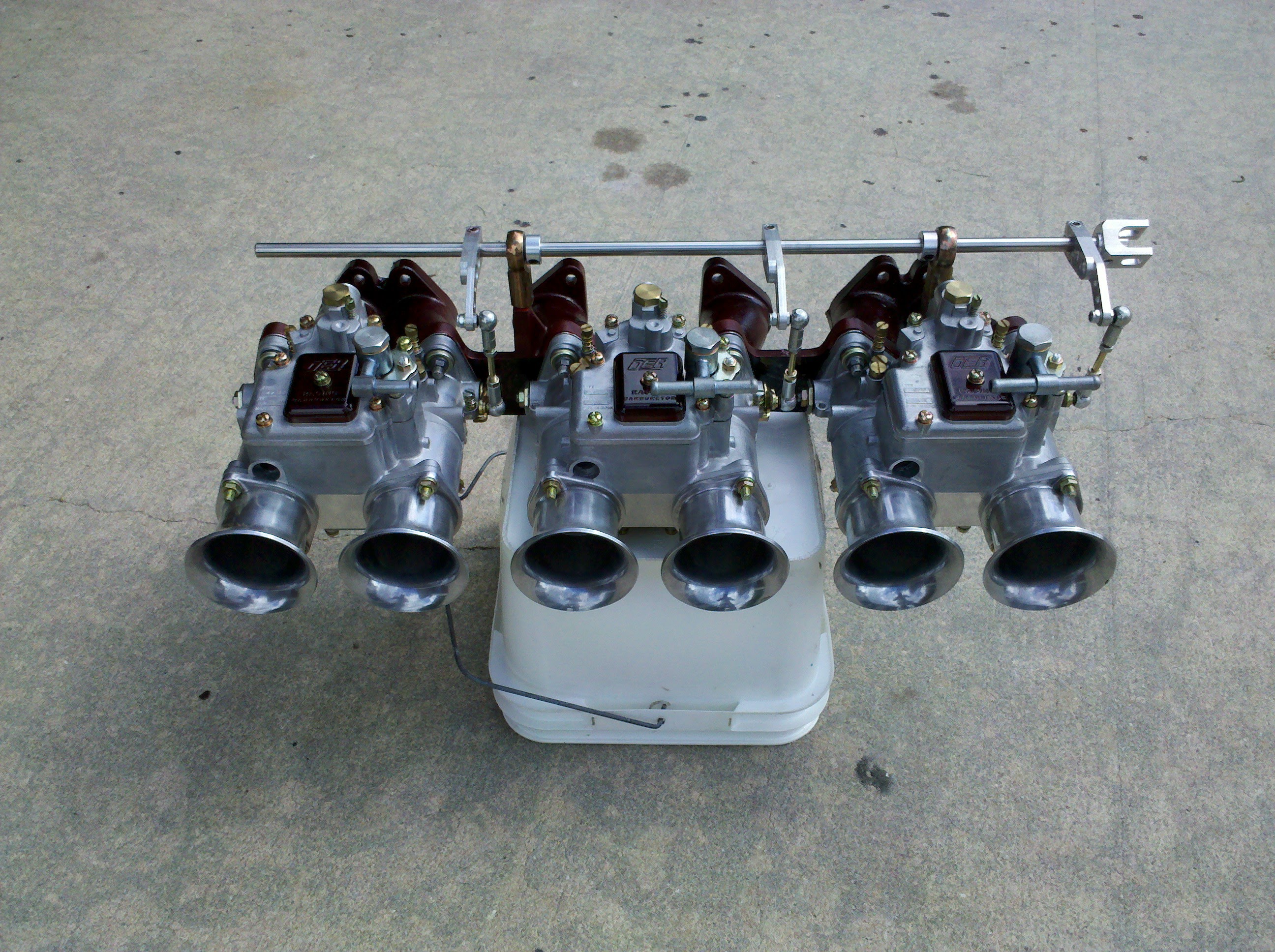

On July 22, 2016 at 3:38 PM, Zed Head said:
Actually, in the picture, the stock linkage does look a bit contorted, from the firewall to the carbs.  Does it move freely like that?
Moves just fine. Haven't had any issues with it.
