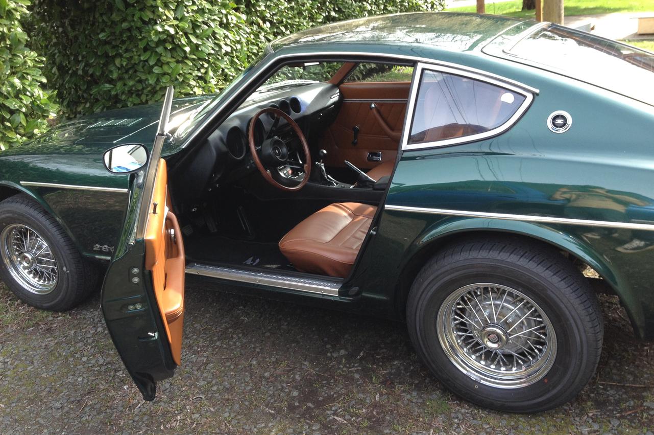

I gutted it to the pans, wire wheeled to bare metal as needed, Eastwing Rust Encapsulator paint, Hush-Mat sound deadener, re-wired the primary system, swapping the fusible links (rotted out) with Maxi-Fuse blocks mounted inside the cabin on the passenger side, also relocated all the relays from the engine bay to an aluminum bar mounted inside under the HVAC fan. Replaced all the heater hoses, inside and out, all new radiator hoses, new thermostat, flushed system (several times - lots of rusty water), blanked off EGR valve (broken base, frozen up) new FI lines throughout, new fuel filter back between the tank & pump, new E-brake cable (broken), new halogen headlights + lense covers, re-upholstered the seats (splurged on seat heater kit!) new headliner, tore out and cleaned up all the interior bits, new carpet + floor mats, new door/window seals, new hatch seals, new power antenna (broken), new stereo + speaker boxes in back, tossed the spare tire and lowered the rear deck down to pick up some add'l cargo space, capped the dash, new brighter gauge lights, new console, new rubber shifter inner boots, new leather outer boot, re-finished 240z woodgrain steering wheel, pulled the bumpers, new JDM front 240z bumper on custom brackets, new rear hatch struts (old ones were gutless), new battery tray and leads, re-wired all the injectors, new PCV valve + hose & heat wrap, new plugs, K&N intake, stripped & polished the SST wiper arms, along with a whole lot of little details I can't even remember at this point...

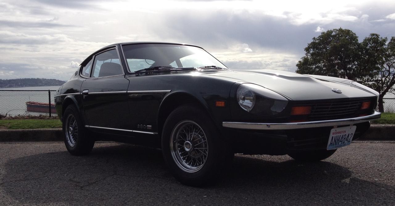

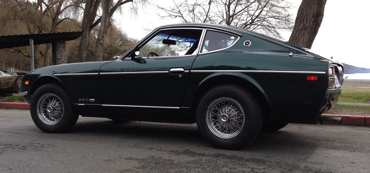

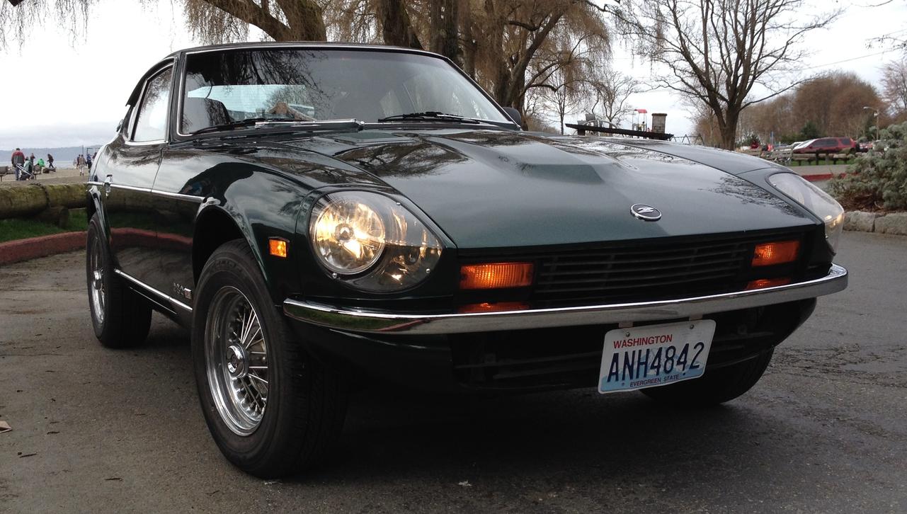

The height looks about how my 240 did at stock height.. A very 60's early 70's look.
I love the British Racing Green and the wire wheels with full height tyres to fill the wheel arches. I saw an Austin Healey over the weekend that had similar colour and wheels. Nice.
Thanks for all the kind words - I'm almost done fiddling with it (for now)...
I have to wait for another couple of paychecks before doing wheels/tires, but I can certainly live with it as is for a while :) The wire wheels are from the PO and are chromed steel, so starting to rust and a major pain to keep clean. I'm thinking of some slotted mags and raised white letter tires to hit the classic 70's muscle look (re-living my childhood).
NICE! Love the colors. I also love the wheels, though they're certainly difficult to keep clean. True spoke wheels were EXPENSIVE back when I was considering them for my '75 Z. But they're certainly not practical for use on a DD.
