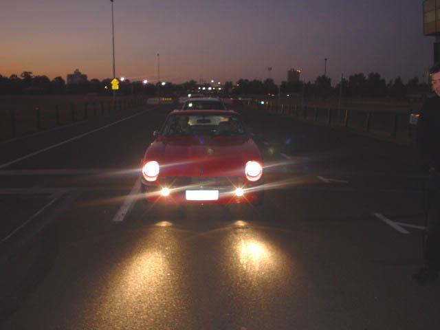

I've upgraded to the H4 kit.. then installed all wiring relays.. then put in the ultra white bulbs.. visibility is excellent and I'd be lying if I didn't say I think it looks pretty mad :D
btw - here's an idea of the brightness.. (that aint my high beams)
Arch, what H4's did you use?
I picked up some spare Hella H4's originally sitting around Zworx, they said they were the right ones, i went on their word.
