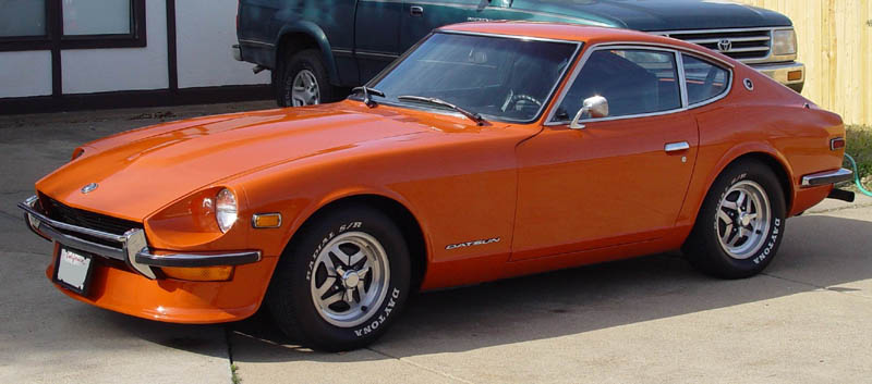

BTW, very nice looking car!
I like what the picture shows. What about the interior?
Although $7500 may be excessive in SOME areas, in others it's average. You must consider that for what we have seen of the underside and now the exterior, it doesn't look bad at all.
