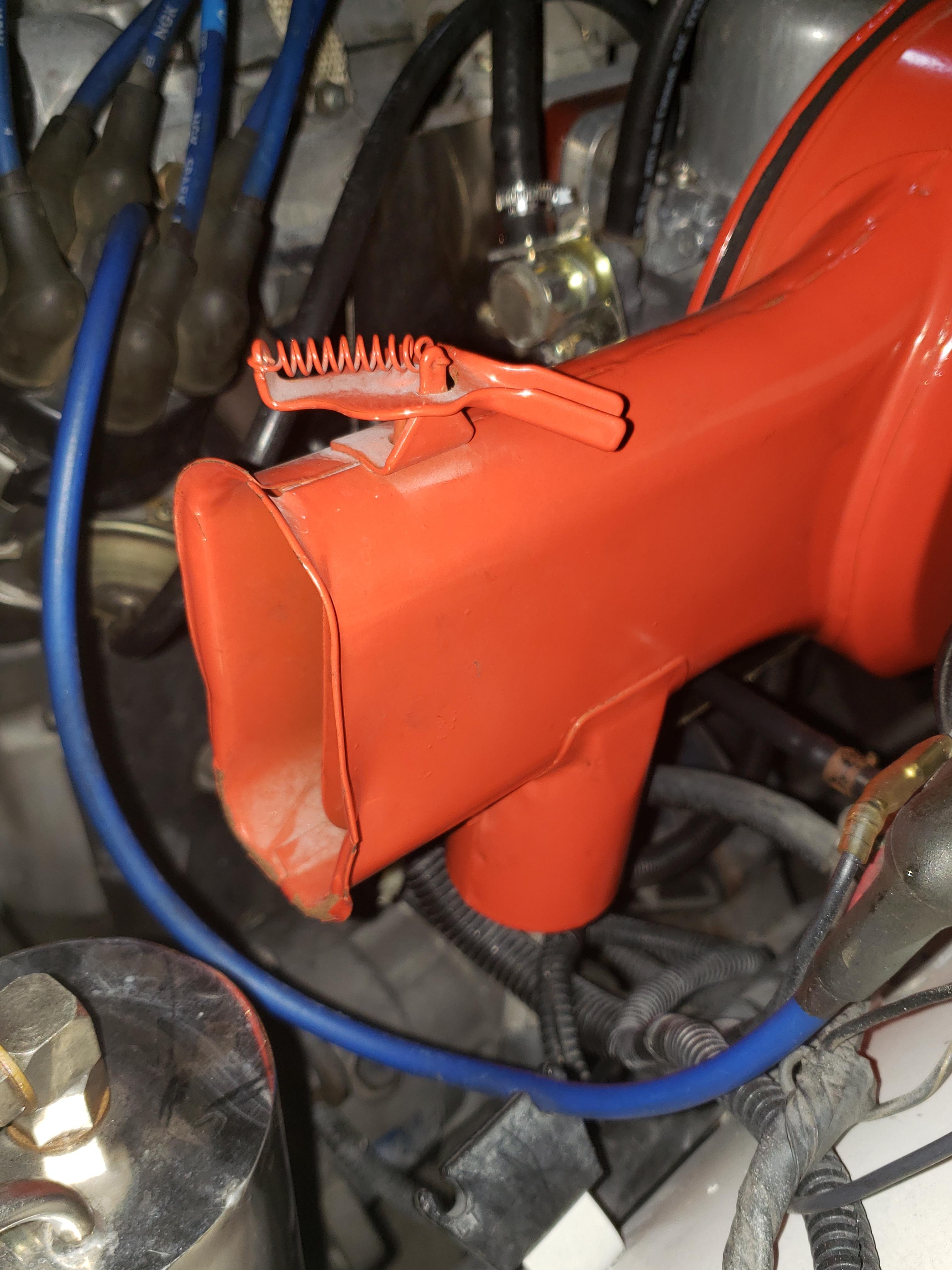

Mechanic says in shoulf get an air conditioner or washing machine hose and tie wrap it to the mouth of the orange airbox and the other end through one of the holes near the air dam so it can suck fresh air at idle and avoid this situation. What do you think
 How is it doing these days when idling in traffic? Still overheating or loading up the plugs? Easy enough to add a hose but what "situation" is the mechanic trying to solve with the extended air intake?
 The compression test looks wonky to me. First, I've never seen identical compression in all cylinders in any engine. Second, If they're all at 100 psi, IMO, they're all low. My engine tested around 160 psi (+ or - 5 psi.) the last time I checked.  is it possible the valves were set too tight?
Mechanic says the carbs could suck fresh air at idle instead of the hot air trapped under the hood during idle and it could help avoiding the plugs getting sooty
