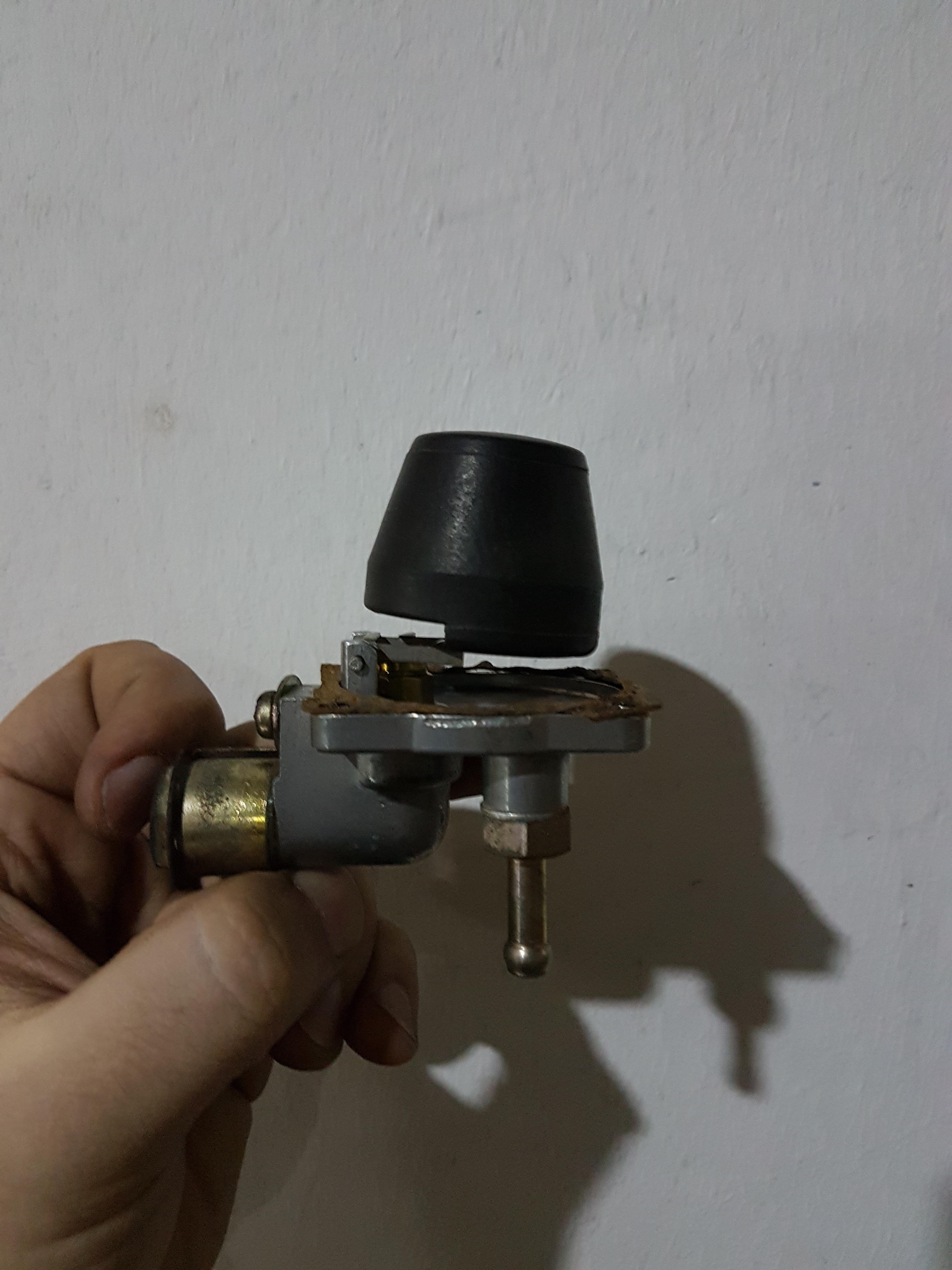

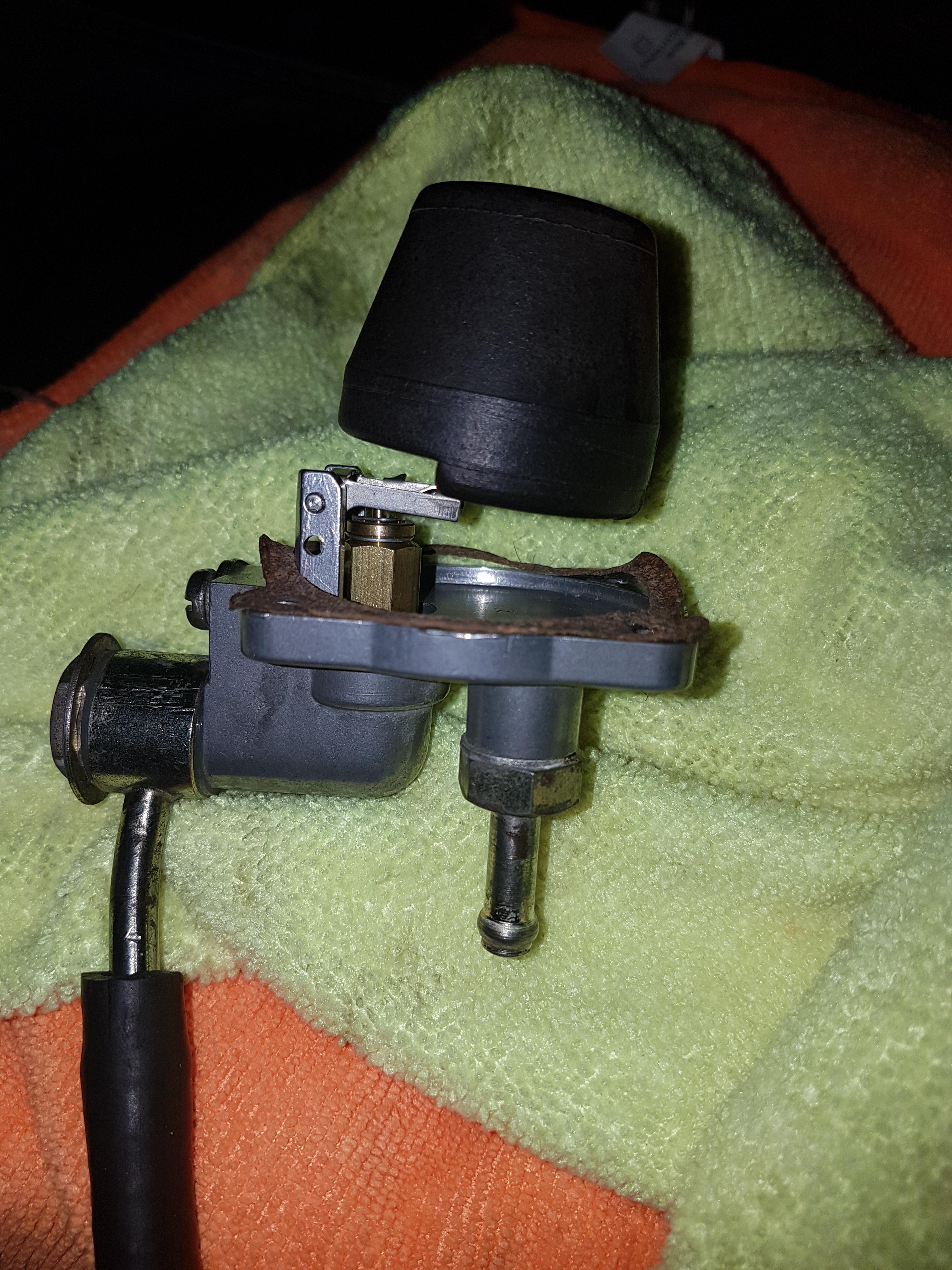

Okay found a nice small flash light that can help me with your instructions. I was thinking that the 4.25 fuel pressure i had before could have damaged or altered in some way the needle valves and seats and since i had a new set i purchased from amazon, i also decided to replace them. Do you think i will need to check on the mesh filters which are part of the float lids?
