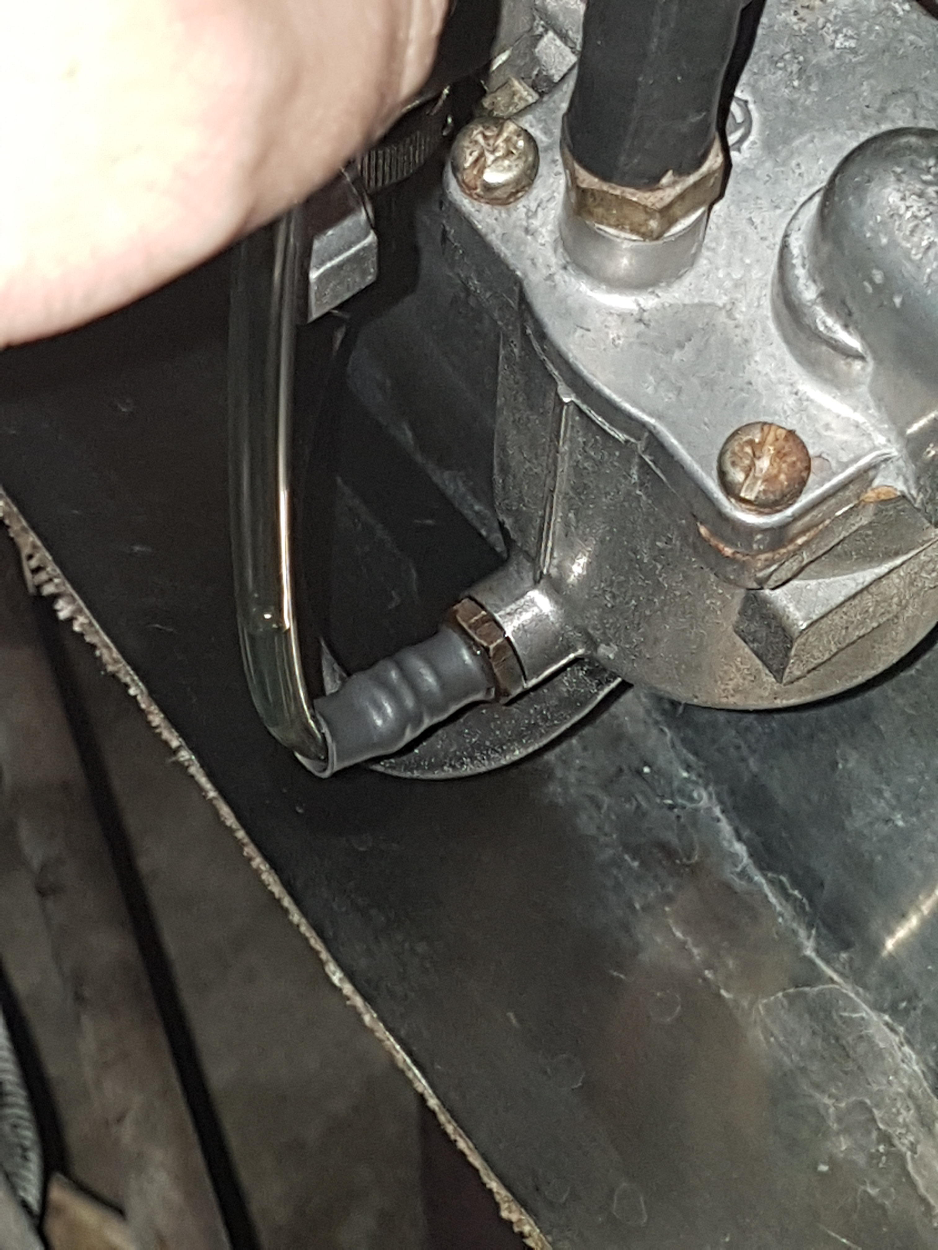

I see you hooked up the sightglasses. Just bend the plastic hose and hold it vertical right against the side of the float bowl. Get a pencil and draw a horizontal line on the float bowl that lines up with the fuel level. Then do the same with the other carb. Get your micrometer and measure the millimeters from the bottom of the lid (or the top of the bowl plus the gasket) and write it down. Then check the other one and write it down. It should be about 25 mm down for the front one and 21 mm down from the lid for the rear.
If it's close then you're ready to fine-tune it with the "nozzle" method. If it's Within 1 mm it's close enough since the fuel level goes up and down that much when the engine is running, as the float valve opens and closes. If you watch the sightglasses carefully with the engine running you can see that happening. Use the nozzle method for the last stage since it's the most accurate. Also with the nozzle method you don't need to think about the fuel in the front bowl being lower than the rear. They should both be the same level in the nozzles.

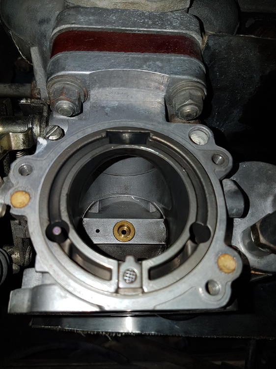

What is your recommended process for dealing with needle alignment on the three screw 72 carbs when the alignment cones have been sheared off? Is that addressed in your instructions or your video? I thought I had seen some documentation about how to handle this in the past, but I can't put my fingers on it.
I mean, I know what I would do, but for someone who doesn't understand the issue... What do you guys recommend?20180217_172214.jpg

With the piston in and dome in place start running the screws down unformly while lifting the piston with a finger and allowing it to drop. If you are cattywompis and the needle is binding, back the screws off a smidge and nurse the dome sideways until it  (the needle) drops freely. Continue until screws are tight and the needle drops cleanly into the orifice...... Do not under penalty of death, adjust your floats during this operation...... Now that's funny I don't care who you are!!
