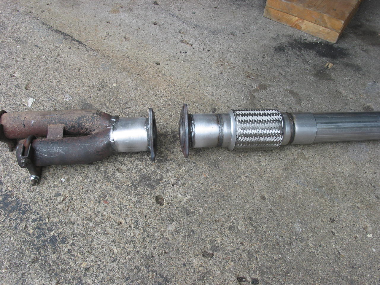

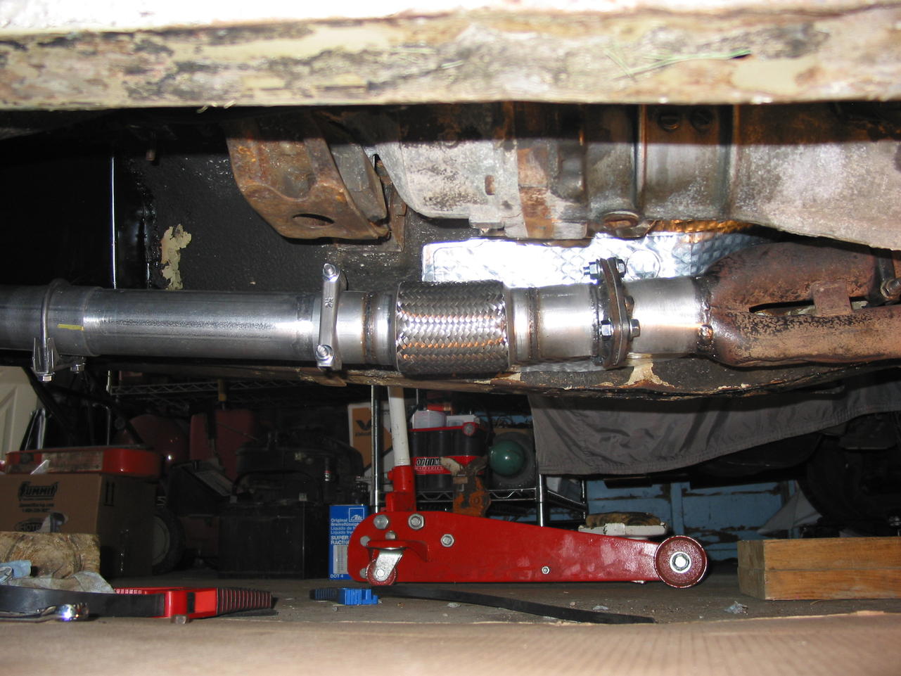

One suggestion, is to put a flange in the pipe about halfway back from the header and make the exhaust a 2 or 3 piece affair. Header to flange, flange to muffler, etc. It will make putting it all together much easier and you won't have to weld under the car.
That's going to make it tough to drag next door to weld . My suggestion would be to have the welder ONLY TACK weld the pipes and retest fit. Just incase the alignment is not right. I don't know what you mean by " tensioners", but it's hard to keep things on place before welding. That's why most tact weld on car .
A tiny change in orientation at the fittings will affect how the pipes fit when you reinstall. A couple of degrees off, longitudinally or rotationally, at a flange can equal an inch or two at the other end of the pipe. You might consider drilling holes and using strap steel and screws while it's on the car to get a rigid assembly. It would be like a mechanical tack weld. You can fill the screw holes during welding.

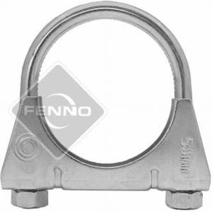

Yea well i guess it kinda is. We have fever people in whole country than LA downtown. Im planning to do it basically on zero budget (exhaust parts are cheap, 5-15 bucks each) If i make the pipe under the car and tighten it well enough with these:
it should last the 100 yard transportation to the neighbour so he can make tack welds...right? LOL
