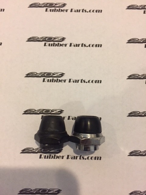

I am making a batch of new ones this week. The only difference is that the reproduction is a little wider at the top by about 0.5mm. The original is .035" and my reproduction is .055" wide. The only thing you need to do is get the old top out of the finisher nut and install the new along with original star looking washer( metal retainer).  Other than the small size difference, it is a perfect fit and look. It is also nice and tight around the antenna mast.
original is on the left and reproduction is on the right.
NIX240z, looks good. Let me know when available or I can just pre-order if you prefer. JLP
@nix240z: Yes, I will pick up one as well.  I would be hesitant to get a used one as I am sure the plastic is incredibly frail, like my current one.  My current one is like eggshell, and is held together with super glue.

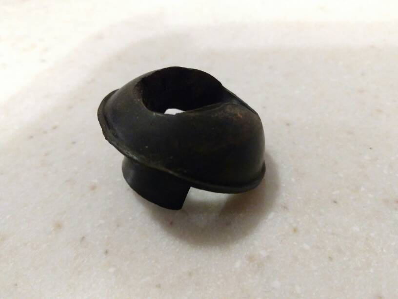

I found a really nice one. It's still very soft.

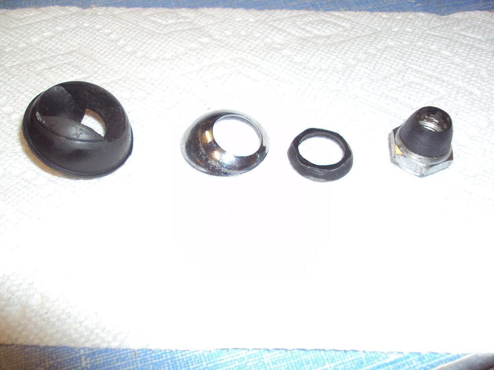

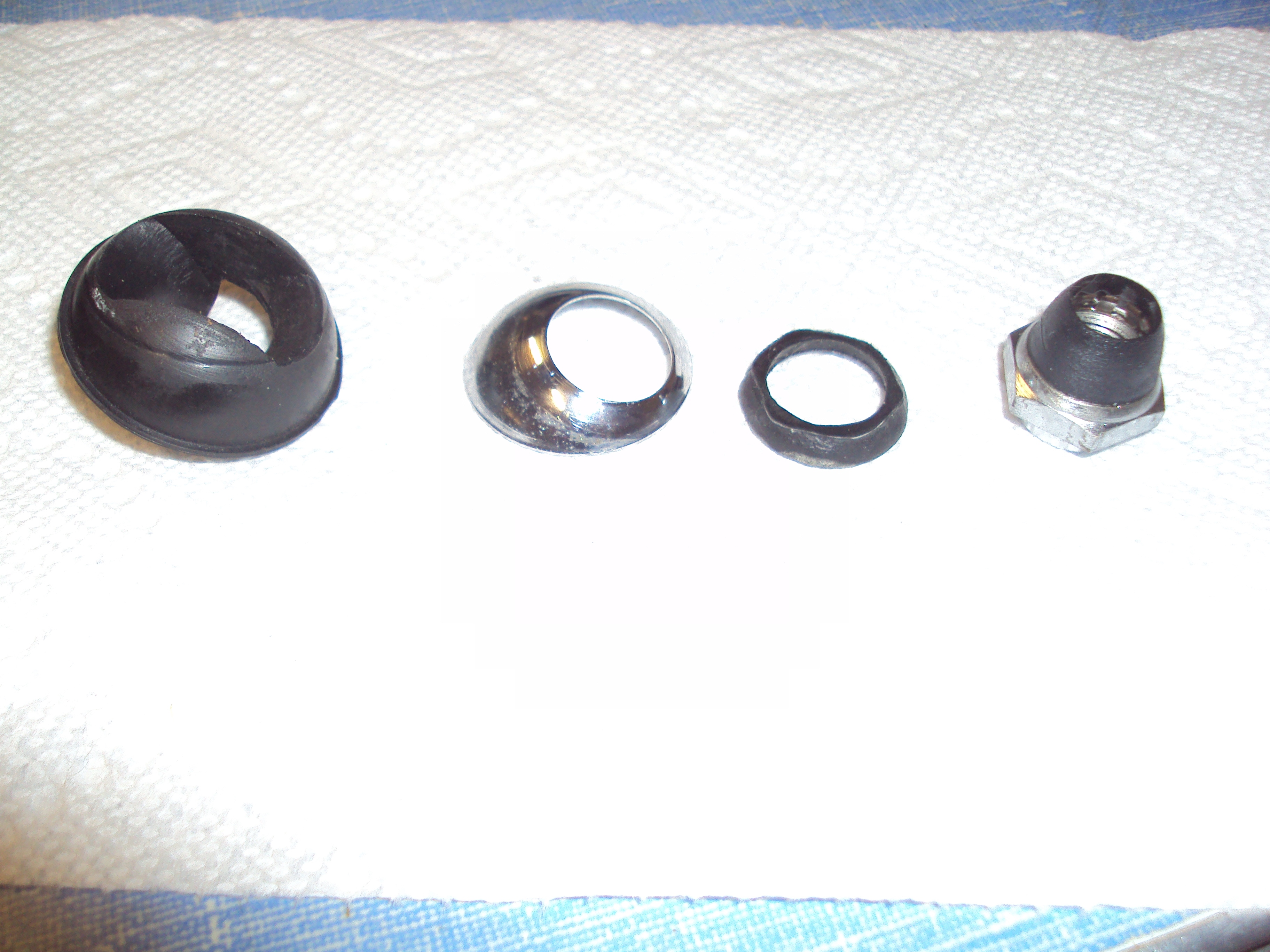

There is another piece to this assembly that often has deteriorated to the point of it missing altogether.
Just below the finisher nut is a rubber washer that fits between the finisher and the polished stainless steel cap that covers the top of the rubber or plastic ball.
This arrangement:
This rubber washer seals the space between the bottom of the finisher nut and the polished stainless cap.
It has a concave profile that matches the curvature of the polished cap.
All of the examples that I have of this part are not in very good condition. They are serviceable and could be used for a pattern if needed as they are intact,--- just somewhat weathered---- as you can possibly tell in the photo above.
While I would like for Steve to reproduce the balls, I feel we should also explore the reproduction of this piece.
