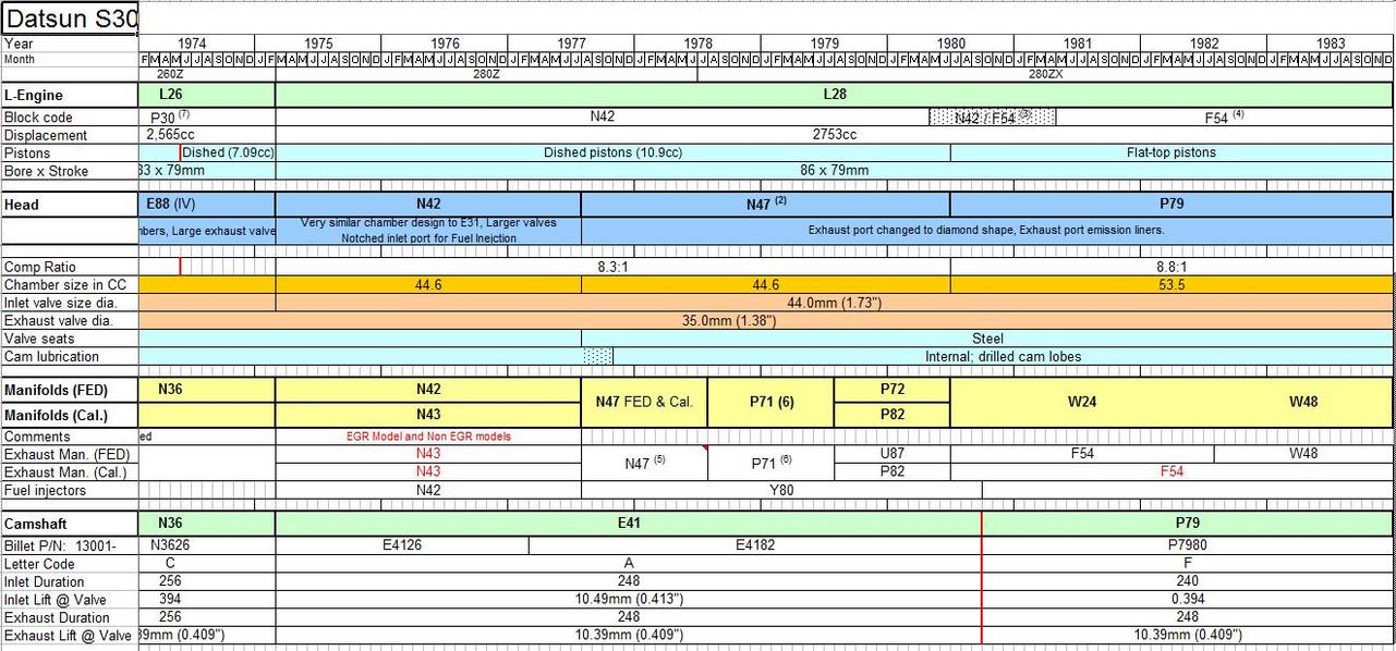

Here is a timeline for the 280Z & 280ZX. Its not complete and the information is being improved all the time, but it will give you a guide as to where and approx when things changed. This table is based on USA models.
Chas
