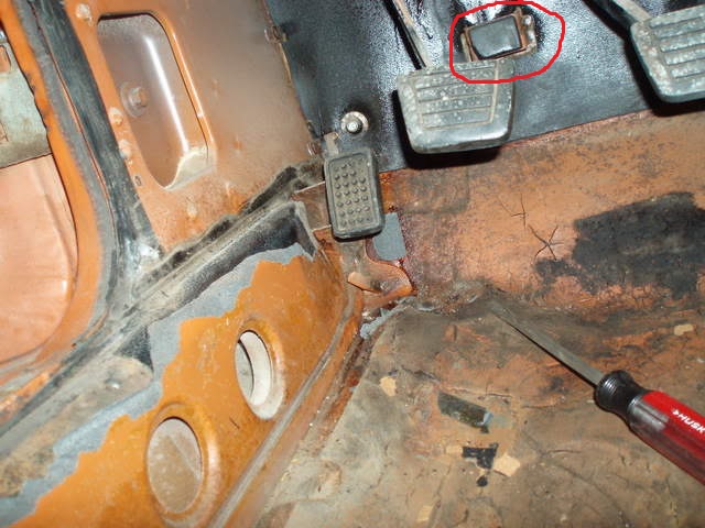

In addition to the clutch line bracket that Zkars mentioned, there is also a bracket with a rubber stop underneath the clutch pedal. I think those were only installed on manual transmission cars, so if it is missing, it was originally an automatic. Here is a photo I found during a quick internet search.
