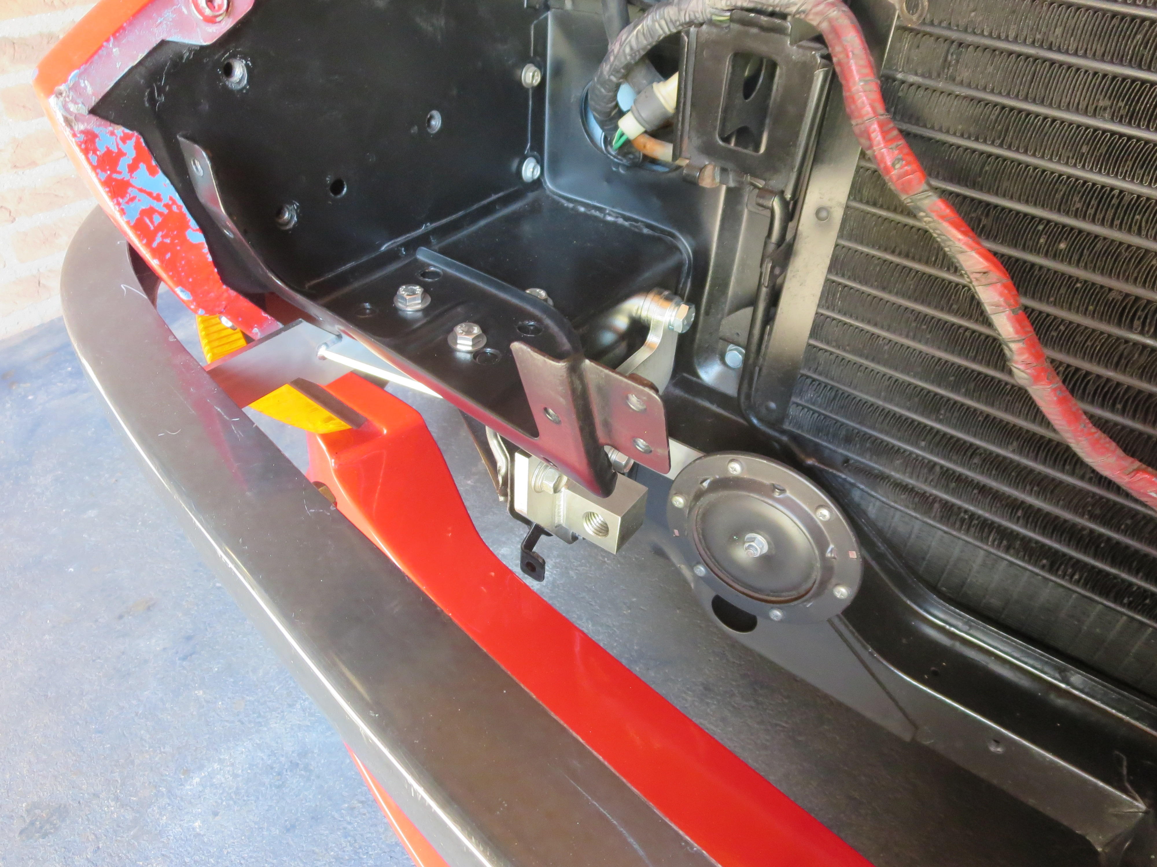

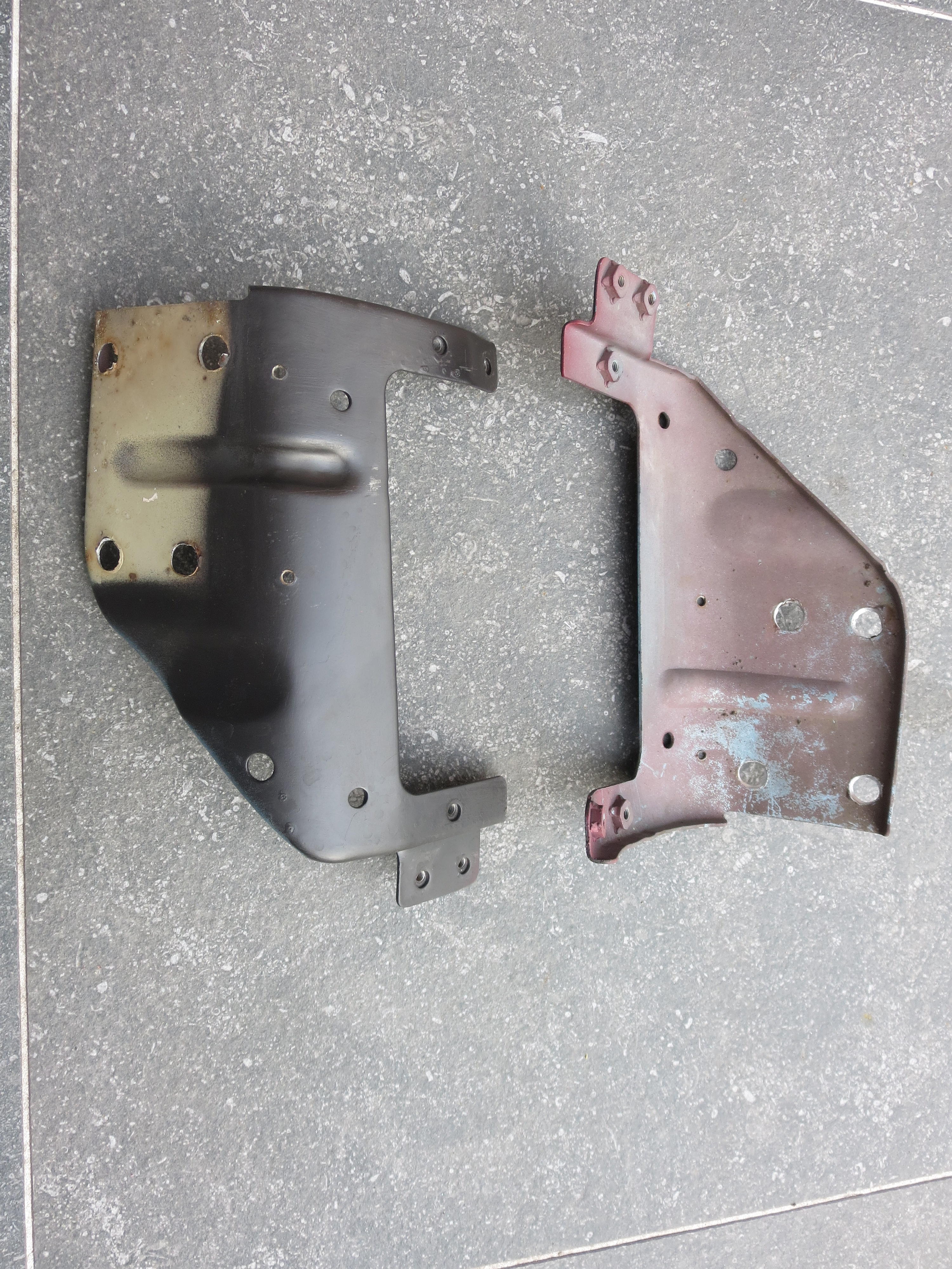

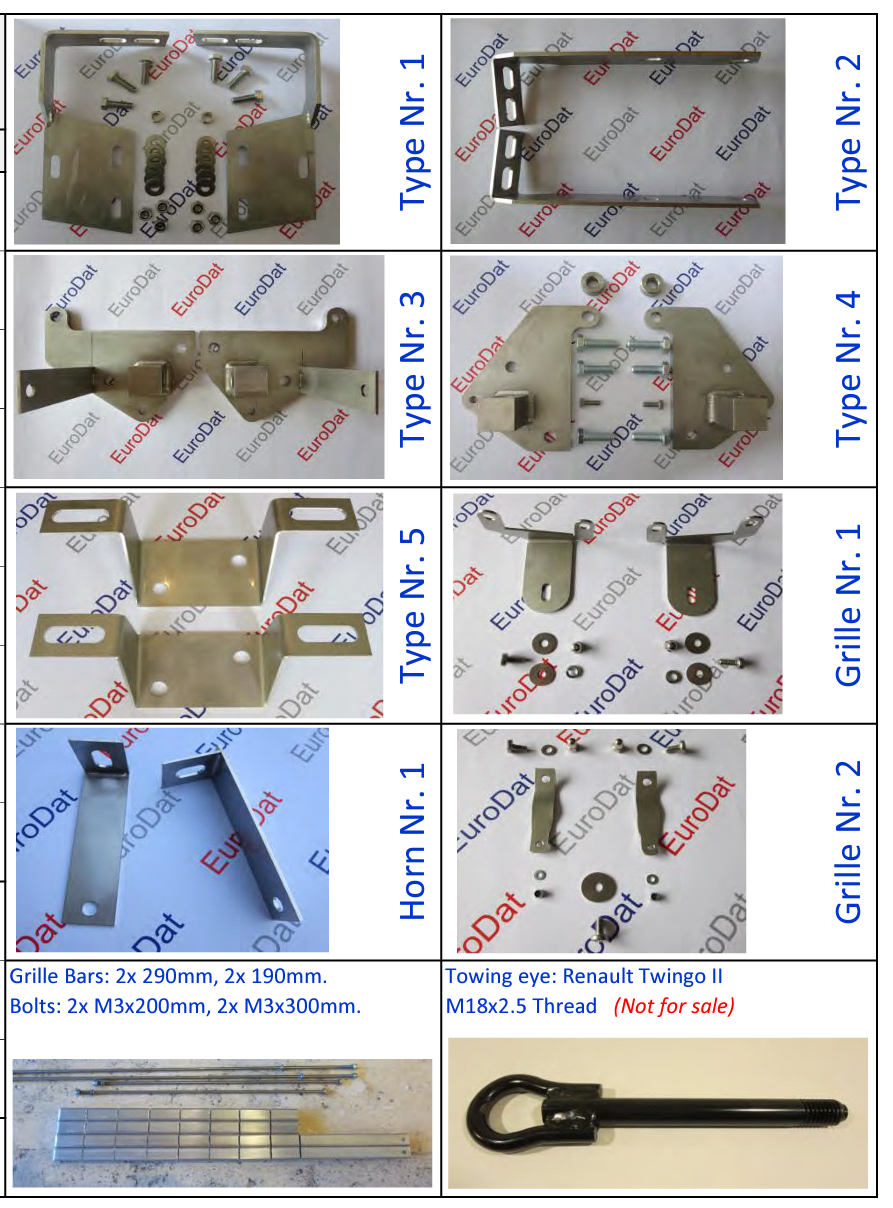

When I started this thread no one made any descent kind of bracket. I did try to order a set, but was disappointed in what it was. I still have them somewhere in the garage. That is when I decided to make my own.Screenshot_20200119-083823.jpg
I have been making the brackets for a little over four years now, but others make them now too. You can buy theres through TheZstore. Mine are stainless steel and a little cheaper, but its up to you what you want to do.
I do make two styles. One so you can really use a standard 240Z grill or the Skilard 240Z grill and 240Z indicators in a 240Z air-dam or keep the 280Z indicators and 280Z grill. I think I'm the only one making the first option.

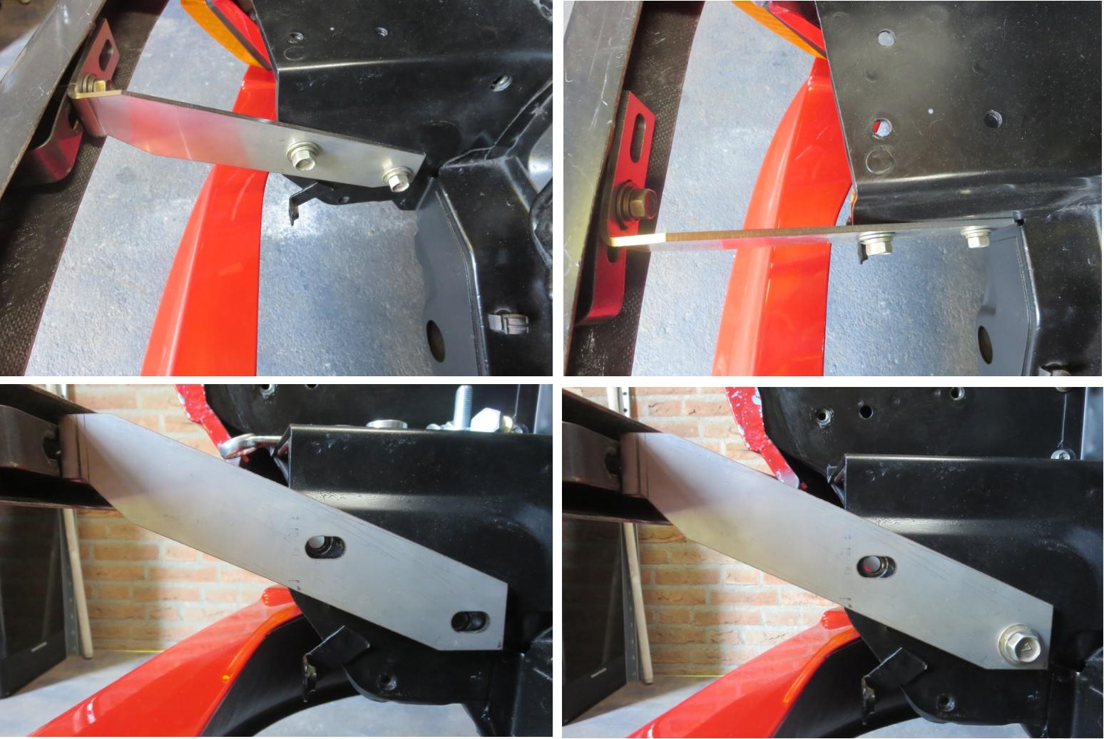

It depends on what you want to do as to which bracket is best for you.280Z bumperbrackets.png
My type 1 will give you the most flexability and will work with the skillard 240z and 240z grills.
A couple have used the type 1 bracket in combination with my grill brackets on the skillard 240z grill. I'm using this combination on a 240Z grill.
The type 2 is like the others offered. It will work on the 240Z, but a couple of bars will need to be cut down.
Both brackets will work on the 280Z grill.

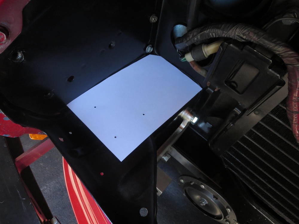

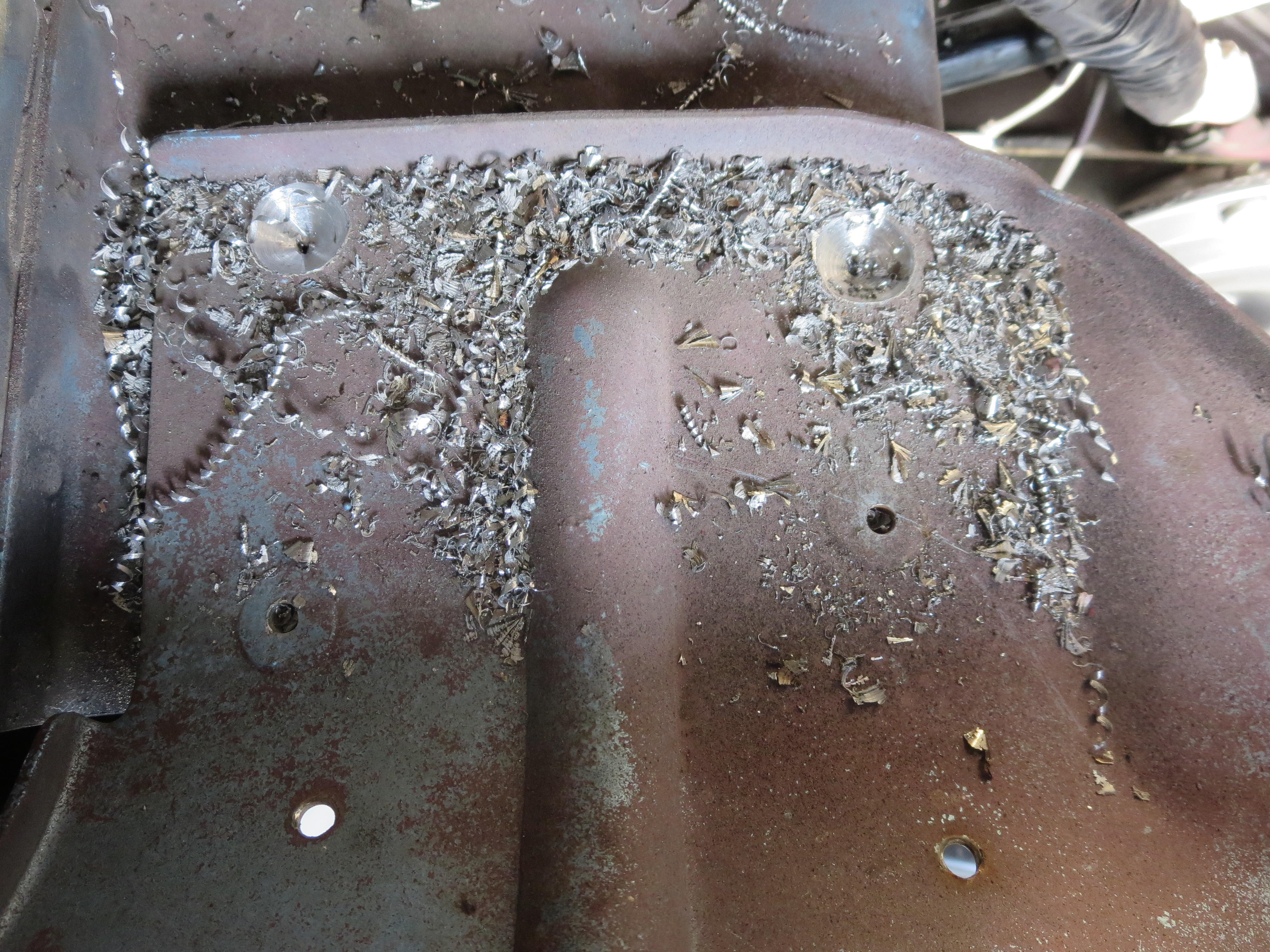

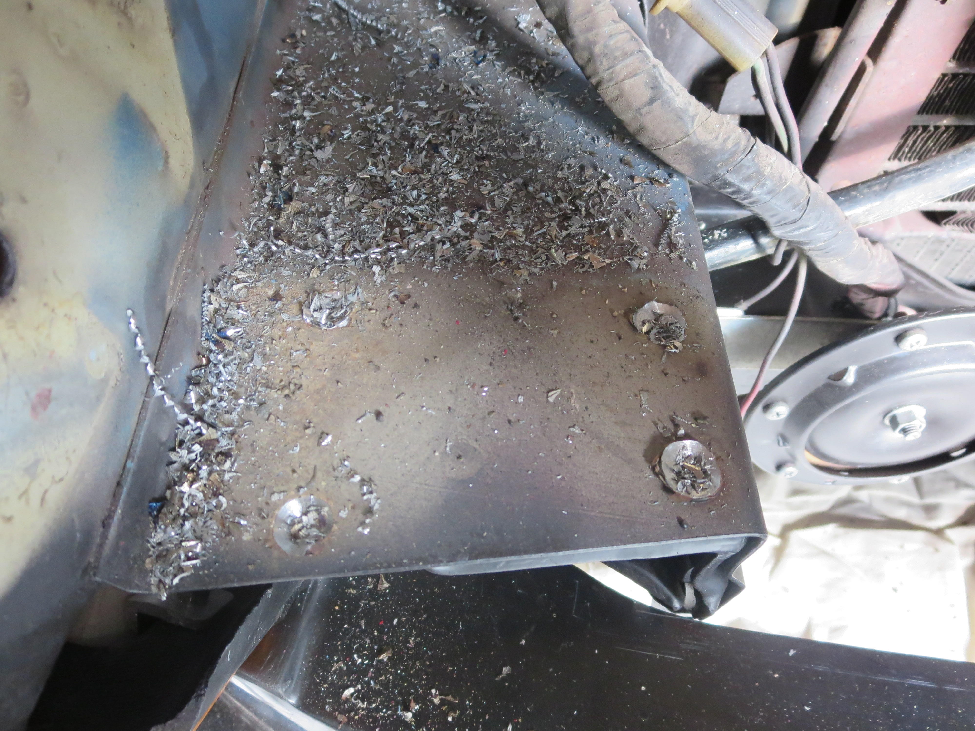

The type 1 can be fitted without dismantling the 280Z turn indicator brackets. You drill the holes through the brackets using the white cardboard template supplied with the brackets.IMG_2101.JPG
When you go to the skillard or 240Z grill and 240Z turn indicators it's a simple job to remove the bracket. The brackets are spot welded in place. The easiest way to remove them is to drill through the spot weld with a 1/16" drill and them use a 1/2" drill to drill the top section out of all the spot welds. Don't drill all the way through. Gently wobble the bracket and it will break loose.

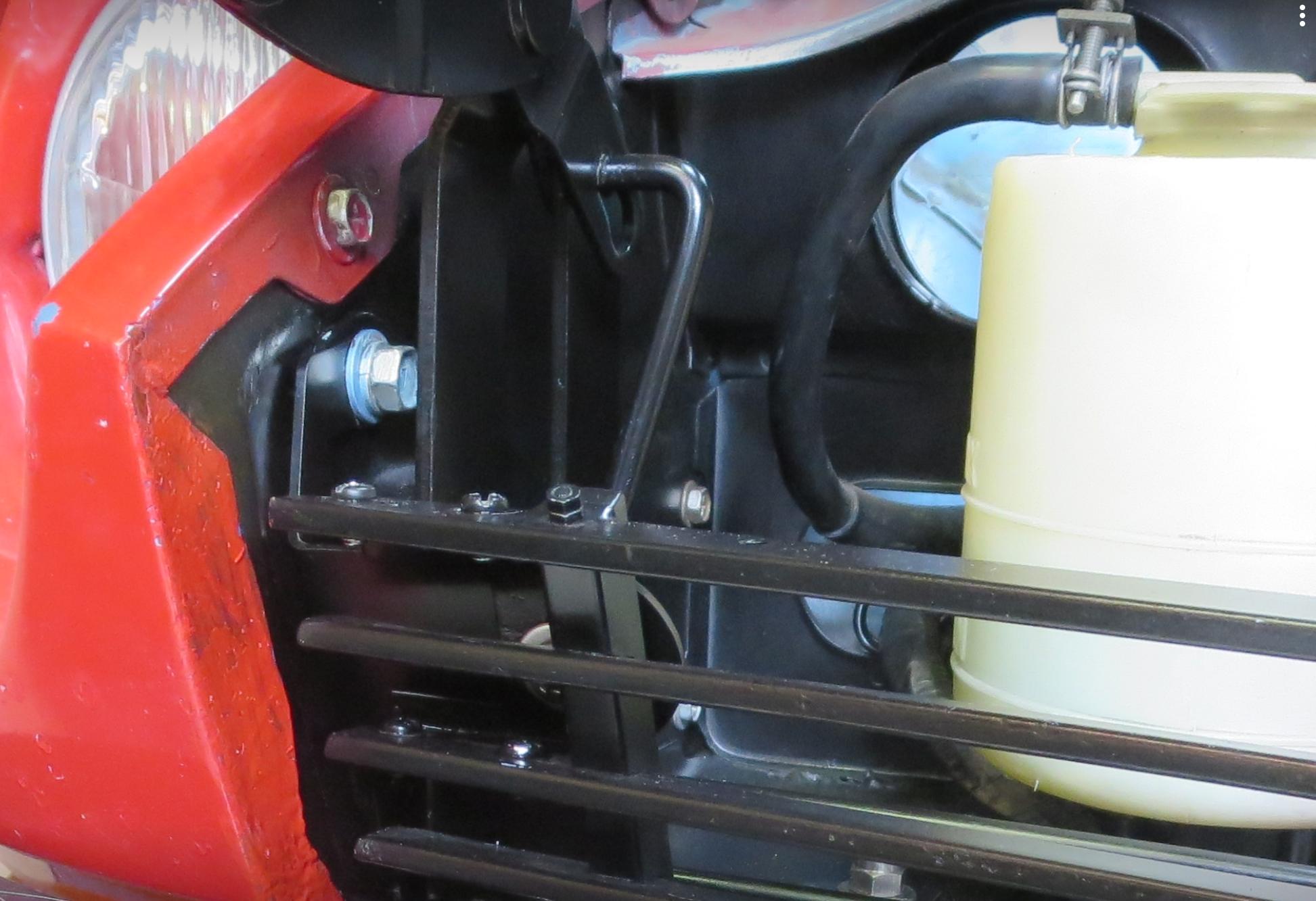

The grill brackets fit to the hood hinges, but still allow full adjustment of the hood. No drilling need to fit the grill brackets.

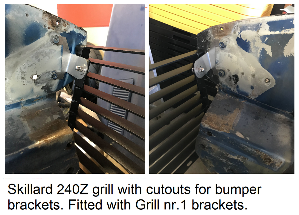

I’ve made sets for members who fitted the grille brackets to the Skillard 240Z grille. That gives the cleanest result, in my opinion.
Sorry, I don’t have any brackets and won’t be making them anymore, as my mate passed away during the COVID pandemic.

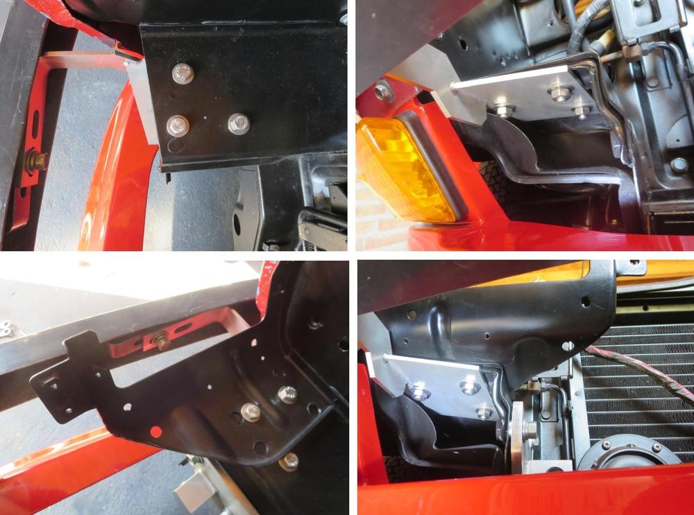

Here’s a couple of photos showing the grille brackets fitted to the Skillard 240Z grille and my car with a modified 240Z grille. This setup requires removing the indicator support frame.
If you use a 240Z air-dam, it may require some tweaking.
