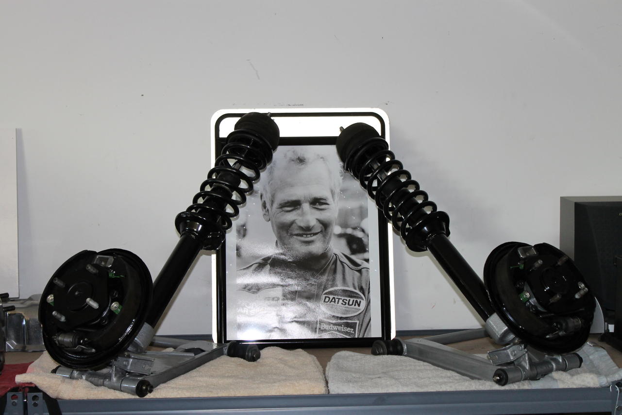

I am happy to see my thread is still being used as a resource to owners :) In regards to where to get new pins, I ordered mine from MSA as I was ordering some more parts at the same time and they actually had the best price. Was it all worth it in the end? Hard to tell since I only drove the car about 50 miles after doing all the work before I sold it. Since I was replacing everything else and I wanted to strip and paint everything I needed to get them out. The current owner loved all the work I did and the documentation and pictures helped to prove its value. If I had to do it over again I would, especially now since I have all the tools and knowledge. If anyone in the Austin area ever needed a hand with theirs I would help them out.

Of course easily said after the fact but this has taken weeks to get the dis-assembly - destruction - POR15 - reconstruction and finally satisfaction of getting the job done.
