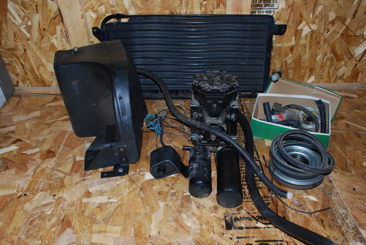

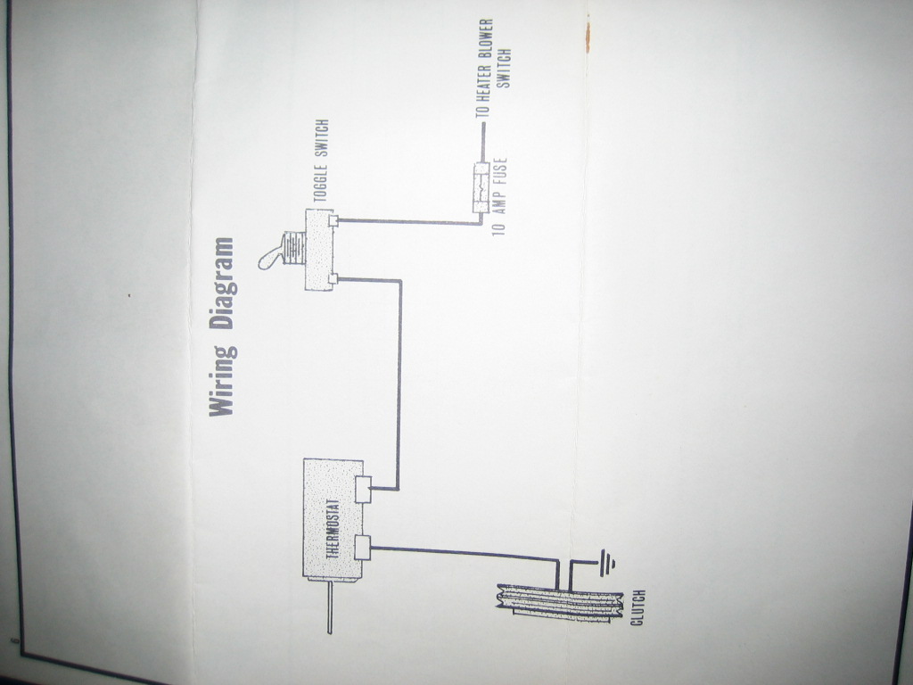

As I had a hard time trying to find info on dealer-installed A/C's, I wanted to share what I was able to come across. Please note that I've since sold this setup, but it should give those of you interested in A/C some ideas.

Jarvo--Thanks for posting that info. Its really beneficial!
