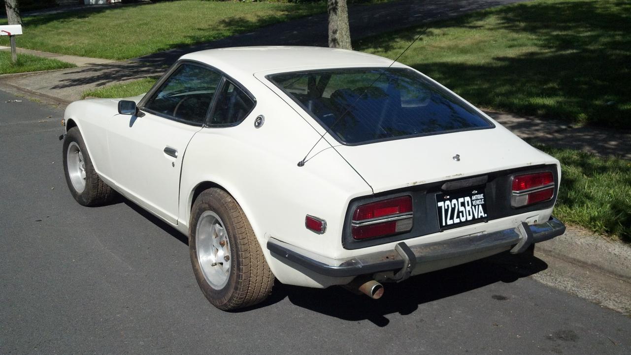

Posted July 10, 201213 yr comment_395357 Howdy. Picked up a '71 240z a month or two ago to give my '70 a buddy. We don't get around to the local clubs often, so I could tell the green car was getting lonely. Only too happy to oblige. The car hasn't been run in close to a decade, but otherwise the list of things it needs are far shorter than another will-not-be-named project I attempted earlier this spring. After getting it running (shop vac proved helpful for removing acorns from carbs), I found there was absolutely no resistance in the clutch pedal. Replaced Slave/Master cylinders, vacuum-bled the system and attempted to run once more. No-good. Looks like the clutch is seized. I'm planning on replacing the motor (stock L24, head allegedly has a mild cam) & transmission (roadster 5-speed) this fall, so the object of getting it running was simply to enjoy the car as-is in the meantime without digging into it too much. That being said, I really don't want to separate the transmission or replace the clutch. So... I came across this write-up for resolving the issue: http://www.chicagolandmgclub.com/techtips/general/604.html I was going to give it a shot this Saturday. If the flywheel explodes, so be it. Any other non-invasive ideas? I've heard running a screwdriver in the clutch-fork and wiggling might free the rust as well. Link to comment https://www.classiczcars.com/forums/topic/43774-siezed-clutch/ Share on other sites More sharing options...
