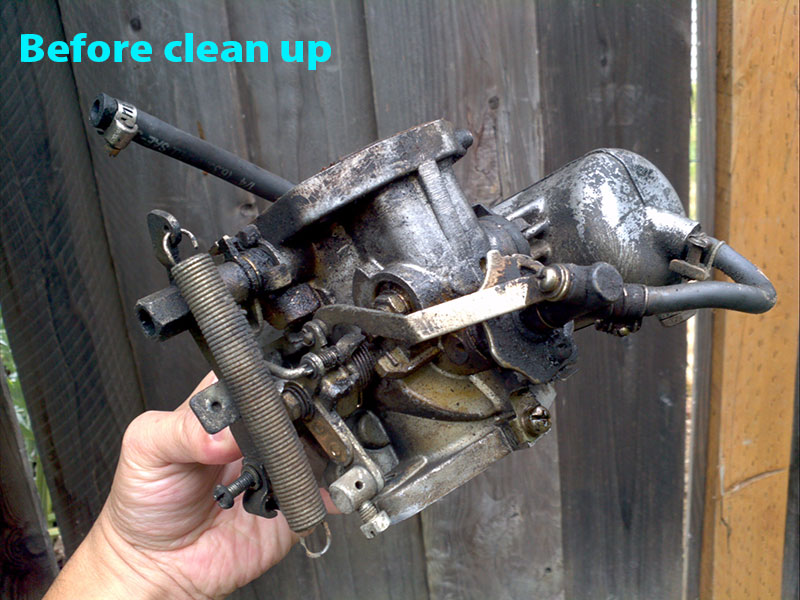

After watching Just SU DVD so many, I decided to rebuild my '72 3 screws SU carb.

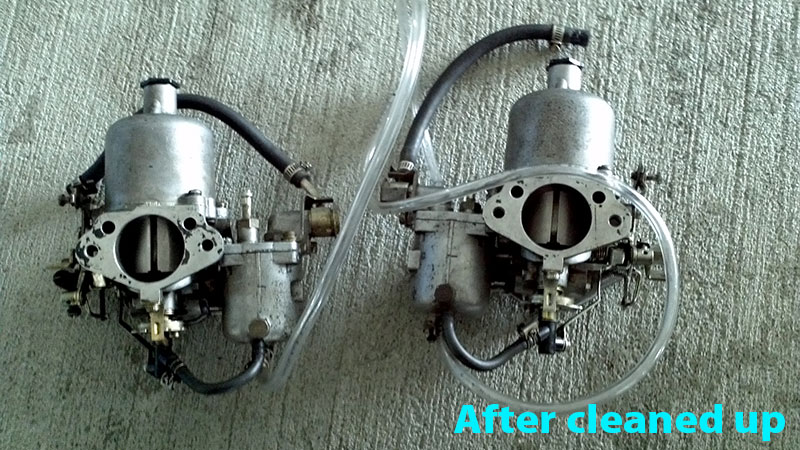

It took me 3 hours to clean up 1st carb to remove 40 years gank, but 2nd one took me just 1 hours.

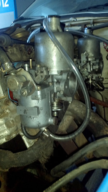

Following DatsunZgarage instruction and use clear tube to adjust float level for both SU carb.
http://datsunzgarage.com/engine/index.htm
http://forums.ctzcc.com/viewtopic.php?t=4181&sid=b15c6070a9563fa4173bb07bbd52d213
It took me so many times to adjust float setting matching to 23mm line for both carb.
