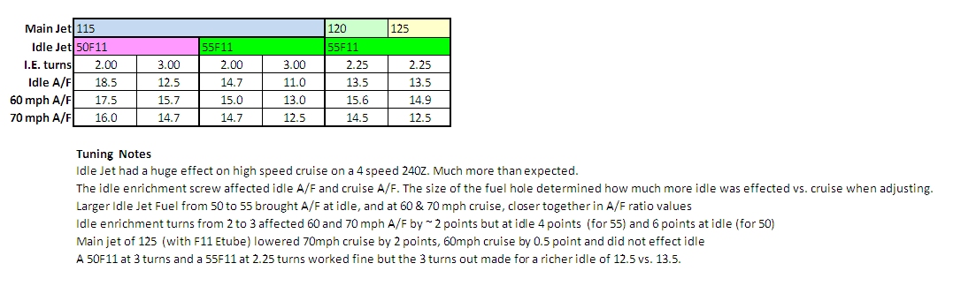

August 10, 20159 yr comment_475420 Just did some tuning with DR240z. We settled on this:  Engine: Block: L24 Head: Maxima N47 Cam: ~280 duration 0.48" lift  Transmission and Differential: stock 4 speed 3.545  Carbs: 40DCOE151 (3) 30mm Choke Fuel Height: ~30mm down from top of body Idle Jet: 55F9 Enrichment Screws: 2.25 turns Emulsion Tube: F11 Air: 70 Main: 120  A/F Ratios: Idle: 13.5 60mph cruise on flat: 15.6 70mph cruise on flat: 14.5  WOT runs 12-13  After setting fuel level to 30mm down, we first tuned by selecting a jet for cruise at 60mph that was near stoich (~15:1) and could be dialed to slightly rich for a smooth idle(~13:1).  The 55F11 did the trick.  We then checked the effect of the main on cruise. The car had a 115 main when the fuel level was 25mm down. We tried a 125mm main with the fuel now at 30mm down but it dropped the 70mph cruise to 12.5 w/o doing much to the 60mph cruise. We settled on the 120mm.   Tuning data:   The car runs crisp with no bogging nor rich fuel smell.  Nice even mocha coloured plugs to boot.  No popping or backfiring under load, over run, or at any rpm.  Success.     Edited August 10, 20159 yr by Blue Link to comment https://www.classiczcars.com/forums/topic/43089-tuning-40-dcoe-weber-151-on-an-l24/?&page=15#findComment-475420 Share on other sites More sharing options...
August 10, 20159 yr comment_475435 Just did some tuning with DR240z. We settled on this:  Engine: Block: L24 Head: Maxima N47 Cam: ~280 duration 0.48" lift  Transmission and Differential: stock 4 speed 3.545  Carbs: 40DCOE151 (3) 30mm Choke Fuel Height: ~30mm down from top of body Idle Jet: 55F9 Enrichment Screws: 2.25 turns Emulsion Tube: F11 Air: 70 Main: 120  A/F Ratios: Idle: 13.5 60mph cruise on flat: 15.6 70mph cruise on flat: 14.5  WOT runs 12-13  After setting fuel level to 30mm down, we first tuned by selecting a jet for cruise at 60mph that was near stoich (~15:1) and could be dialed to slightly rich for a smooth idle(~13:1).  The 55F11 did the trick.  We then checked the effect of the main on cruise. The car had a 115 main when the fuel level was 25mm down. We tried a 125mm main with the fuel now at 30mm down but it dropped the 70mph cruise to 12.5 w/o doing much to the 60mph cruise. We settled on the 120mm.   The car runs crisp with no bogging nor rich fuel smell.  Nice even mocha coloured plugs to boot.  No popping or backfiring under load, over run, or at any rpm.  Success.     Not too sure if this is important to note: Set up was carried out at 1250 feet above sea level and temp was 70 F Link to comment https://www.classiczcars.com/forums/topic/43089-tuning-40-dcoe-weber-151-on-an-l24/?&page=15#findComment-475435 Share on other sites More sharing options...
