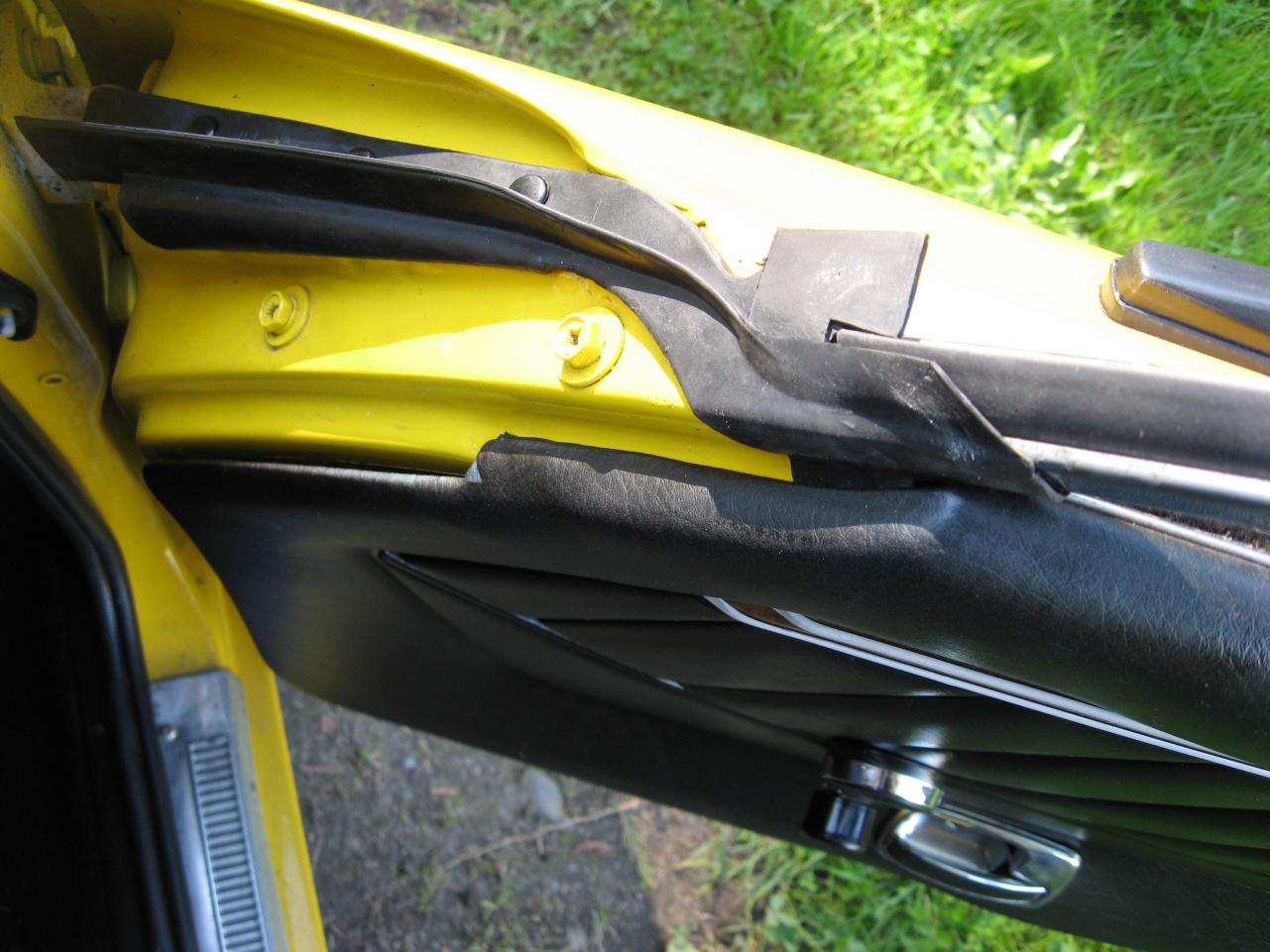

Can anyone post pics of weather stripping on the S30 doors? The only piece's I have left on my doors are the very bottom, underneath, and the very top of the window channel that meets the body. I am missing the ones that wrap around the window channel (front and back) where the channel meets the door. And the one that sits just inside close to the dash and top door hinge. The one that is held in place with 3 rivets. Those pics would be appreciated. Thanks.

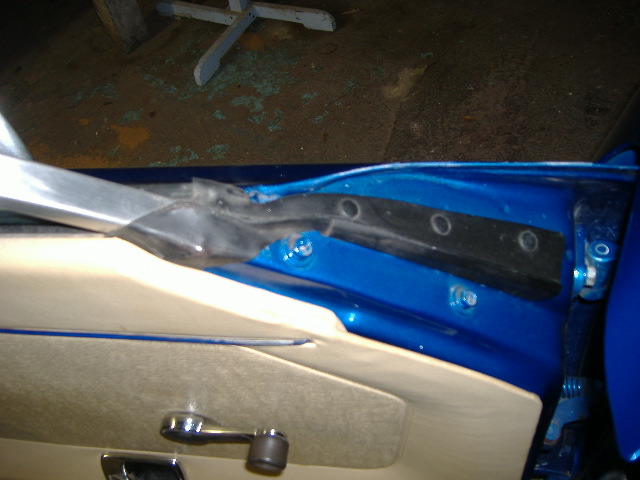

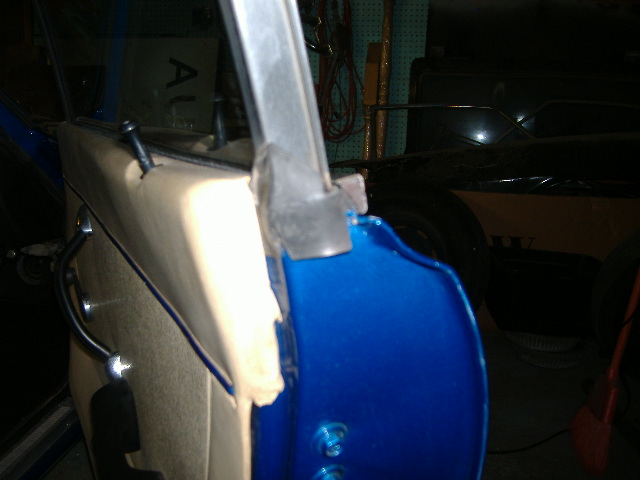

Ah yes! perfect. Can you send one of the opposite end of the window frame where the frame meats the door also grantf? The really small piece. Is that original or did you have to replace it? Did you use regular W/S cement? Sorry for so many questions. I purchased new ones several years ago and when I attempted (recently) to install them I couldn't remember how to! Thanks for your help. I looked at the FSM but it doesn't make sense.
The pic I provided shows the piece before I trimmed and glued it (only the upper portion) using lock-tight W/S cement, it is holding up nicely. The rear door peice I have not obtained yet so I can't help you there, sorry.
