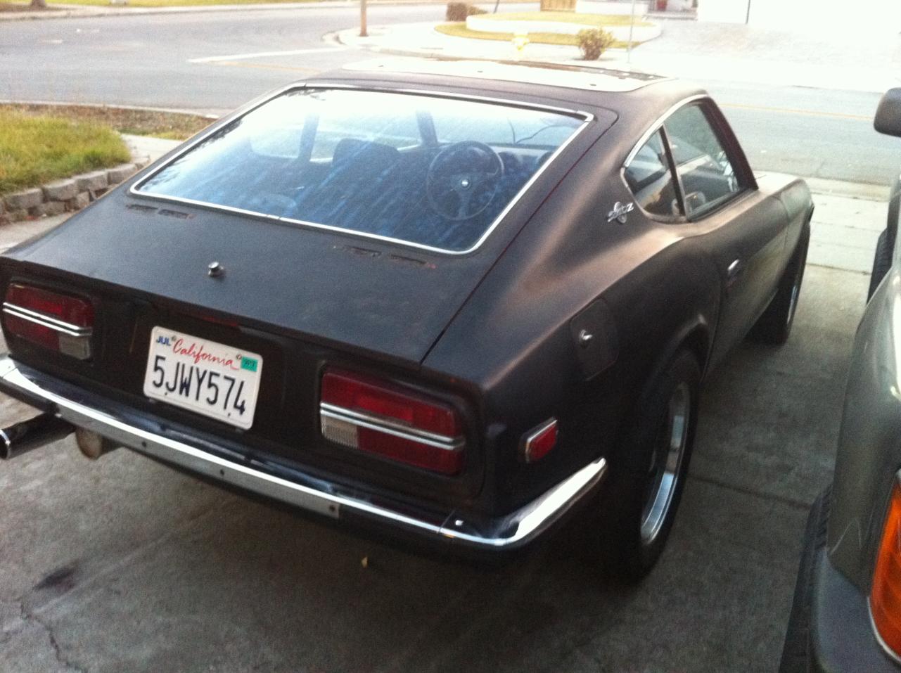

So I'm now the proud owner of a 1970 240z.
Previous owner had been working on it for a while, body has no rust, One spot of bondo, all primerd black. Brakes and steering have been gone through.
She's a project, and needs some love, but its a starting point, and I could not be happier. I'm lucky enough to have access to a full auto shop, with anything I could ever want for working on it.

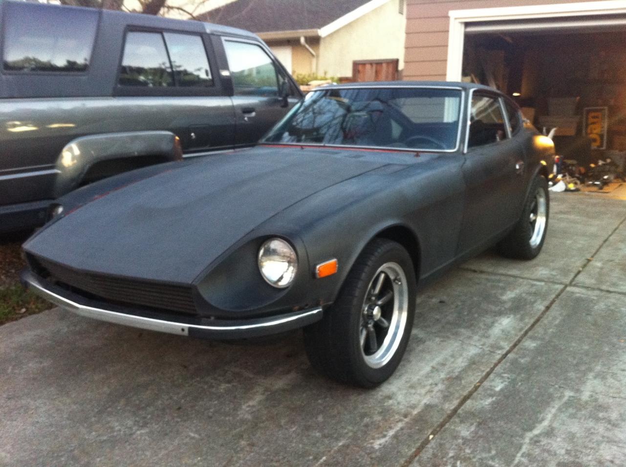

The car came with 16'' konig rims. Look real nice, and such, but under hard cornering, the fender touches the tire. Springs feel real soft.
Would dropping the eibach springs in help me here, as they must provide a better feel than the now 40 some odd year old current ones?

Looks great! Lucky you to have a '70! :) Looks like the Stealth Z at the moment, haha.

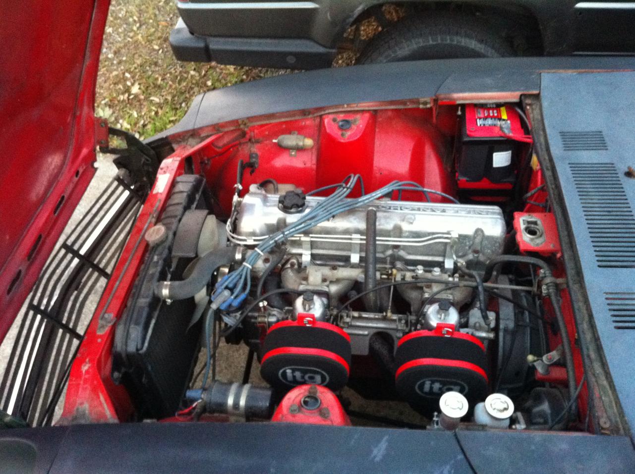

What are your plans for the paint? Is the red in the engine bay the original color?
The paint will stay that way for a while, while I work out the mechanical stuff. But yes, the red is the factory color.

I have Eibach springs, Tokico HP dampers, and poly bushings all around on my early 260Z. The ride is stiff but it corners great! I have 225/50-16 tires on 16X7 wheels and they do not rub, the wheels are Panasports but I'm not 100% sure on the exact offset. Your tires look pretty beefy, what's the size?
225/50-16 as well. The potential of the vehicle is wonderful, and again, cannot wait to really tear into it, and see what comes.

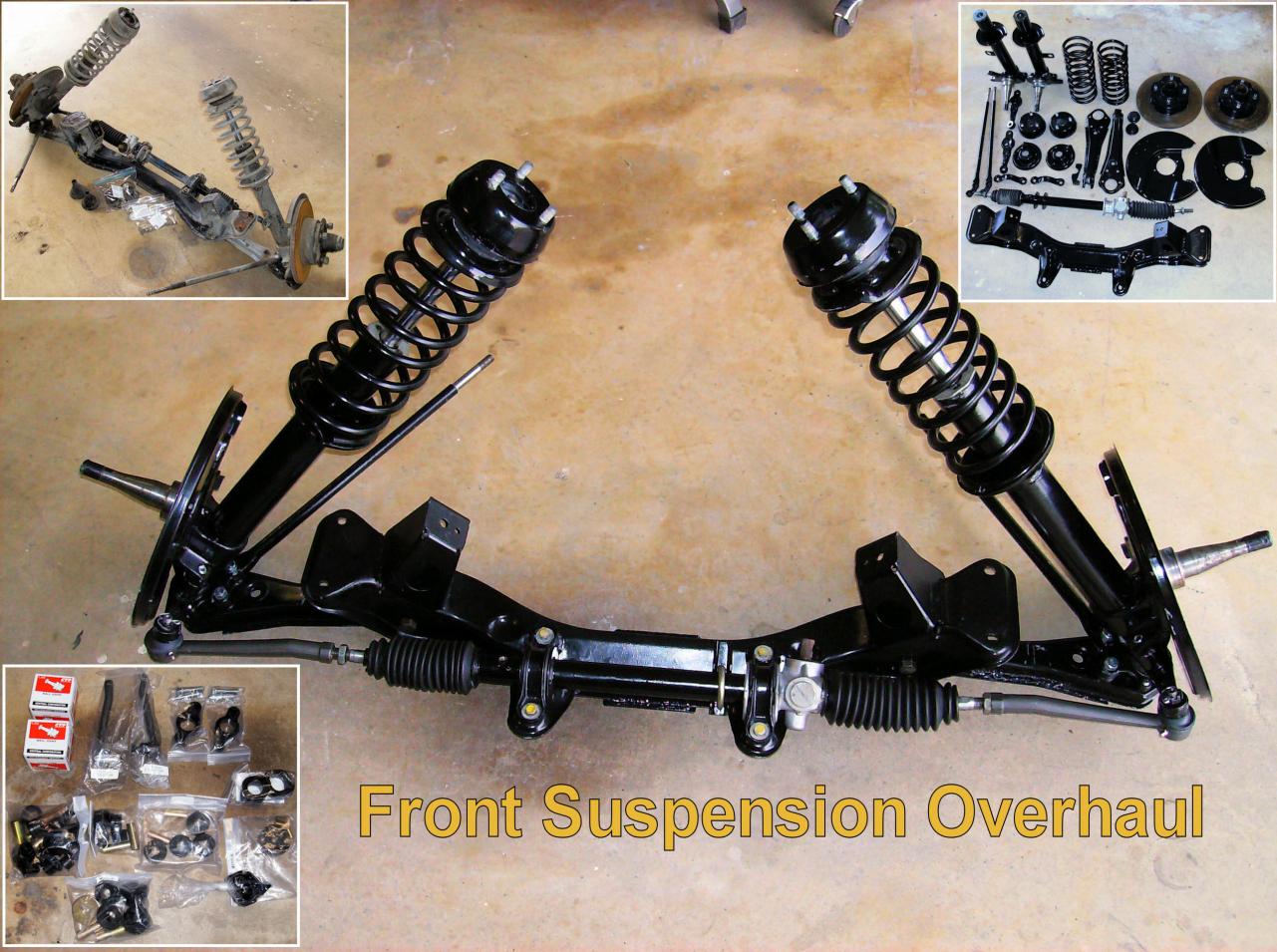

Here are a couple of pics of my suspension overhaul. If choosing black color, consider using POR-15 paint. A bit tricky to use, but virtually indestructable from road chips.
