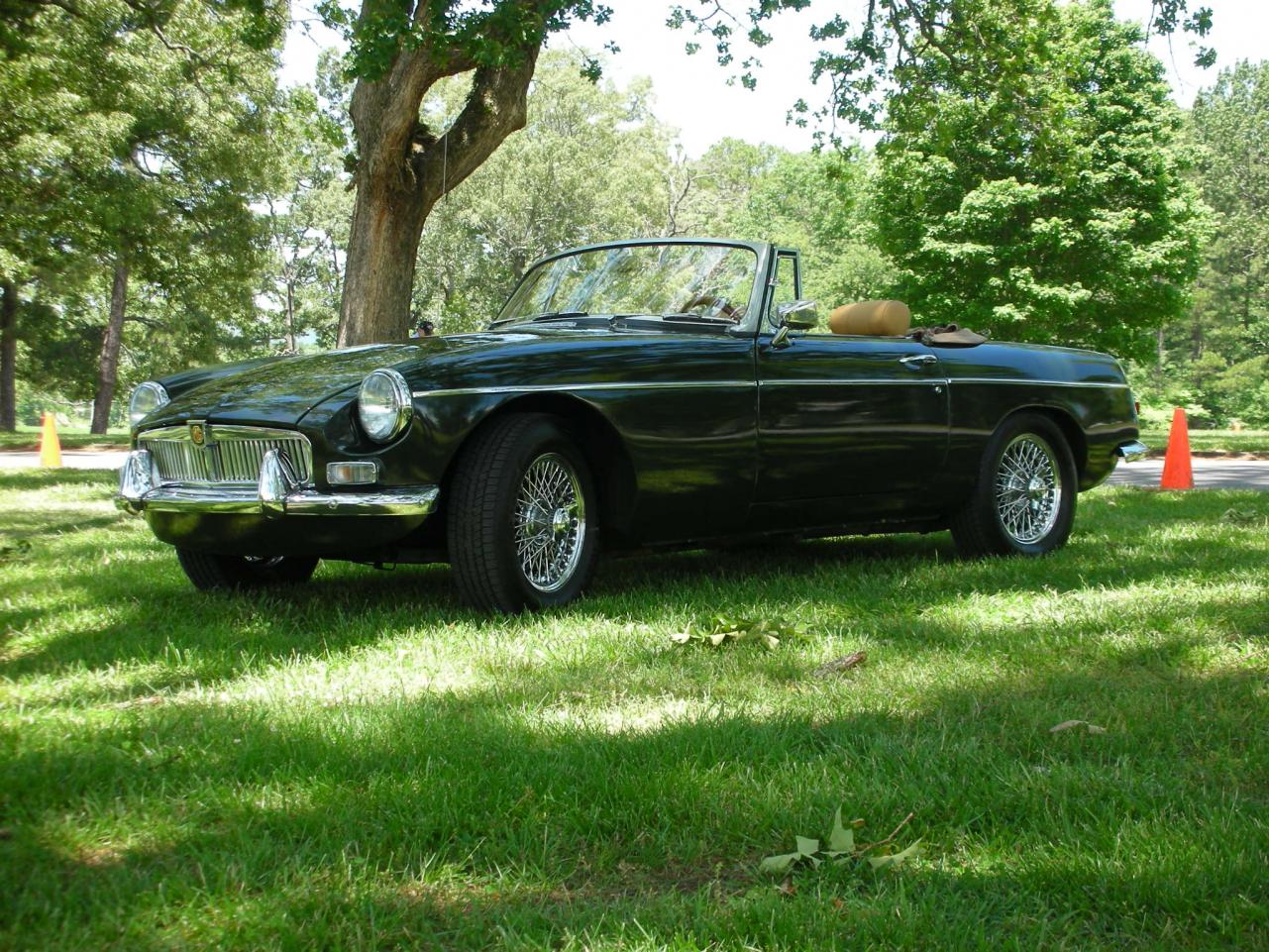

I'd go with some new chrome Dayton tubless wire wheels. It's great to be able to put standard tires on without needing tubes. They ride nice and smooth since they are factory trued before they seal the spokes. I have them on my MGB (which is painted a Healey green actually):
