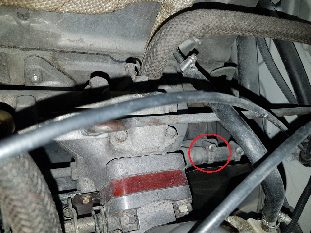

Yes!  Just plug the thermostat housing and the hose coming off the hardline at the rear for a quick test.  If it helps with your problem then go back and make it look good.
Like I showed in post #202,
Pull these hoses off and stick a bolt inside them and retighten the clamp for a temporary test.  Drive the car and see if it helps, won't cost you a dime and you should be able to do it in ten minutes.  Then take the metal fuel rail off and replace with rubber fuel line like Jeff G said a month or two ago.
This is your motor so there shouldn't be any confusion.
Front hose coming off thermostat housing,
Rear hose coming off the hardline that runs behind the head,

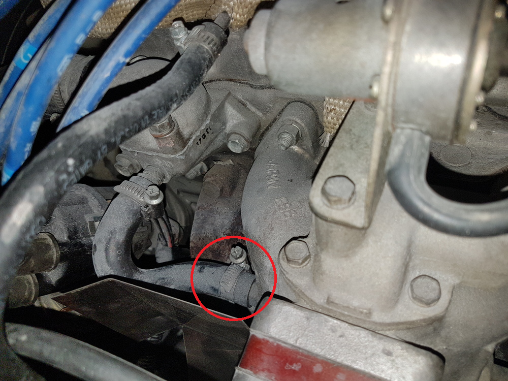

On ‎12‎/‎01‎/‎2016 at 1:18 PM, siteunseen said:
Yes.  I would do both if it were mine and I was having problems with percolation.  Take one of the old fittings to the parts supply and match it up.  I used brass NPT 1/8 I think but don't really remember, take the old ones for comparison.
EDIT: Looking back I see I used the old threaded plugs off the balance tube but you can get brass plugs at any hardware store.
I started on the passenger's side, that hose pulls from the rear intake.  Plugging it at the water pump eliminates the metal tube running behind the head to the rear intake, threaded plug goes into the intake.  Picture #2
Then plug the front intake,
Then plug the thermostat housing,
Okay! Im doing this on Friday! i am blocking it with brass plugs. Hope this keeps the heat out of those carbs and eliminates the rpm oscilations at idle and tendency to stall during traffics and traffic lights.
